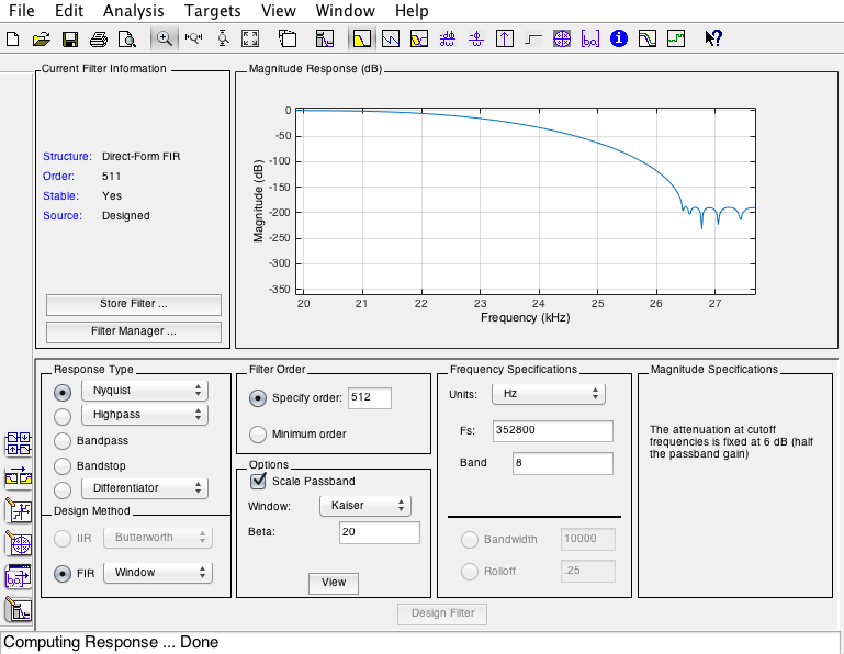

Paul,
what software do you use to generate those beautiful 40-digit coefficients?
MATLAB's filter and design analysis tool. It has a rather nice menu option to export filter co-efficients to text file.
I'd bought a licence in a moment of weakness, and initially had buyers remorse but the more I use it, the more I appreciate the filter design tools.
Octave is pretty good, but nowhere near as user-friendly.
