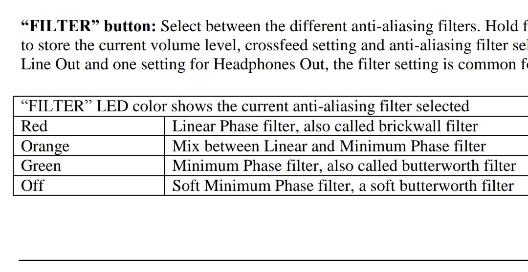

I have a Soekris 1421 here that a friend loaded the filters.
Want to make sure I understand what light is associated with the LED light colors.
OFF - 4k-Kaiser linear phase filter
Red - 4K-Nyquist. Linear phase filter
Orange (dim red?) - Quasi-NOS
Green - NOS
Do these associate in this order?
Alex
No.
F4 Kaiser - led red
F5 Nyquist led orange
F6 Quasi-NOS led green
F7 NOS led off

Is there any explanation somewhere on how the filter system actually works? I see from the terminal interface that you can switch between filter modes (linear, soft, etc), but how does that correspond to the broad list of filters that show up when you run "filters all" ?
If you are talking about selecting one of the four filters, the syntax in uManager is:
set filter = soft
exit
Each of the four filters are named linear | mixed | minimum | soft
So in the command line above you can substitute soft with either one of the four filter names.
Alternatively you can select filters when connected to the dam1021 while not in the uManager by simply pressing the function keys F4, F5, F6 or F7 (I believe?)
