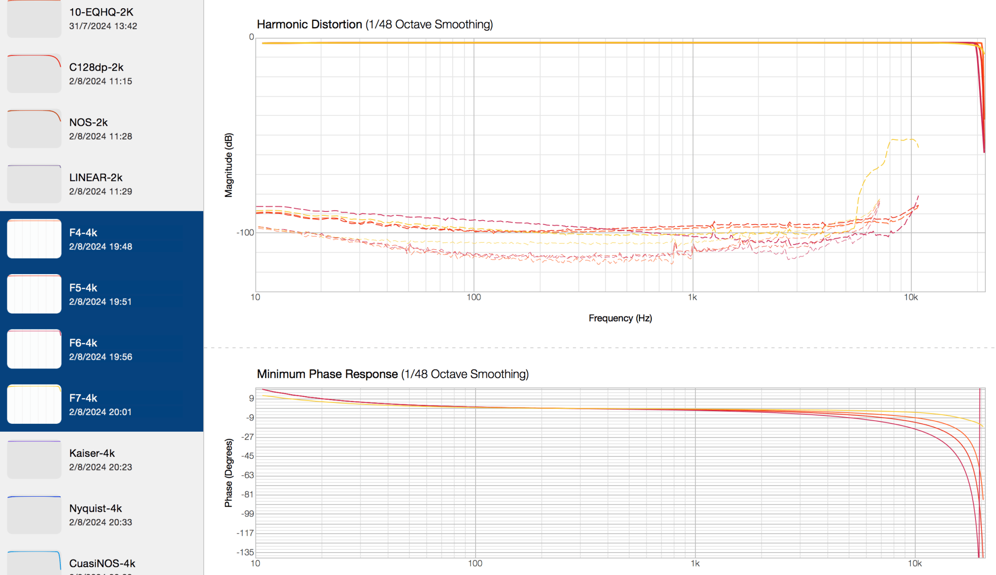

I will work with filters normalized to 1 and with gains all set to 0.8, just like at 352800 Hz. To avoid any mistakes, I will ensure with measurements that there is no distortion at 0 dB. I will also measure the manufacturer's 2K and 4K filters to compare them with mine and ensure everything is done correctly.

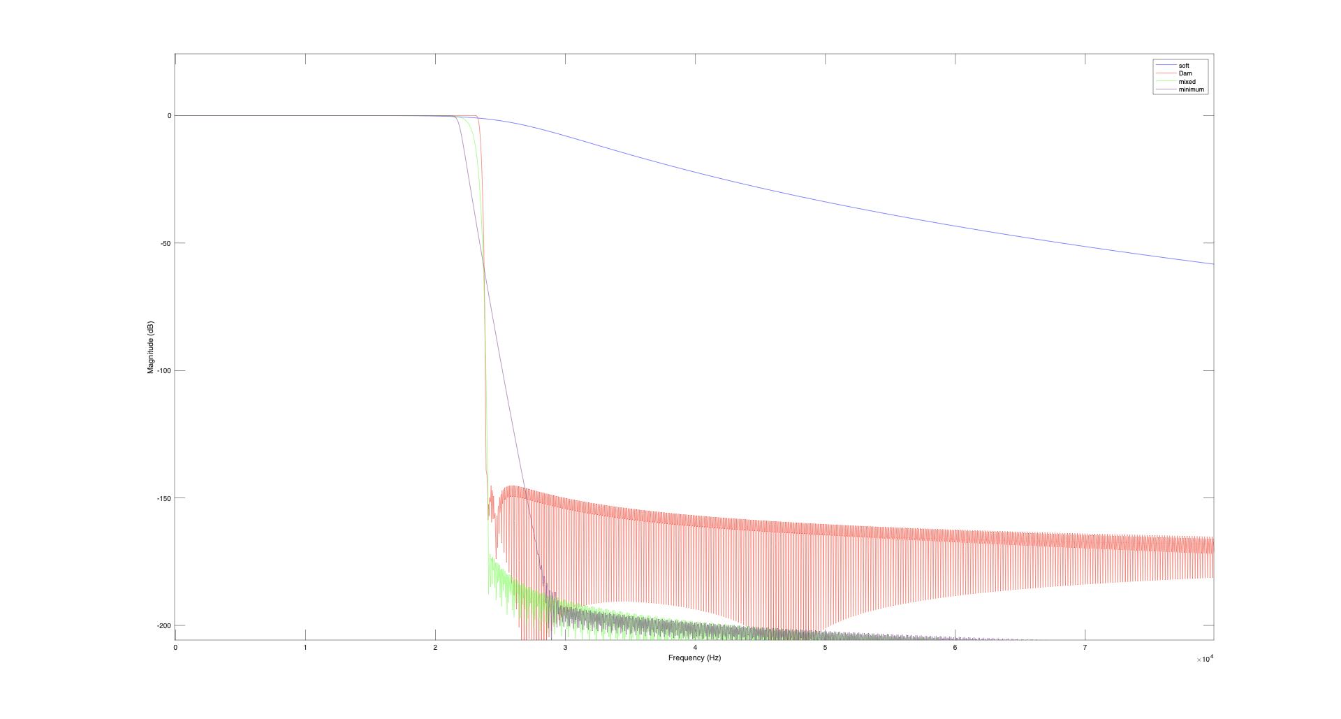

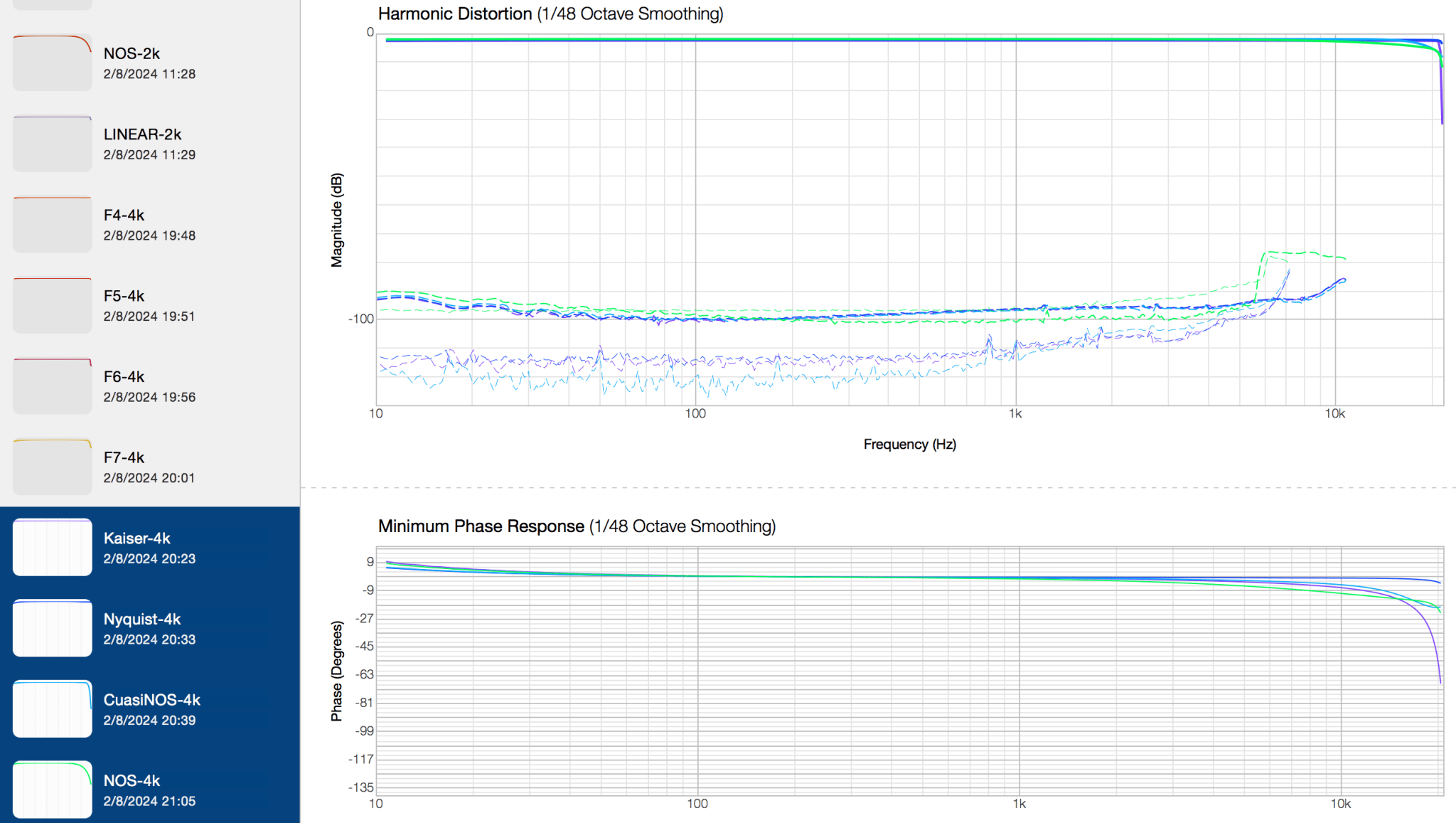

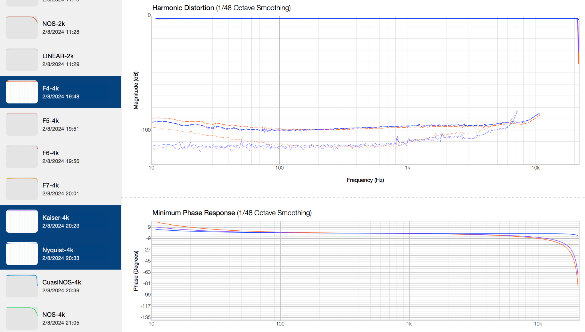

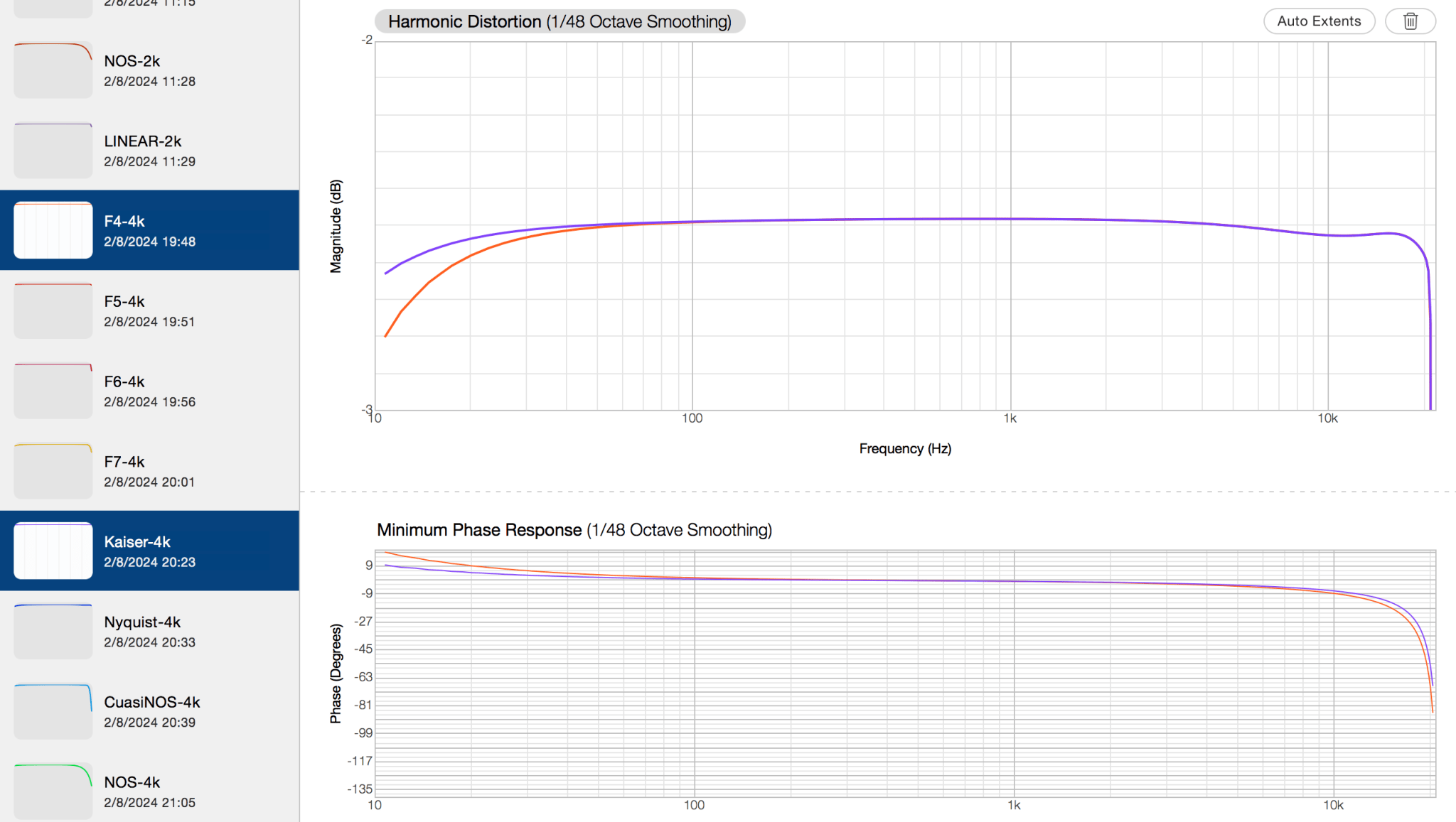

This is a set of 4k filters.
- 4k-Kaiser linear phase filter that improves on the manufacturer's version.Has less ringing in the passband, attenuates more in the stopband 170 dB, and has a higher cutoff frequency. It also has better bass response and a narrower impulse response. Best fase response.
- 4K-Nyquist. Linear pase filter improves the manufacturer´s versión. Has less ringing in the passband. Attenuates more in the stopband 170 dB. Has a higher cutoff frequency plaint to 22 kHz. It also has better bass response and a narrower impulse response. The Best fase response to 22 kHz. At the sampling point, it is exactly the value of the sample. The rest of the points are interpolated by 4k. This is the one with the least theoretical distortion.
- Quasi-NOS is a very short impulse with an impulse response almost as good as NOS but with a flatter frequency response. It's very similar to the manufacturer's F7 but shows less distortion.
- NOS. It makes the DAM behave exactly like a NOS DAC.
An example of a Matlab program on how I created them, in case anyone is interested in developing other filters. I had to develop graphs to experiment with values and compare the improvements with those from the manufacturer. I also created filters for 88, 96, 176, 192, and the F2 filter, but I’m not including them here as they are similar. I also read the manufacturer's coefficients to compare them with mine on the same graph, but I’m not including those here either
