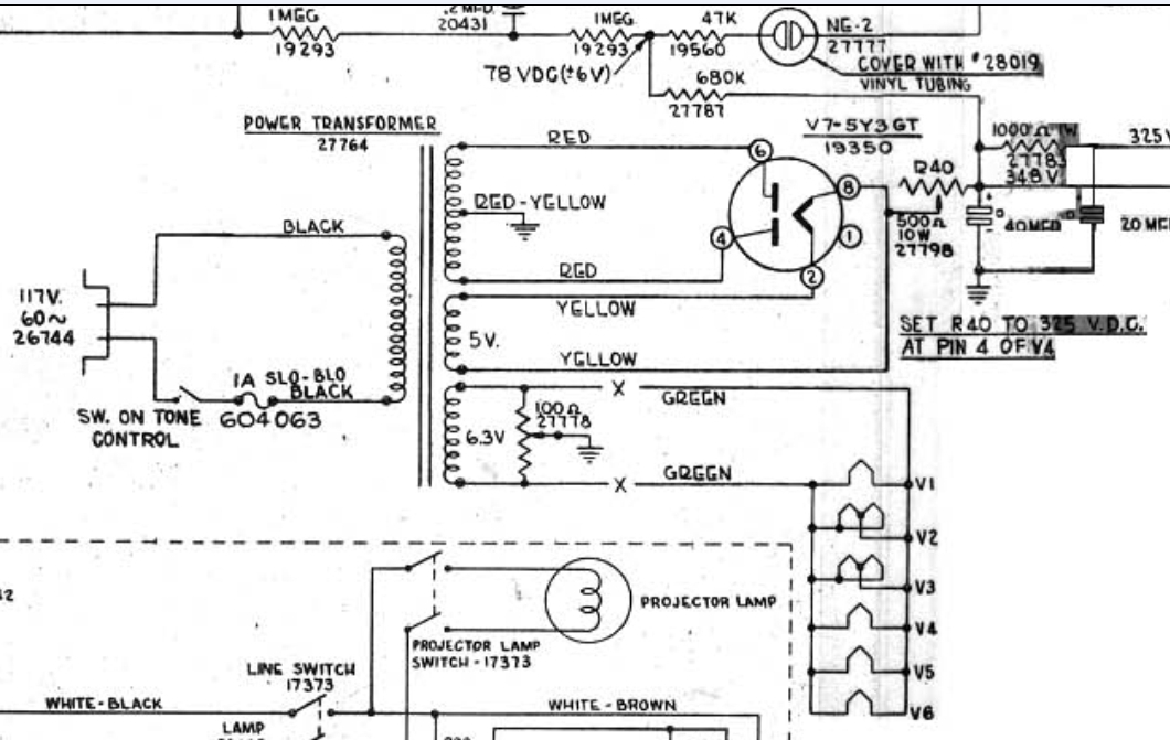

Well it was working, but the filter caps needed to be replaced and when my clumsy fingers started poking around things were broken. Real estate is really cramped and long story short, the amp was gutted. There was just so much crap crammed in there it seemed easier to just gut the thing and start over. I wish I had been careful and left the main structure of the power section intact but I didn't so here I am trying to figure out what goes where. It looks as if there are two red wires, two yellow, a green, maybe a white (yellowed badly), a white with green dots, and two sets of secondaries... One set of green with yellow dots and one set of brown.
Filmosound 385 Power Transformer info.
It looks as if there are: 😛
two red wires - high tension for rectifier tube socket pins 6 and 4
two yellow - rectifier tube socket pins 2 and 8 for tube heater circuit which is a typical 5 volt system
two green - 6.3vac for heater circuit which is pretty stout as there are a ton of tubes to heat up!!
the brown ones are probably the 110volt wires for hot/neutral maybe the other ones are for 240vac?😱
enclosed is a picture of a filmosound 385 power section...good luck...also I have one and will delve into this soon - more to follow!...johnne in seattle
