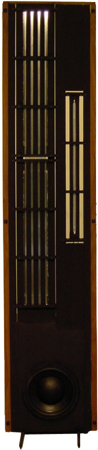

Just thinking to make new bassribbons for my Duettas, anyone know what should the right thickness be for Kapton?
Hi Red,
FROM WHAT I HAVE READ, and owning 4 Apogee speakers, Apogee purchased 7.6u Kapton with a "thick " aluminum over the entire film. Thinner 2.5um - 3.8um Kaptour would be superior. Apogee manufacturing then used a simple straight edge and cutting tool that "lifted and cut out" several horizontal slivers to create one continuous serpentine BASS resistor on the kapton fillm. At this point manufacturing "corrugated" the full panel to add horizontal rigity to the AL ribbon. The Full Range has a 2ohm bass panel serpentine resistor. An Eagle 7B amp can put 1400 watts into this 2 ohm panel with a 120 Hz bridged power supply.... ultimate deeeeep Bass from a 7' x 2' woofer area.
Jason Bloom at Apogee was a genius. He understood the need to reduce panel resonance, and understood that only true steel springs could provide constant force over decades of use. The Apogee Kapton Bass films were clamped into a 2D wooden frame that used multiple adjustable steel springs as the "surround". The trapozial shape of the bass panel and variable spring tuning removed any single resonance.
