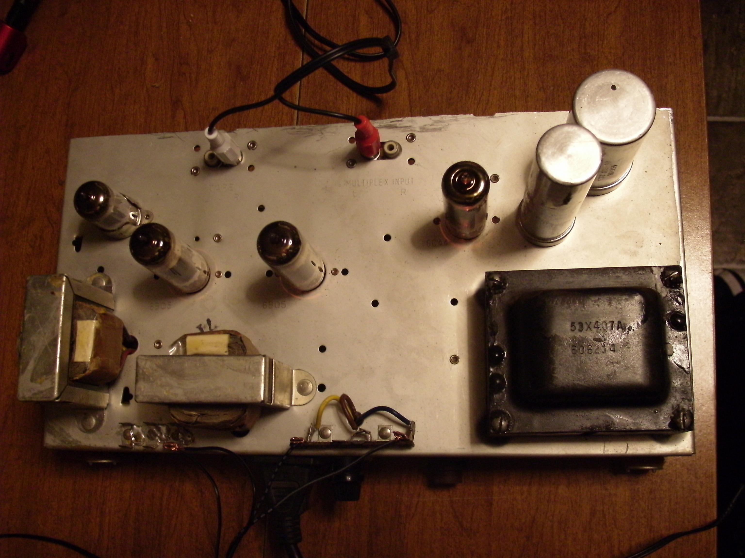

i salvaged this amp out of an old radio i pulled from the trash, finally got it fired up properly, it sounds amazing now after running an hour, the low end is faint under 80hz.
any thing i can do to improve the low end besides new OT's ?
i dont have a budget to work with, but i do have many vintage radio parts on available.

I'd certainly look at replacing the bypass capacitor between the 6BQ5s (black electrolytic). Probably the two other coupling capacitors too.
However, with unknown OTs you are in the lap of the gods as to how far down they will reach.
Another thing to consider is replacing the PS filter caps. They are AL Electrolytic and have probably lossed considerable capacitance over time. That may effect your low end, and is worth replacing even if it isn't.

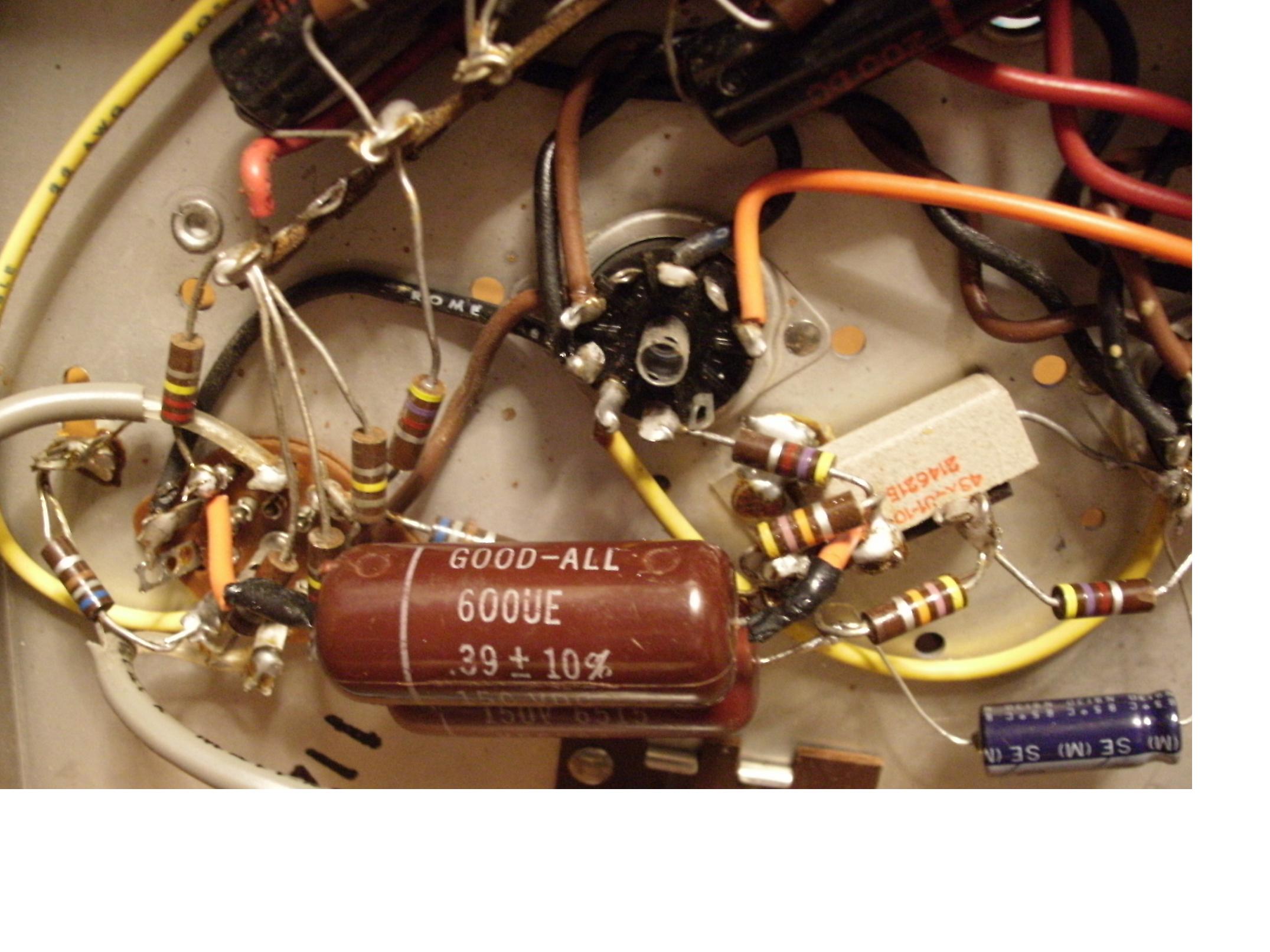

well very sweet this amp has come alive, i replaced the caps that rota and bob mentioned, and thanks guys! nailed it!!!

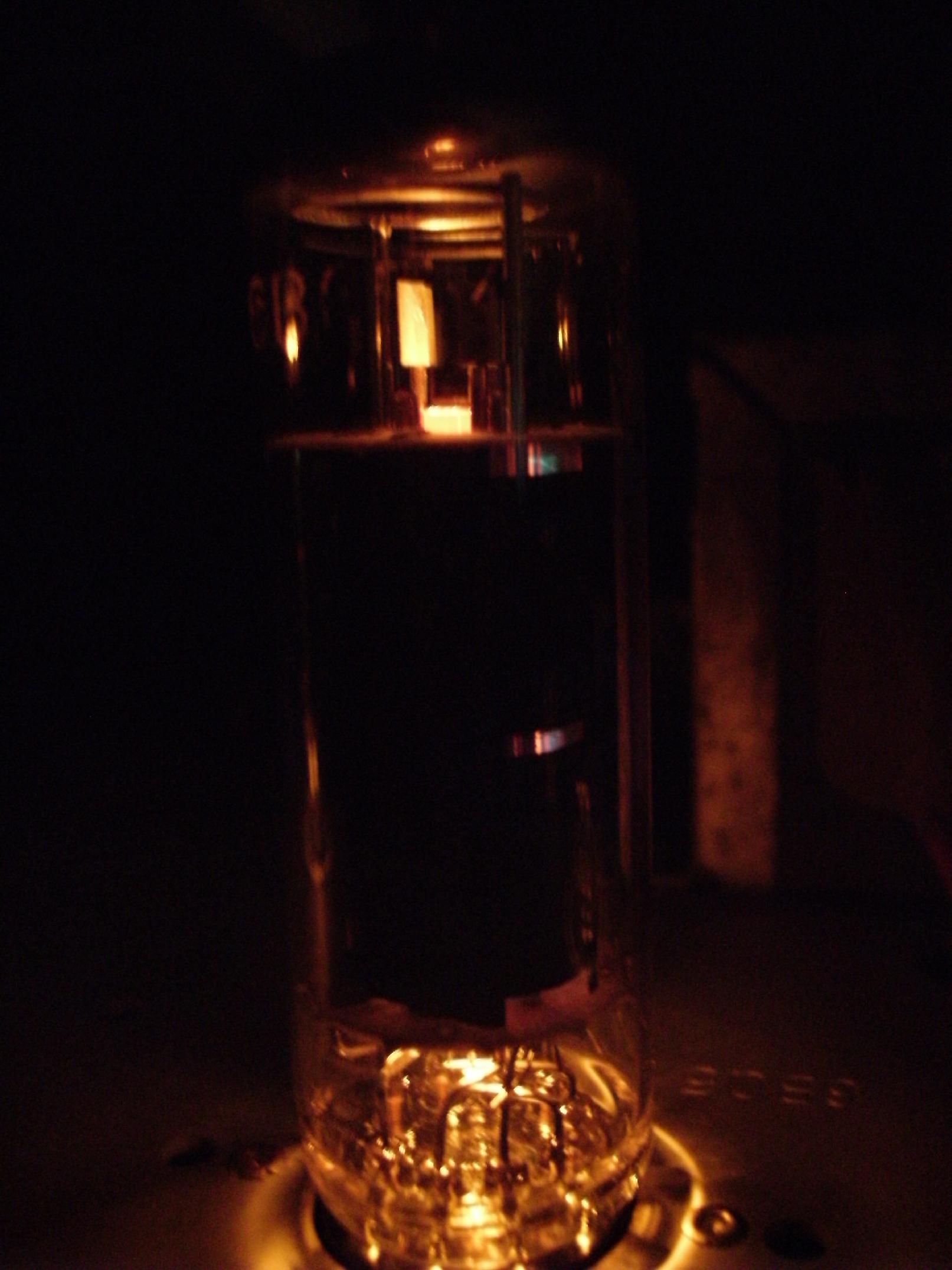

the amp was missing the low end, i decided to increase the impedance load on the output, to 4 ohm, then 2, and well the problem came to light, a 6bq5 started glowing red, witch showed me the caps were the culprit.
anyways i replaced the two 1mfd (color banded) with two nice fat .39 goodalls, and that black coupling cap with a new one from radioshack, and boom..
the low end is very responsive and deep now, the highs light right up when the volume is at proper max, the amp also showed much more dynamics after the new caps installed.

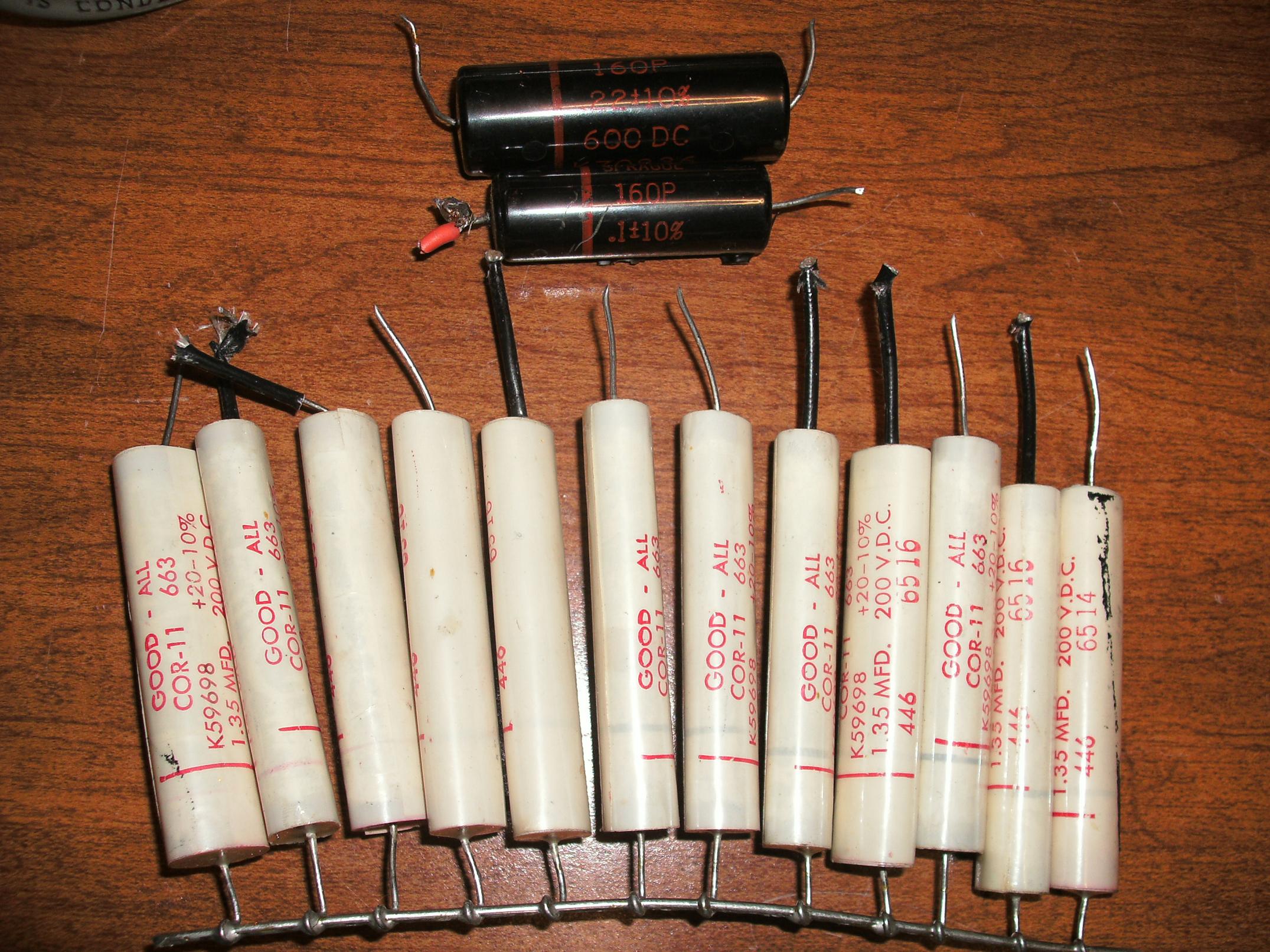

i pulled these goodall caps out of an organ, pictured below,
are the long white ones be any better than the ones i installed? a guess?
long white 200vdc, the ones i installed are 150vdc

Caps you can afford always sound better than ones you can't afford.
If you got em, just gotta try 'em.
If you have extra parts, maybe you could swap extra parts with someone who has extra Russian PIOs? Can't beat 'em for their cost.
