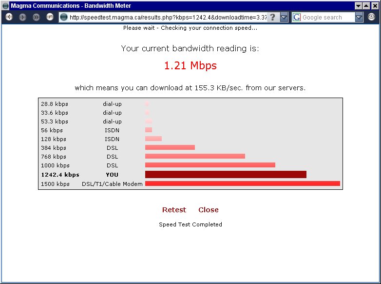

I shouldn't have to mod the timing then, 160kByte/sec is exactly my transfer rate.
Size of files is never an issue, it's a quantity of pesky little files 😉

That is an above average speed!
Where I can run into trouble
is , of course, when browsing/downloading from some Asian countries.
Because, it does not matter if I can download with 381 kByte/sec
if those websites, can Upload to my PC
with only 50-75kByte/sec. ( ~0.50 MBits/sec )
It is always the slower side, that sets The LIMIT.
And 50kByte/s was the Download SPEED I got when testing against KOREA.
