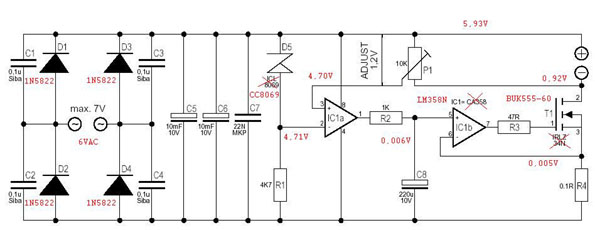

Why not build your own?
pdf
http://home.quicknet.nl/qn/prive/susan.soeters/TechGraphix/PDF/Electronisch/FilamentSupply.pdf
or if you don't have pdf check out the attached jpg.
This is one Kees Soeters built for his 27 driver tube.
Hi all,
I built one for my 300B power tube amp but something is wrong. In my first attempt I blow up some 1N5822 diodes. After that I replaced all diodes by a bridge KBU 6G (6 A) but it heat a lot (I also placed a small heatsink but the problem is not solved). (see att. schematic with some measures I have done and add this one I=1,13 A after the bridge)
Any comments or suggestions are very welcome (and sorry my English).
Katapum
