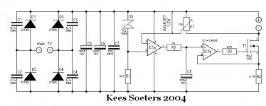

Why not build your own?
pdf
http://home.quicknet.nl/qn/prive/susan.soeters/TechGraphix/PDF/Electronisch/FilamentSupply.pdf
or if you don't have pdf check out the attached jpg.
This is one Kees Soeters built for his 27 driver tube.

How well would Kees work for preamp dht duty?

You got that right, but in some cases still less cumbersome than trying to put together something that'll work as good. I've never tried Guido's supply modules so I can't speak for them. I ended up with batteries because I'm too lazy to investigate other options - and once chargers and relay control unit is built it's really not that much hustle at least not with my tubes - but they don't draw an amp like the '26 either..
