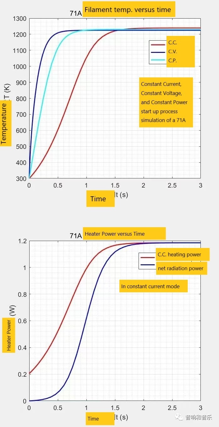

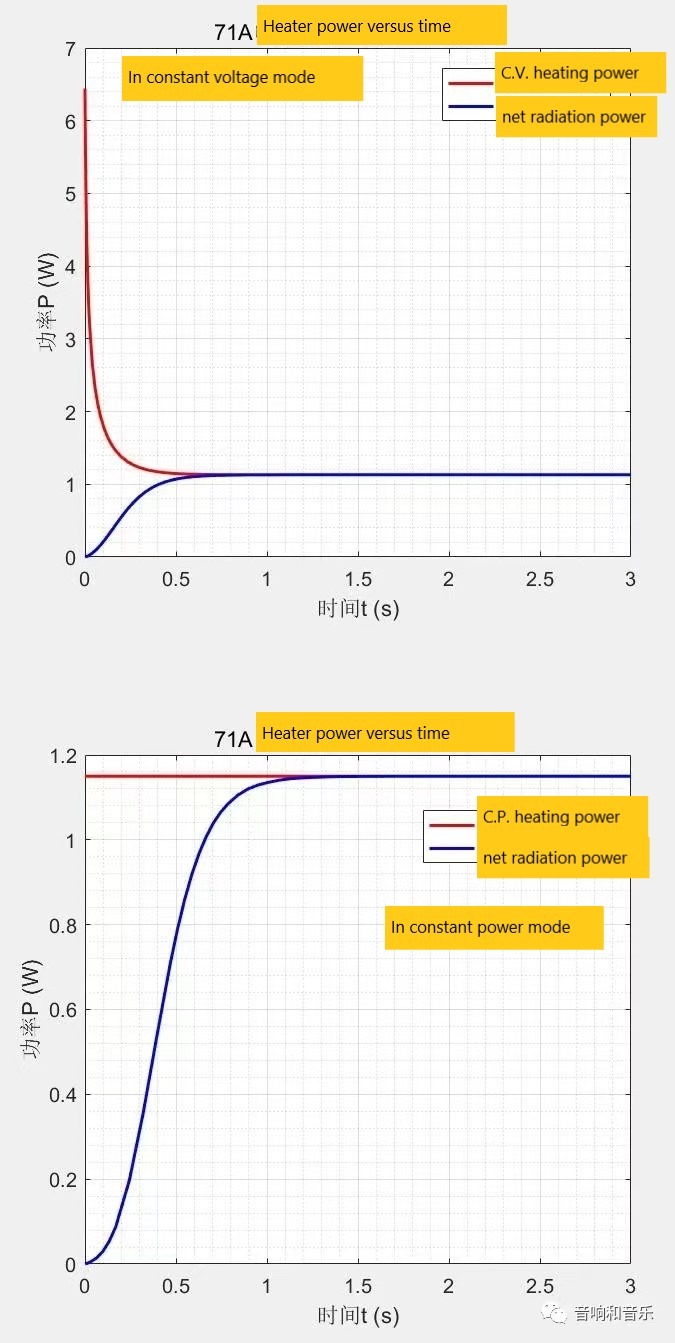

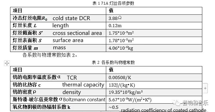

My friend has done similar research by modeling the filament in Matlab, and simulate the start up process of a 71A about one year ago.
Suppose the material of the wire is tungsten. Using the typical parameters of tungsten, we will get this.
The first section shows the filament temperature rising curve in different power modes. Constant Current, Constant Voltage and Constant Power are concerned. It's the warm up time in different modes.
The later sections show the heat balance process in different power modes. By simulating the heating power and net radiation power, we can understand why there's so much difference in warm up time.
Since the parameters used in the simulation were based on pure tungsten and have been greatly simplified, it's for discussion only.

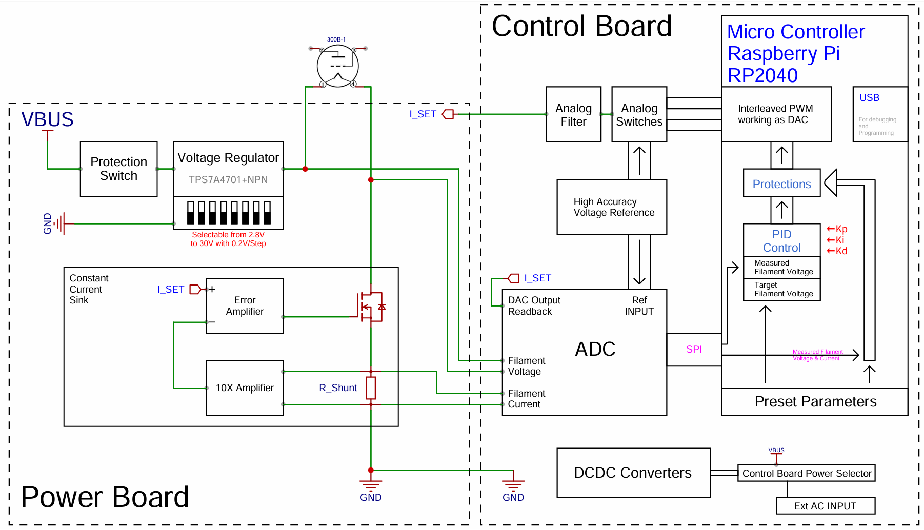

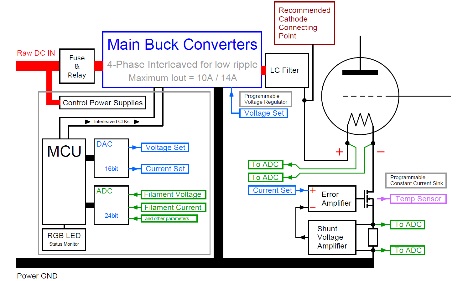

Here's the block diagram for the filament constant current source module with automatic adjustment.
The main purpose of building this is to provide a new DHT filament solution which is more friendly to use.
Here're some advantages of this design.
No manual adjustment anymore. The MCU is in charge of adjusting current to maintain filament voltage. Due to the thermal characteristics of filament material, achieving accurate filament voltage by adjusting current is time-consuming. Watching filament voltage gradually changing for minutes after slightly turned the potentiometer is boring but essential. Just let the MCU watching and turning. Now you can plug in tubes and directly turn on the amplifier to listen.
High accuracy. The ADC and DAC section are designed to have high accuracy. The steady filament voltage can be kept within ±0.1% from target value, which can maximize the life span of every power DHT.
Low noise, high impedance with high stability. These are characteristics for good sounding.
Visualized voltage through a RGB LED. The filament voltage status is shown by a single LED. Gradient color from bule to green then to red indicating filament voltage status. A section of optical fiber can be used to lead the light to the front panel of the amplifier.

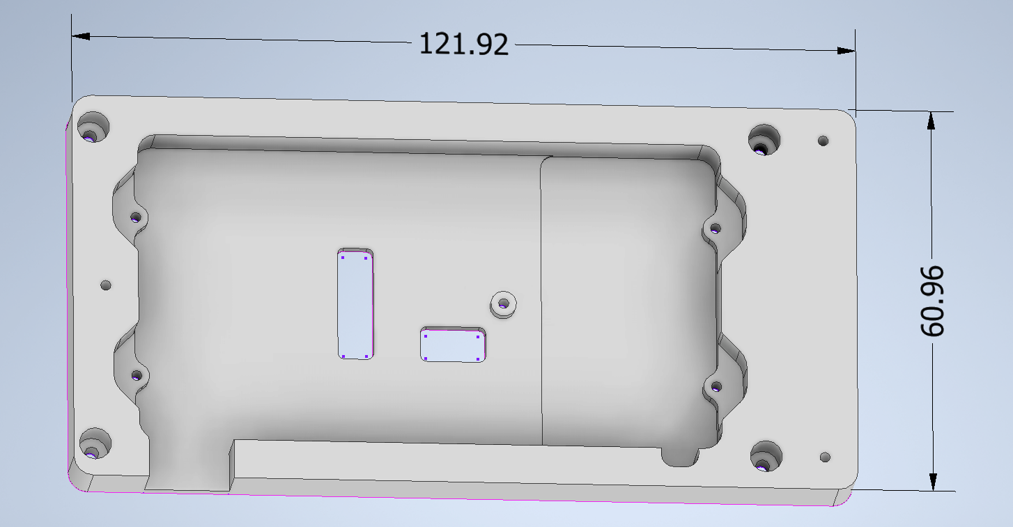

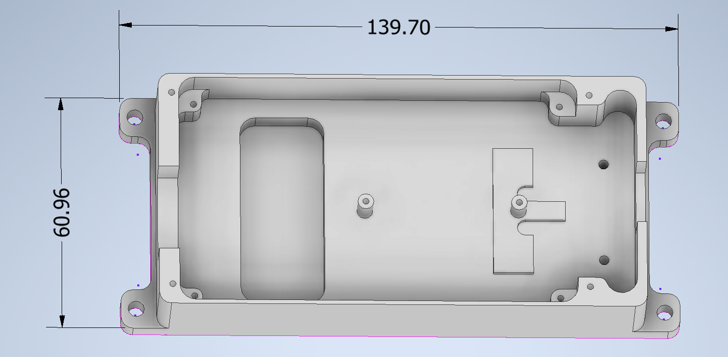

Delicate aluminium cases. Here're 3D models of the new cases. Cover board isn't shown. The overall dimension when cases are assembled is 140*61*38mm.
If you are familiar with Arduino. I can send the program to everyone who buy this. There'll be more advantages and fun.
Highly configurable. There's only one substance difference between modules for different kind of tubes. That's the shunt resistor value, which determines the maximum current and minimum current adjusting step. All other parameters can be configured either by program or switches on power board. For example, a pair for 300Bs can be easily turned to work with 45, 801A, PX4, PX25, etc. Any kind of tube whose filament current is less than 2.4A and filament voltage less than 25V can be adapted by changing configurable parameters and switches. High current tubes like 845,211,805 and GM-70 can share the same value of shunt resistor, so that simple re-programming and changing of code switch will make it work with another kind of tubes. Higher current version can work with low current tubes, so long as the current adjusting LSB meets the need of achieving certain voltage. Protection limitations are configurable too. Tighter limit can be set to protect precious tubes. The expected maximum current of the present module is about 8A, which is limited by TPS7A4701 + NPN. NJW3281 is the largest BJT with enough HFE that I can find in TO-247. Larger cases will be developed if TO-264 transistors are needed.
Further functions can be developed based on the present hardware. For example, faster start up routine can be achieved by setting a constant voltage start up with higher current limitations. Filament resistance ratio tracking and researching between hot tubes and cold ones can be carried.

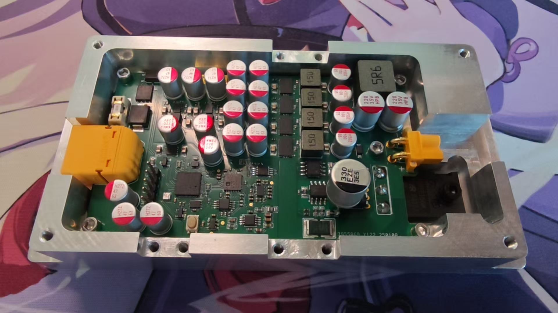

Debug can be done by USB to Serial intergrated inside RP2040. If the module works irregular, brief diagnosis can be done by writing program with serial communication enabled. The measured data should be able to tell us some failure possibilities.

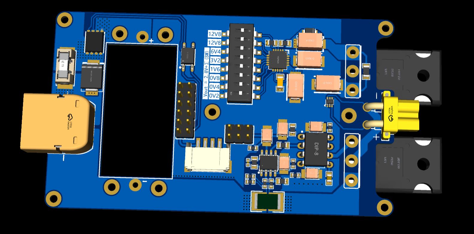

The module needs two supplies.
One is Raw DC that powers the filament.
The other is Auxiliary AC or DC that powers the control circuit.
The optimum voltage drop of the voltage regulator and CCS is about 4V. It means that Raw DC should be 4V higher than tube heater voltage. Extra voltage drop is needed because Raw DC is variable due to changed AC line input. Ripples from Raw DC should also be considered.
I can build boards with rectifiers and main capacitors as required.
The control board can share the same Raw DC when it's higher than 12V. In this case, auxiliary AC or DC is not needed. If lower interference is preferred or Raw DC is lower than 12V, a 11-20V AC, or 13-32V DC should be connected to the control board for normal operation.
XT60 socket is used for Raw DC input, and XT30 is used for output.

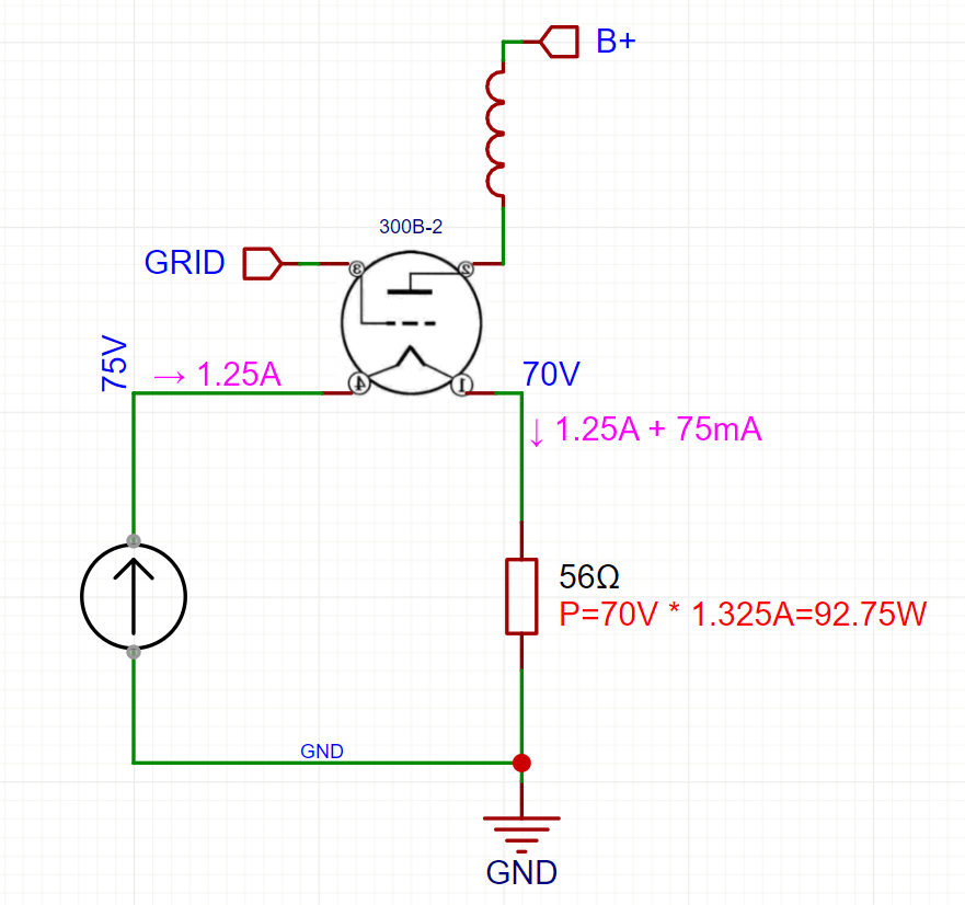

Hi KoitoYuu,
Thanks so much for your clarification. I mis-understood your design. I believe your circuit is kind of filament bias.
The 300B filament current is 1.2A and the cathode voltage is approx 70V. The amount of heat generated from the MOSFET and Rshunt would be 84 watts. Is this correct?
Let me show you a simplified schematic of filament bias.
I've tested some kind of 300Bs. All of them have a filament current ratings higher than 1.2A.
The CCS using here needs an output capability of 75V 1.25A, which is far beyond the capability of my current design.
The heat dissipates mostly on the resistor. The power MOSFET inside CCS only has to deal with minimum voltage drop and headroom for AC input variation.
You can replace the resistor with a Shunt Voltage Regulator for a lower cathode to ground impedance.
Such a high power dissipation on the resistors makes it unrealistic to use filament bias with power DHTs, not to mention larger ones like 845 or 211.

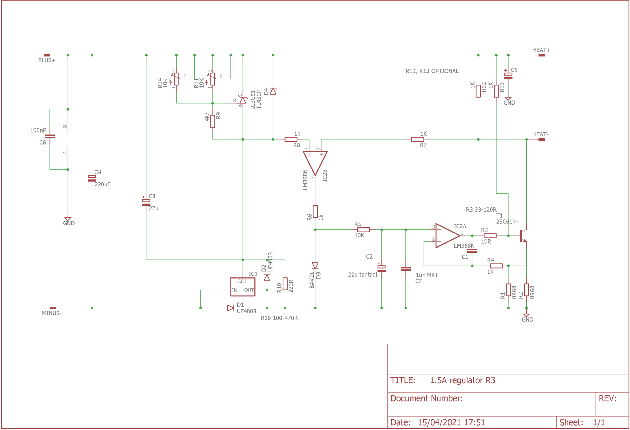

Very nice implementation.

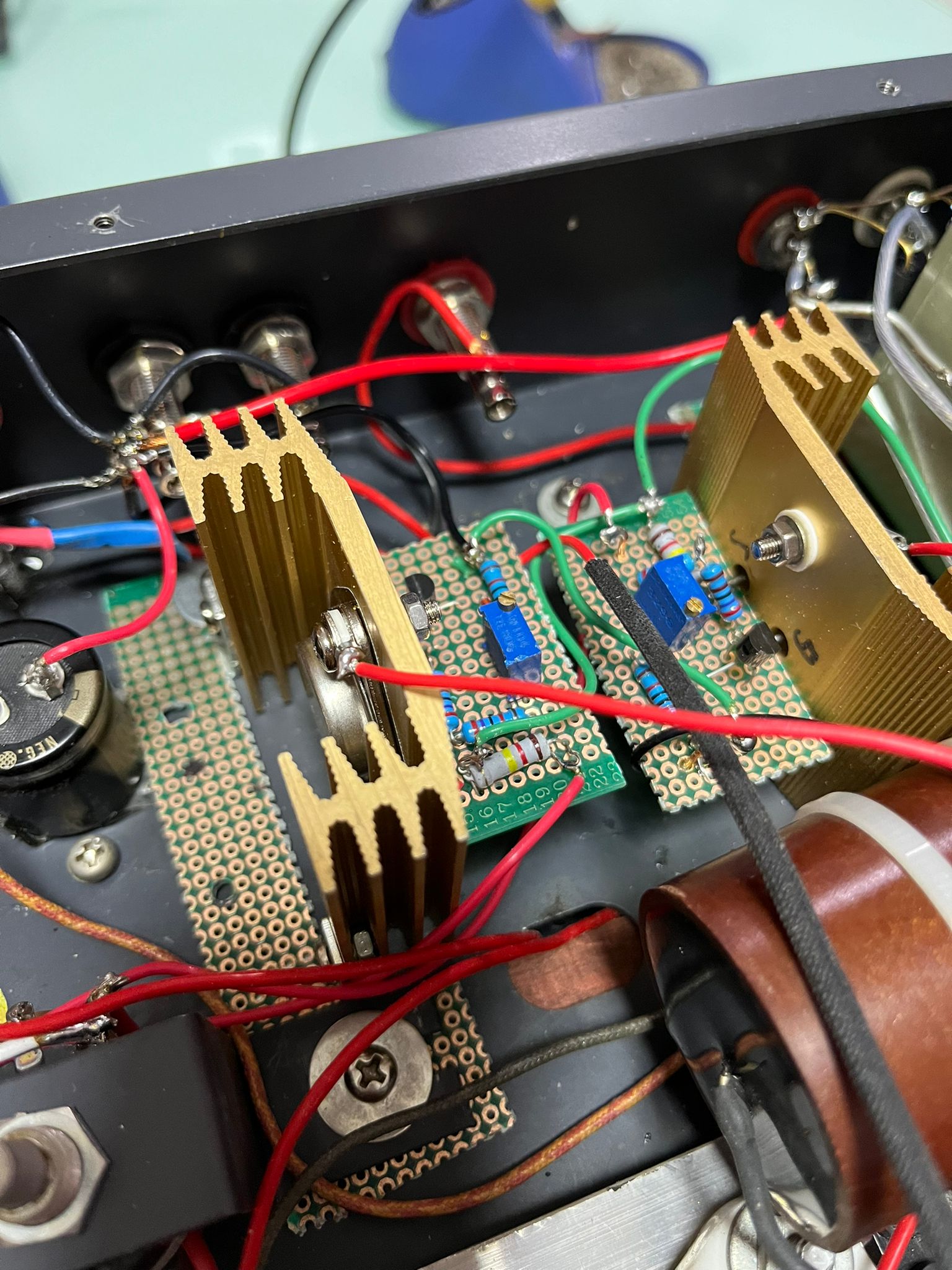

I have been working on automatic adjustment current sources too. This is a implementation of the tentlabs approach.
its got slow start, and a LM337 preregulator that tracks the TL431 reference, hence the voltage over the CCS is always 1.25V
The smartest thing in this schematic is the diode clamping of the drive voltage, by choosing the ccs sense resistors appropriately it becomes short circuit proof.
Enjoy
It seems R5 and C2 are used to filter the AC voltage caused by signal current. D3 is a limitation of maximum current. It limits the current within 0.7V/0.68Ω/2≈2A. That's a concise solution. Thanks your sharing. I guess there's slight voltage overshooting when starting.
So, how does it sounds😏

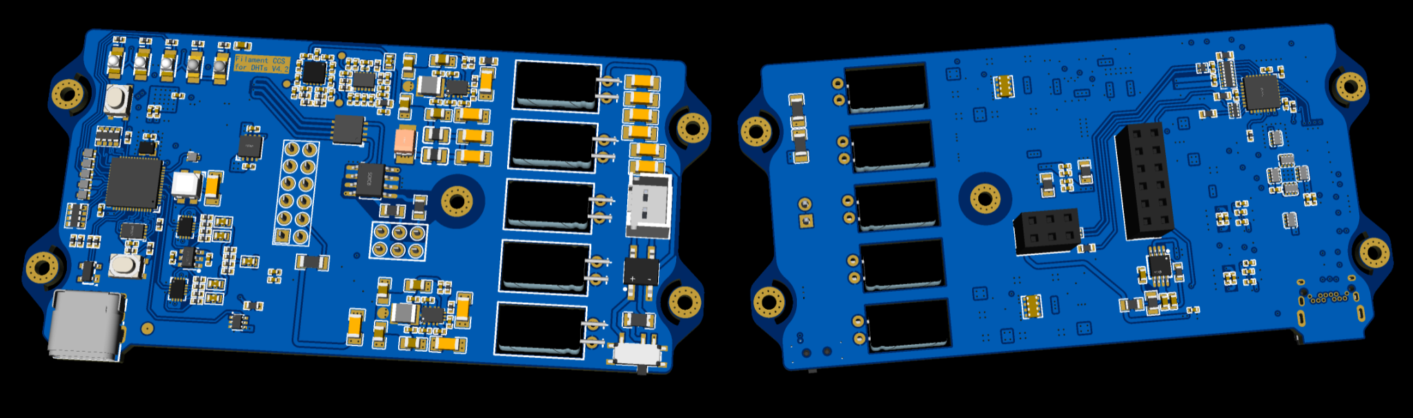

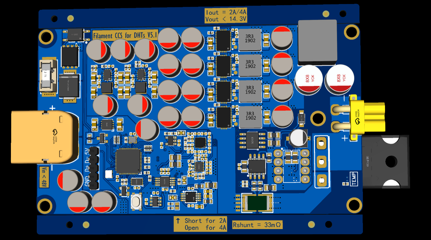

I'm working on the V5.1 recently. With some major changes comparing to prevoius versions.
Here's the block diagram of V5.1 and a sample board of V5.0. The V5.0 has a small bug which cause a voltage spike appearing when ADC start and stop.
Buck converters are included for better flexibility. Now you can use transformers with standard output voltage while keeping the chasis cool. For example, a transformer with a secondary of AC18V 3A, which means a Raw DC of about 23V, can be used driving 2A3, 300B, 845/211/805, etc. Any tube whose filament voltage lower than 15V and filament power lower than 40W can be used.
Four buck converters are connected in parallel for 4-Phase interleaved operation, which results in very low ripple and noise at the voltage regulator output. I'll test it and post the results later when V5.1 sample board arrived. The V5.0 has similar level of ripple and noise comparing with linear regulator versions regardless of the spike.
The output voltage of the DCDC is configurable within a specified range. For example from 5V to 14V, or from 13V to 24V.
5V for 2A3, 7V for 300B, 13V for 845, 211 and 805, 24V for GM70.
The current range can be changed by replacing Rshunt, so it can suits most of audio DHTs on order.

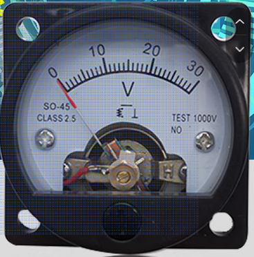

Now there is a project I for one would buy. A small board with a small LCD one could imbed into the chassis maybe with the lcd pointing out a window in the back. So a person can visually confirm that the voltage and current is ok occasionally. Then just go turn the trimmer a little as the tube ages over time. Then use an affordable Coleman regulator. A fully manual adjustment loop IOW. Might be a nice sister board for Rod's boards.
The previous versions used to have a LCD, but I found that the communication between MCU and LCD is extremely noisy. Running SPI over FPC providing a display at the front is not a good choice in a tube amplifier.
My current design is a single RGB LED, using the gradient color from blue to green to yellow, then to red to show the relative voltage comparing with settings. The LED is placed on the board, with a optical conductive fibre connected to the front panel.
I think somethink like this will be cheaper and easier to use. :spin:
A linear indicator is of course unsuitable for a power supply controlled by code, because a meter cannot signal the most vital information.
Wherever there is code, the user needs to know one thing above all else ---- Is it crashed?

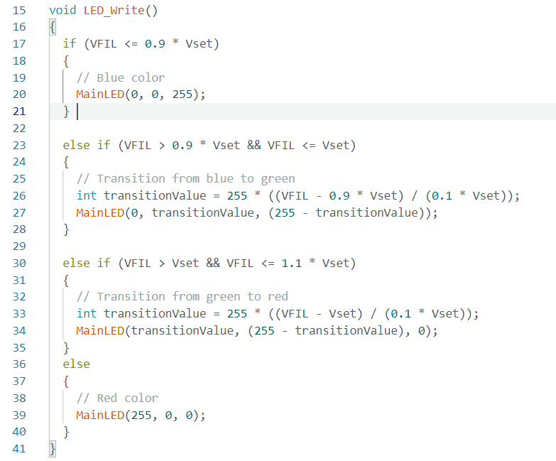

I think you misunderstand the function of my RGB LED.
Here's the code controlling the LED.
The color of the LED is adjusted according to the measured filament voltage (VFIL) and target filament voltage (Vset).
When VFIL < 0.9 * Vset, the LED is blue, which indicating that the filament hasn't reached the operating voltage.
When 0.9 * Vset < VFIL < 1.0 * Vset, the LED will transit from blue to green, which indicating that the filament reaches normal operation.
When 1.0 * Vset < VFIL < 1.1 * Vset, the LED will transit from green to red, telling users the filament is over voltage and it's time to turn off the amplifier for maintainance.
The color doesn't related to BLOD. It just shows a relative value of filament voltage.
I mean using the linear indicator with your module. Instead of developing a digital voltage and current meter with LCD screen working together with your 100% analog filament module.
