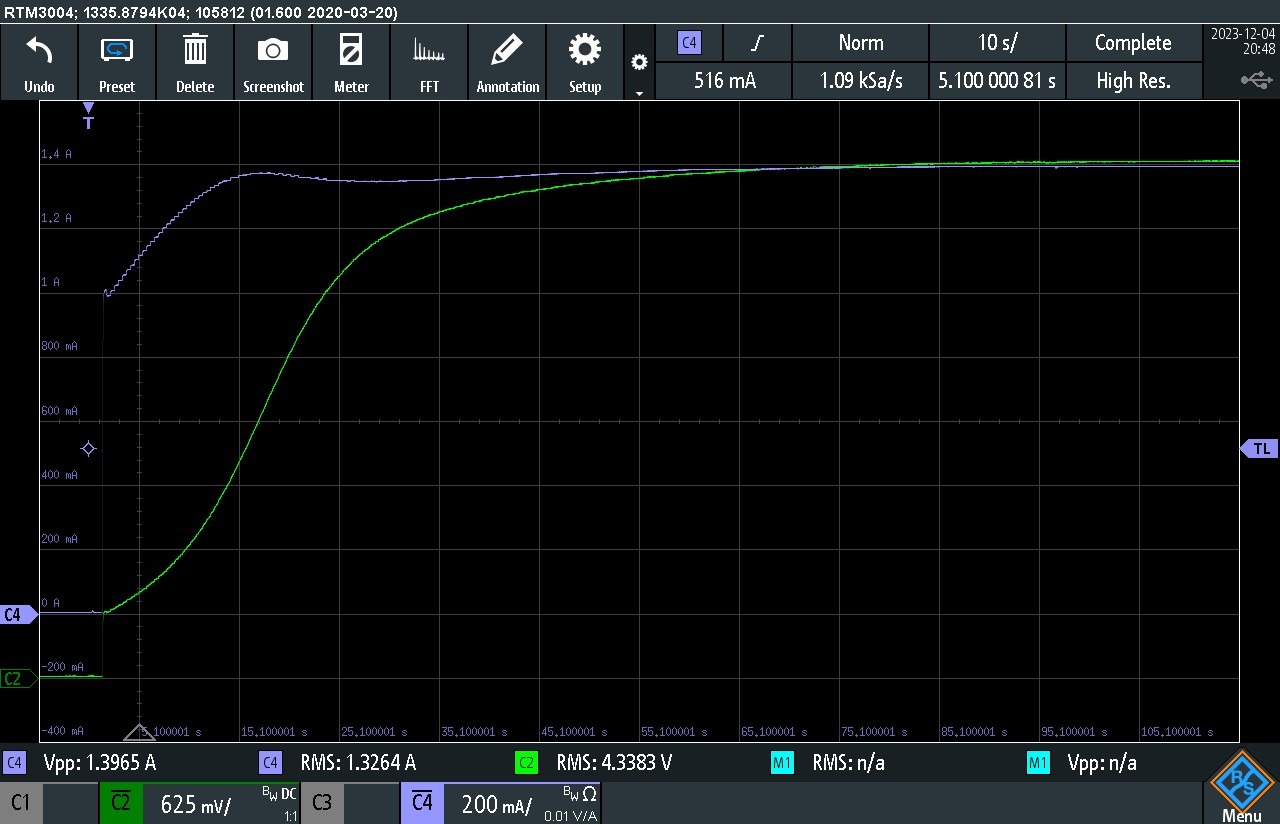

Filament CCS for DHTs with automatic adjustment
I'm working with this project for about 2 years and finally it's working without any compromise:smash:
Here's some pictures and test results.
I'll talk about it in detail if anyone has further interest.

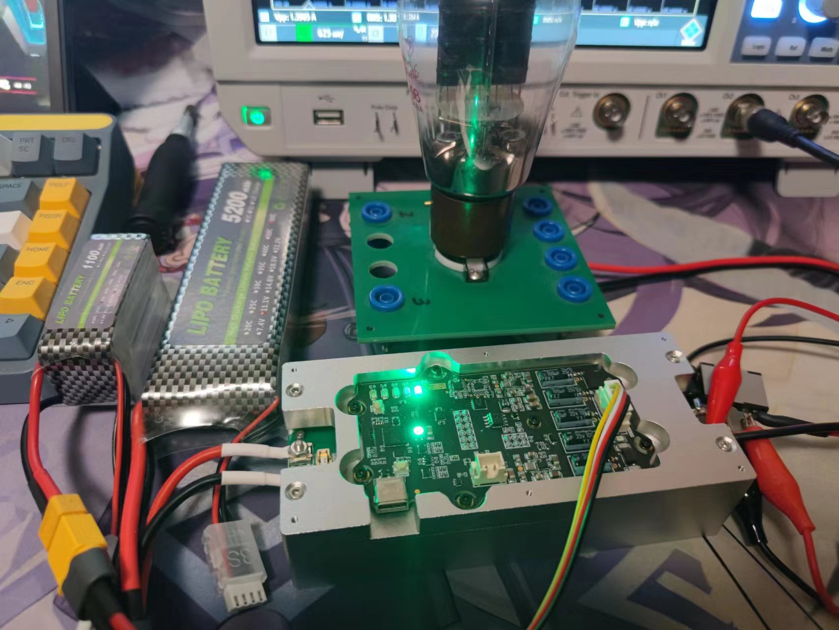

There's two PCBs in one set. One provides power for OPAMPs, measures the voltage and current, then sets the current. The other one has a voltage regulator and a controlled CCS.
This is the starting voltage curve when powering an 300B-98
Here's the noise when fully stabled. A 200KHz LPF is applied with Math functions of my osciliscope.
With Cosmos ADC, the measured noise goes lower to about 50μVrms.

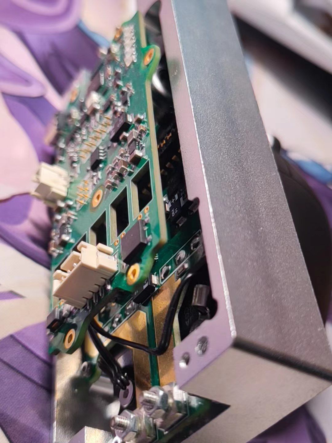

The total size of the case is 140*63.5*40mm.
They're designed to be stacked together.
The control board is on the top while the power board is placed at the bottom, with an aluminum case as a shield.
I'm using Pin Headers to connect the control board and the power board. Here's a picture without the case between the two PCBs. The headers are located near the center of the PCB so they're hard to see.

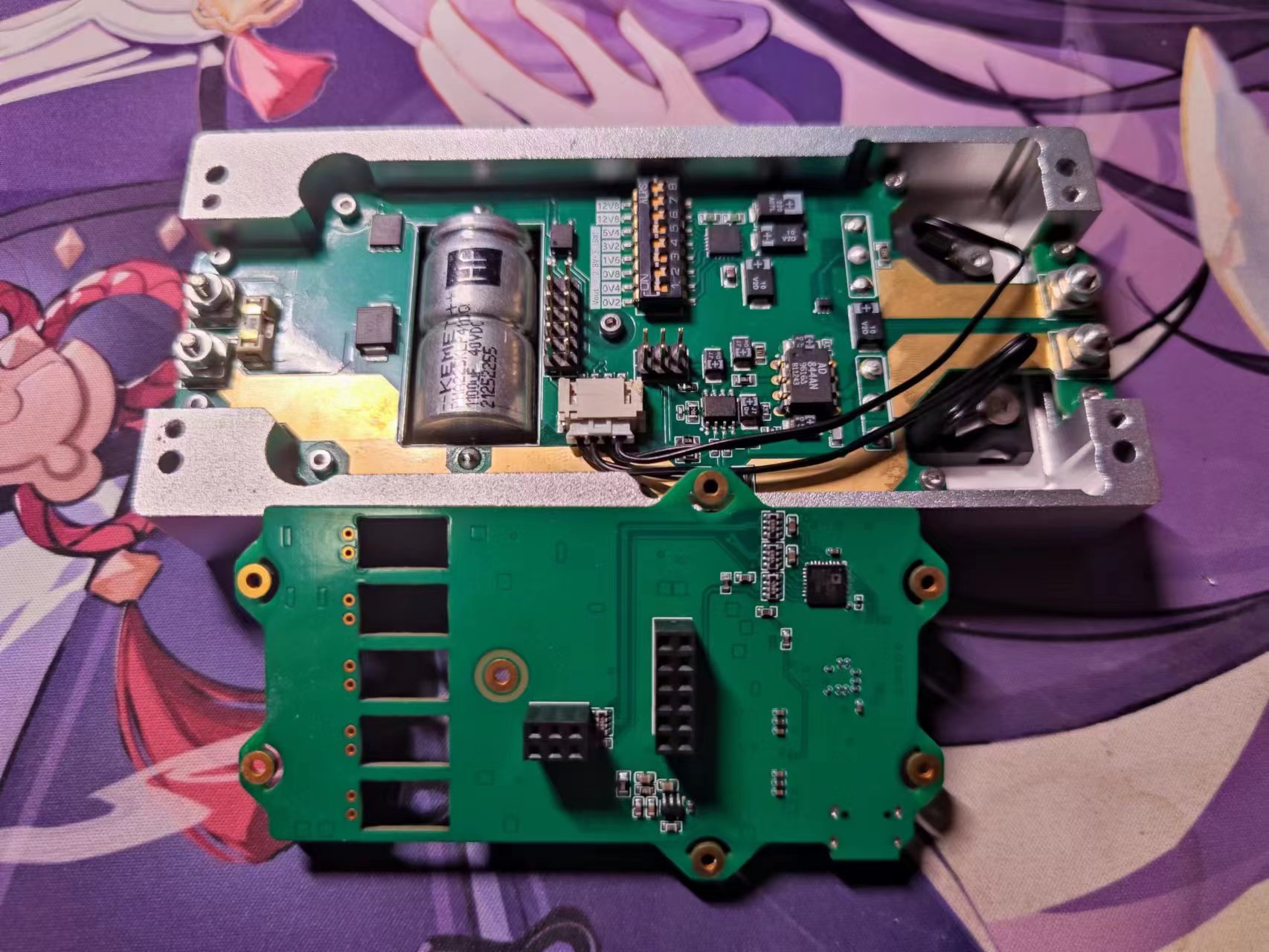

This is the bottom side of the control board. You can clearly see the connectors between boards here. And the main ADC is placed at the bottom side of the PCB.
Actually there's 3 PCBs in the first picture. The upper one is power board with control module covered, so I put another power board showing the internal structure of the power board itself.

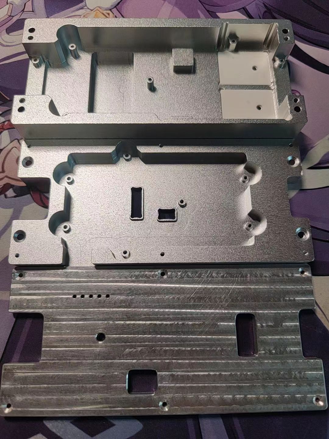

Here's the aluminum case without PCB installed. There's three parts providing shield and separation between control module and power module.
