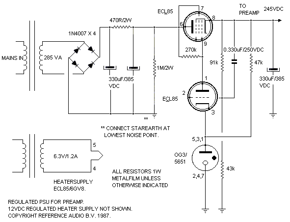

If you have 50V spare voltage on the PSU a dedicated, one per channel regulator can be added.
You'll need a spare 6.3V heater supply xformer, a seven pin + a noval socket, an ECL85/805 and a 85A2/5651A per channel, some resistors and caps and you're all set.
An example:

I have done direct comparison to the identical amp with a series pass tube sort of supply like you have shown. Single bypass of the VR sting with a TFE .056 uF.
Generally speaking, a shunt reg offers better sonic performance ove a series type reg...at the expense of effeciency.
If you look at the circuit posted above you'll notice the big 330µF cap behind the reg.
You'll also notice that the reg isn't really there to perform as a reg but to provide high isolation from the main PSU and by the same token, from the mains supply.
Add a choke as anode load or a CCS and tell me what you hear.
If you hear incredible dynamic range, pinpoint holographic imaging with this kind of topology, you'll know you're onto something special and you'll have the op points for the valve spot on.
