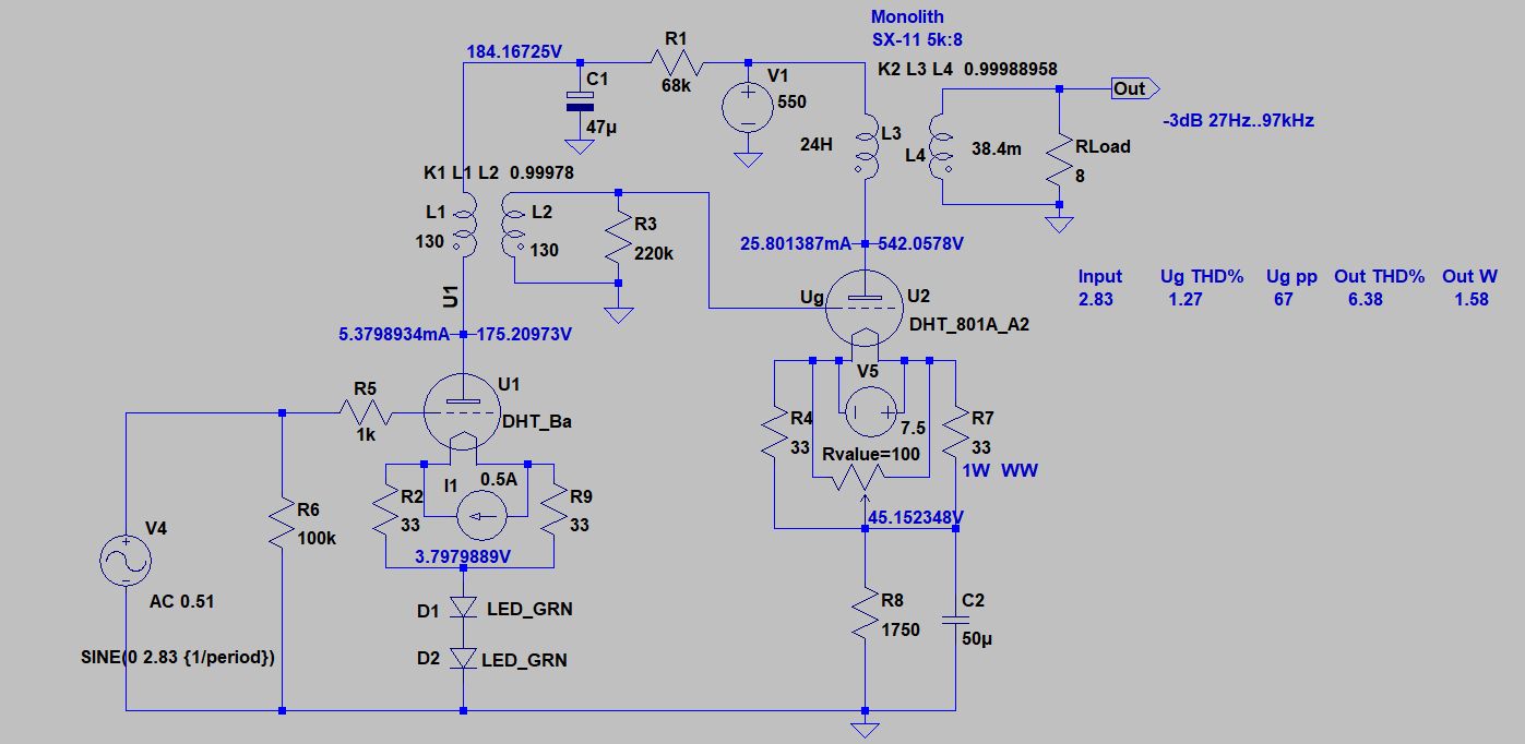

Why don't you learn to use for example LTSpice?
See this sample:
Ba as VAS stage, virtual cathode connected to bias complex (in this case two LEDs).
BTW with this low current the 801a almost unusable as a power tube.
If you want to use it as power stage, need at least 35..40mA current.

I don't understand why you're tormented with these voltage measuring, instead of using virtual cathode for the driver and power tube, as #21 post shows.
For the tube only matters the grid and (virtual) cathode potential difference.
If you put 10R resistor series the anode, you can measure anode current.
