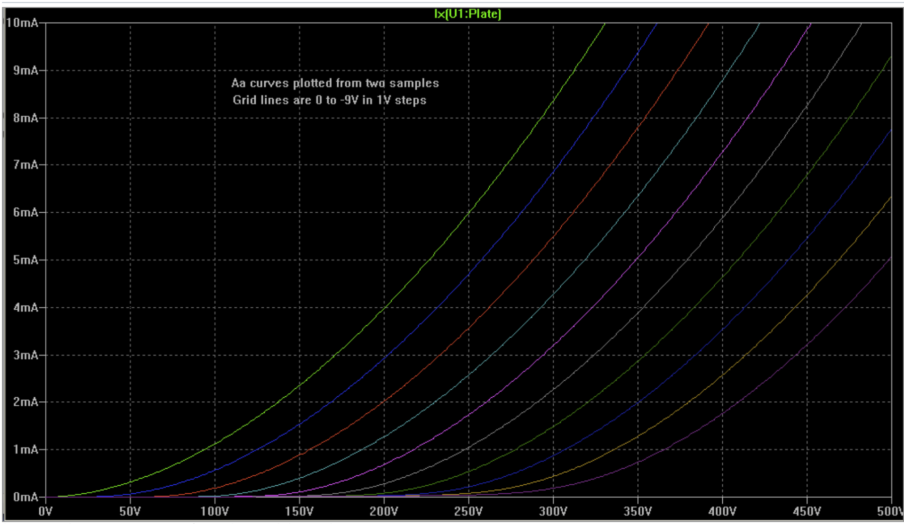

In an earlier thread TS posted these curves for the Aa, which seem to match the datasheet.

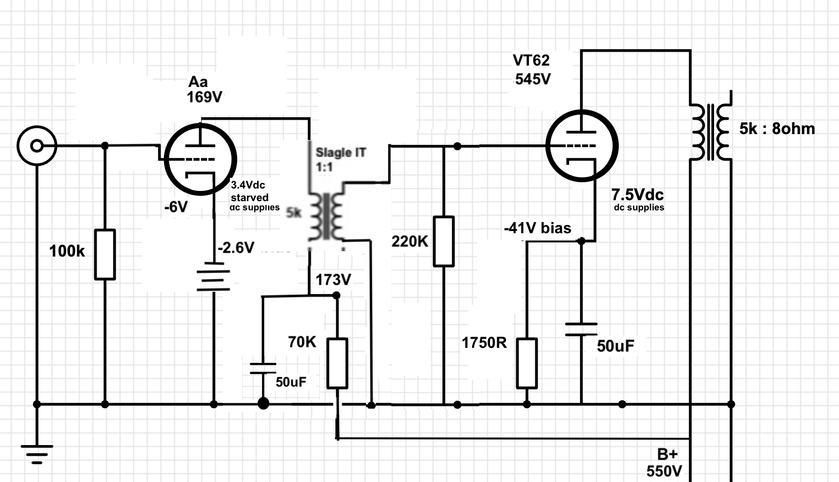

Please find attached a new schematic that reflects some changes to align the operating point of the Aa closer to what Ale has identified. Also, note the LED bias has been replaced with the 2.6V battery. When measuring the filament pins, one of the pins gives -6Vdc, the other that is connected to the battery give -2.6Vdc.
Aa current = (550 - 173) / 70K = 5.4mA
Aa anode dissipation = (169-2.6) * 0.0054 = 0.89W
NOTE: Once the Aa plate voltage was reduced to 169V, the hiss reduced to 3mVac (measured at the speaker terminal). This is barely audible at this point.
When you look at the curves in post #10 you will see that at Va = 165 V and Ia = 5.4 mA, the bias of the Aa would be positive instead of negative.
The grid of the Aa is at ground potential. In order to get a negative bias, the cathode has to be positive with respect to the grid, so with respect to ground. Therefore you should measure positive voltages with respect to ground on the filament pins of the Aa.
Your measurements show negative voltages at the filament pins (which would mean a positive bias). I assume you did those measurements with respect to ground. I think there's something not right with the way you feed the filaments of the Aa or maybe you reversed the polarity of the battery. But since the filament supply is not shown on your schematic, I can't be more precise.

I'm not familiar with the TentLabs DC filament supply.
In your schematic the symbol of the battery indicates that the positive pole is connected to ground. If this is true in reality, than the battery should be reversed.
When you measure, do you have the negative/black probe of your voltmeter connected to ground, and the positive/red probe to the filament pin?
Additional: Your measurements 2 and 3 fit with the battery being connected the wrong way around. So try reversing the battery, while keeping the filament supply connected like it was in measurement 3
I am confident the voltmeter probes are correctly connected.
Measurement 4:
3.8Vdc filament supply (spec)
Supply dc feed wires back to original state (same as Measurement 1):
battery wire are reversed (battery (+) connected to pin A, battery (-) connected to ground).
Ground-to-filament pin A: -1.1Vdc
Ground-to-filament pint B: +2.6Vdc
With this setup, the hiss is down to 2mV which is the lowest I have ever had. It is essentially not audible within 0.5 meter of the speaker.
