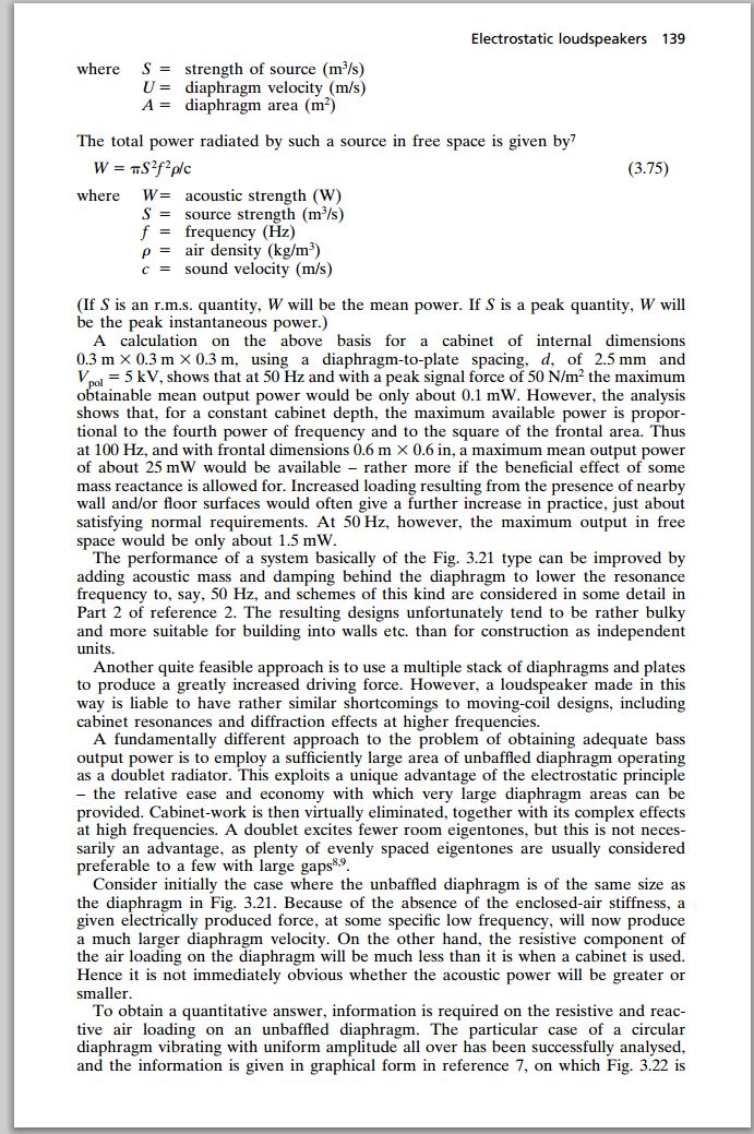

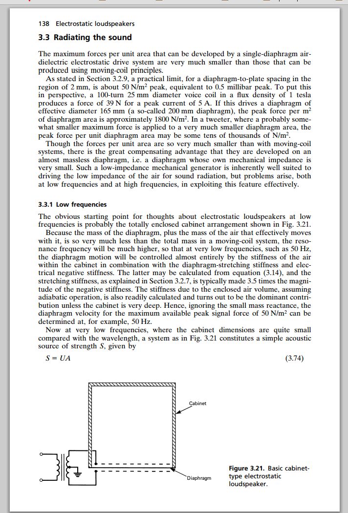

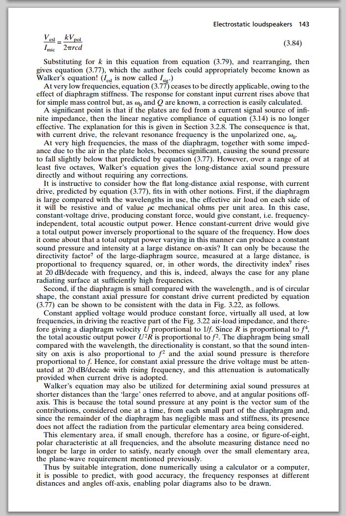

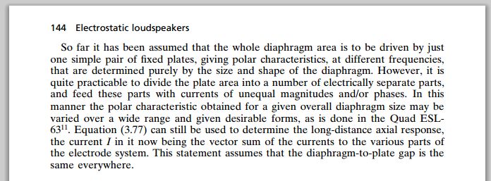

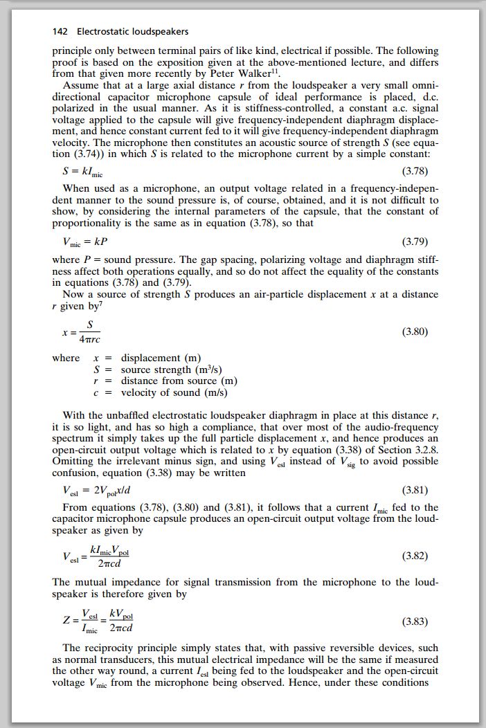

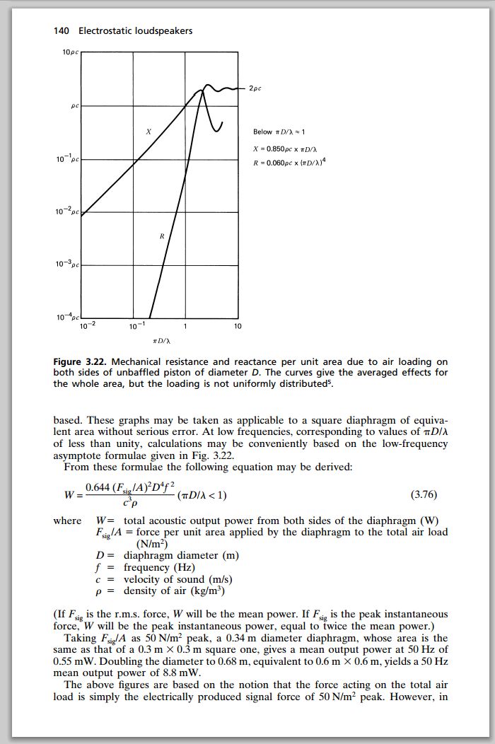

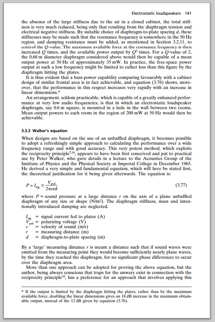

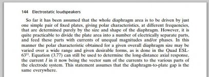

In the book it was stated as 50N/m^2 and not 50 Dyne's as I had stated, sorry for the mis-information.
Here excerpts of the pages of that particular section on just the ESL transducer and its forces.
The Magnetic stuff is in the Book as well in another chapter and an even more in depth description in the section before this one..
What an Awesome book it is.
I found those links freely doing a Google search so I hope that there won't be any copyright issues with my post.

As a physicist I can tell you that the question doesn't make any sense. Electrostatic fields and magnetic fields are different, and you cannot measure electrostatic fields in terms of tesla. But, you can compare the forces that might be generated in a speaker....
Electrostatic loudspeakers work on electrostatic forces - the attraction and repulsion of static electric charges ('static electricity'). There is no magnetic field (of any significance) in an ESL.
Electromagnetic loudspeakers work on magnetic forces, which arise from electric currents.
As someone pointed out earlier, Baxandall shows that the maximum practical acoustic pressure attainable with an electrostatic loudspeaker is about 50 N/m - that is 5 kg force spread over a square metre (limited by dielectric breakdown).
Even a smallish rare earth magnetic is much stronger than this - On Aliexpress I see a 40 mm square magnet that will lift 60 kg, that's about 7,500 x greater force/area. That's why ESLs have to be so much bigger than electromagnetic speakers.
