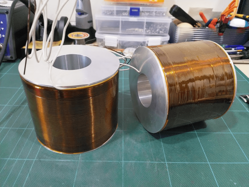

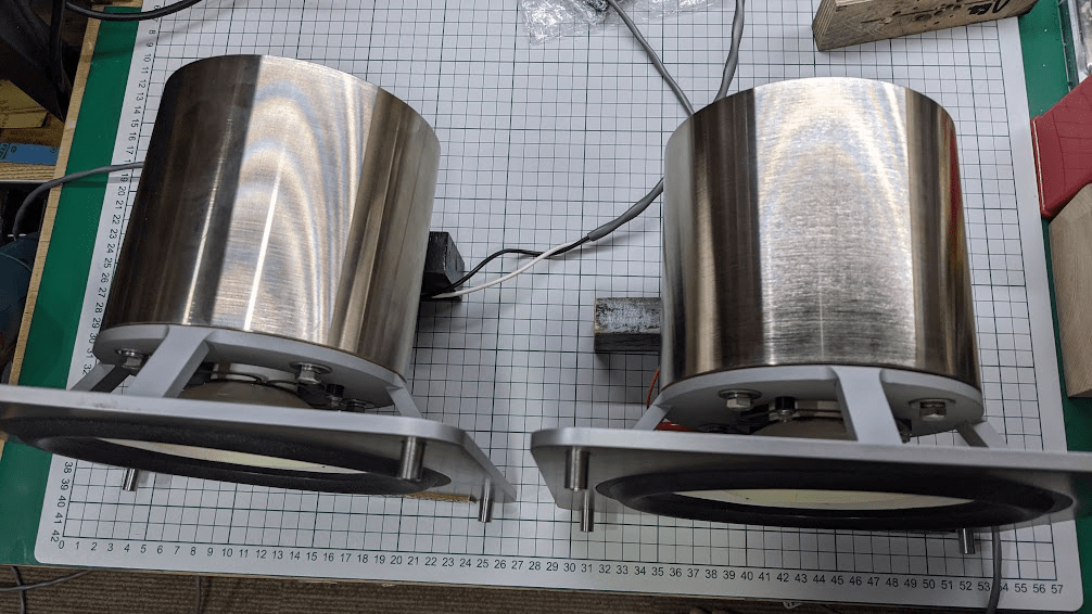

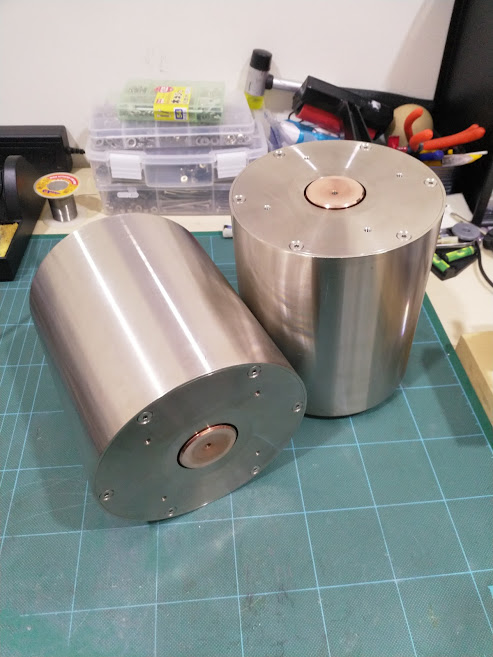

Normally well designed field coils runs as low as 8vdc to 16vdc. It doesn't mean can't use 20vdc, it can run higher voltage. It just heats up the motor.
For example my field coil winding is winded on a Aluminum Bobbin, so I can use up to 24vdc as the bobbin helps to dissipate the heat.
