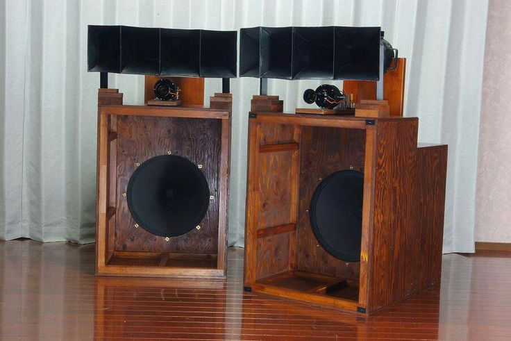

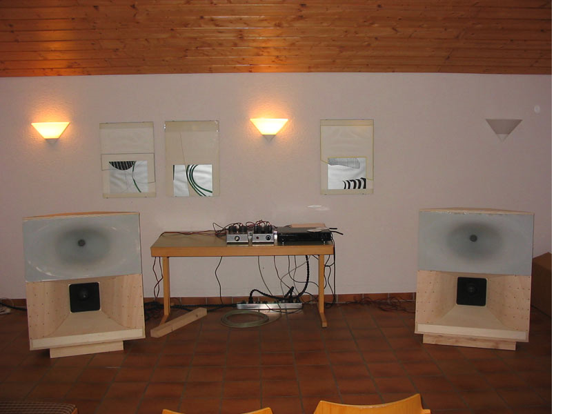

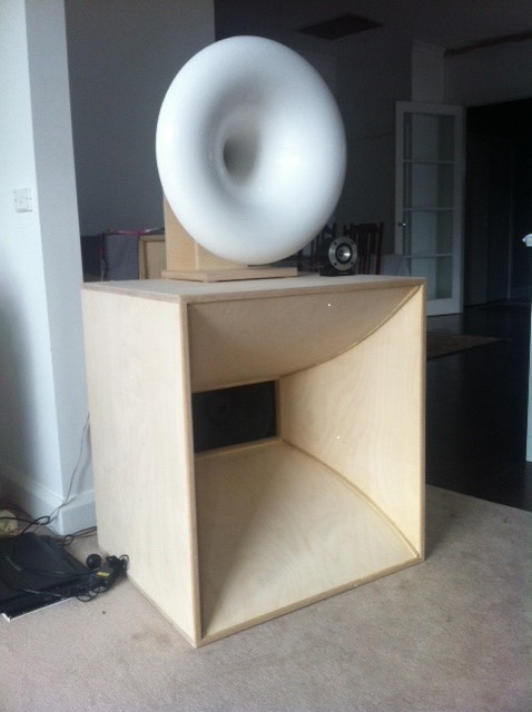

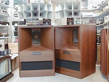

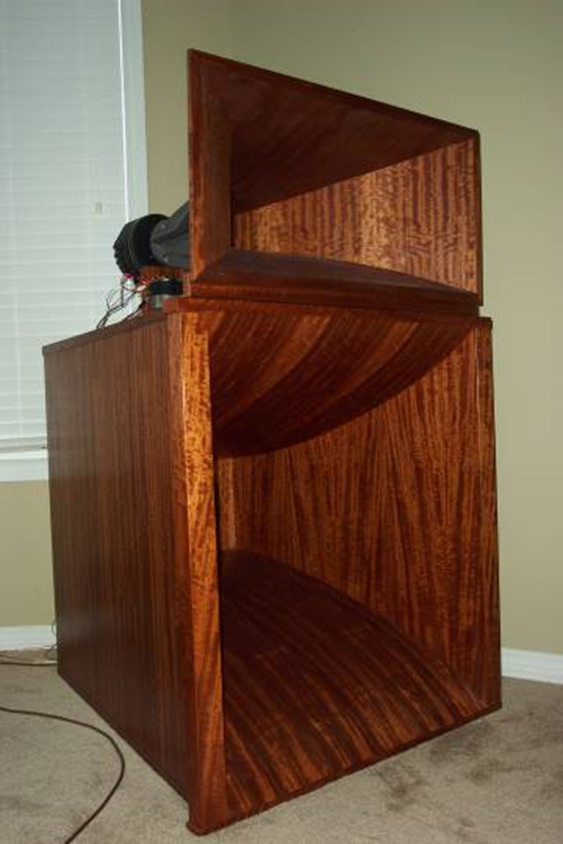

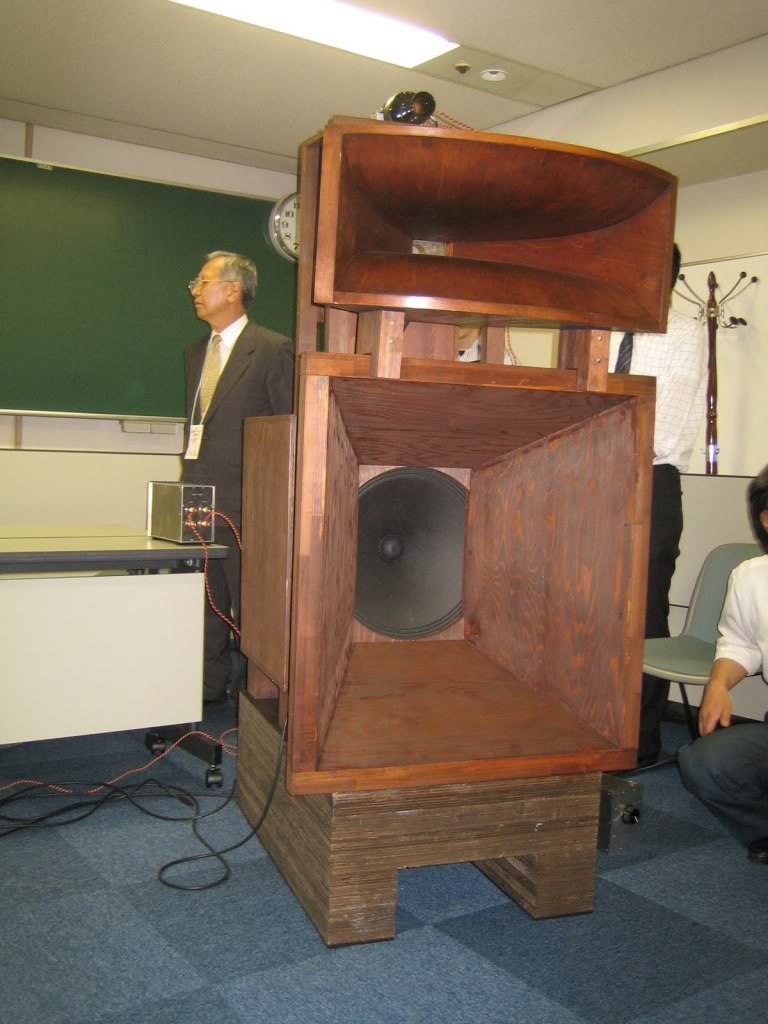

I would suggest a back-loaded horn.
or a front loaded horn.
how much room does one have?
a field coil driver has an advantage of adjustable perimeters ...
Lots of choices.
Was it converted to FC?

Don't worry about a curve not being very flat. They seldom are with a low Q driver in a ported box.
In a 4 cu.ft. box tuned to 37.5Hz, I get an f3 of about 43Hz. OTOH, I would try the designer's suggestions. Simulations aren't everything.

Yes, you can and you can do it all the way to Fs if you like assuming the field coil has enough adjustment and/or you add some series resistance to increase Qts to ~0.403 and cab net Vb = Vas.
For 8 ft^3, 35 Hz Fb, increase Qts until the response is flat, which will be somewhere in the 0.3 - 0.4 range.
GM

Normally, vents just need to be the standard forward firing and close enough to the floor to get good 2pi [half] space loading.
Once you raise the cab to down fire the vent, it's best overall to find the cab/floor gap that acoustically mass loads it enough to slightly lower its tuning, so must be found empirically.
GM
