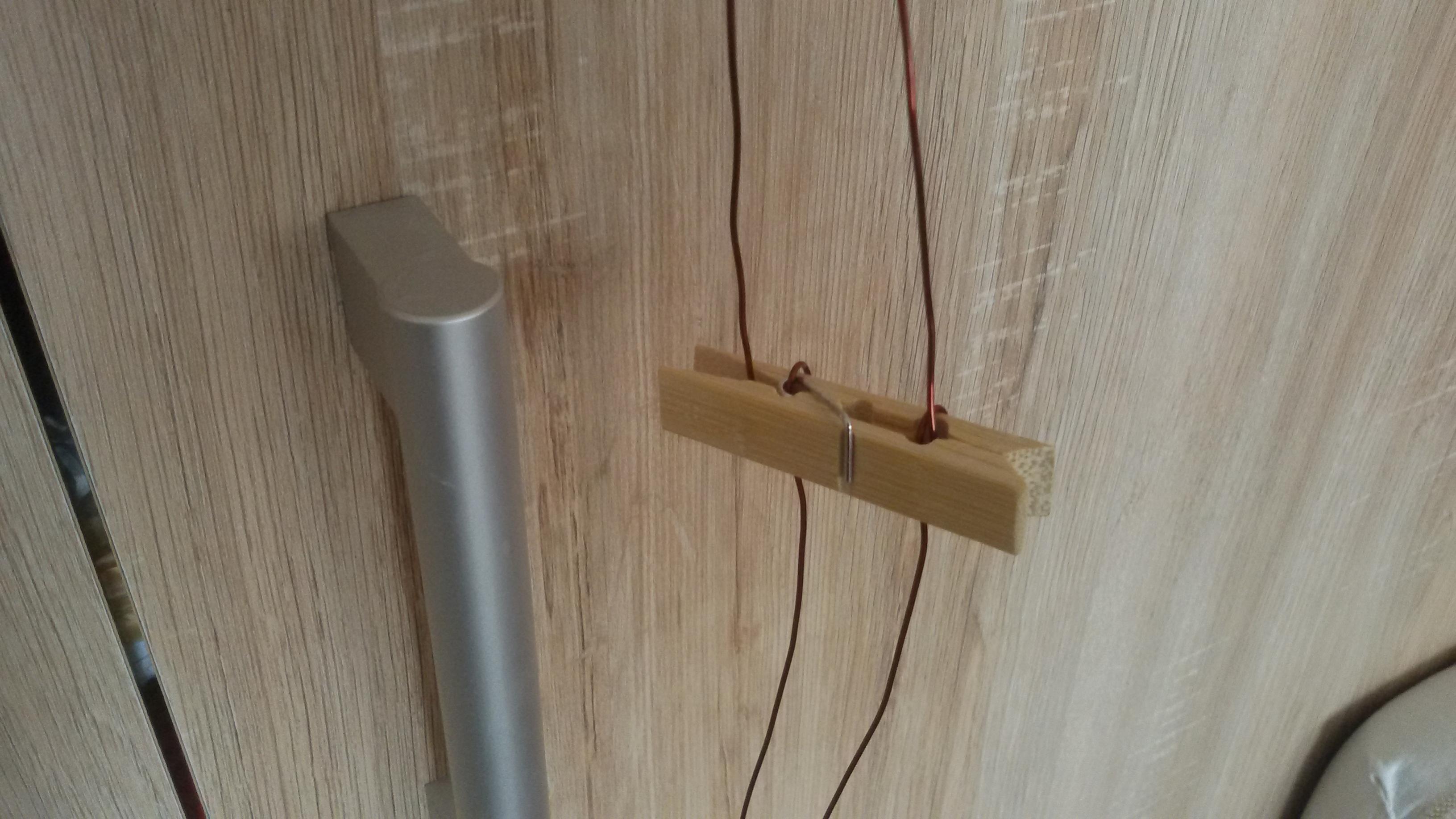

"Magnet wire" is in fact a "bandaid" in this case, because it introduces additional resistance, which, in this case, might be beneficial. I also noticed that fullrange drivers sound better with amplifiers that have higher output impedance, usually tube ones, but could also be solid-state (I am using Pass F2) and I have set the output impedance to around 15 ohms.
You can "simulate" this by adding a 15 ohm resistor in series between an SS amp and a speaker. Burn a few watts, but that's the price. Try it.
P.s. see an example of "magnet wire" albeit a thicker one 🙂

That sounds like recommending/advocating magnet wire to me, that's why I asked about the loop resistance of your experiments.
Of course the wide conductor spacing causes (relatively) high impedance and also constitutes an antenna, not usual audio practice.
