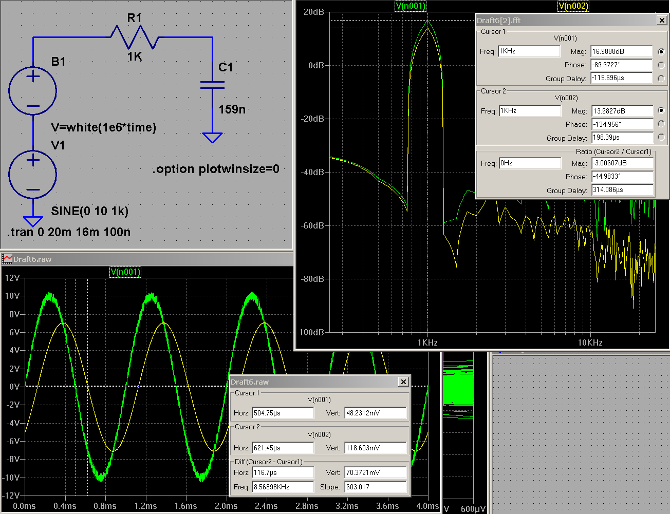

FFT can show this information. Simple procedure:
1. get the phase info from FFT of left channel.
2. get the phase info from FFT of right channel.
3. subtract to get phase difference.
Alternatively, get the FFT results in complex number form (as the FFT actually produced them). Divide one channel by the other. Any deviation from unity is an inter-channel difference. What is all the fuss about? Does the OP know the difference between an FFT (i.e. the Fast Fourier Transform algorithm) and the spectrum amplitude plot sometimes called an FFT? As I have said, an FFT tells you all you need to know about steady-state response under linear conditions, and in most cases also all you need to know about transients too. You do need to understand complex numbers, of course, but that is true for most of analogue electronics. An awareness of the power and limitations of Fourier theory helps too.

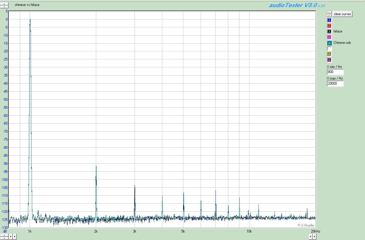

I'm sorry but this was quoted to me by SY
And his conclusions:
To see if the modified Hiface, when connected to a DAC and having the attenuators in the spdif line, causes the DAC to output an analog signal which is any different than a reference unit when fed by normal signals (i.e., ones that come from normal digital sources). I didn't have an unmodified Hiface, so I went to a more extreme direction and used the cheapest unit I could find as the reference.
And this was the FFT shotI'm not measuring jitter. I'm measuring analog signals.

we don't have to "perfectly" represent a series of infinite sines to reproduce real music performances - which don't have "infinite" duration (subjective impressions of high school band concerts aside)
as we keep repeating FFT is a tool for processing data which can make some things easier to measure
below noise and a sine test signal are filtered, compared in LTspice - which gives cursor based phase, magnitude difference measurements
which display/cursor reading would you prefer to use to measure ampitude, phase differences at 1 KHz in this instance?
and again - phase isn't commonly displayed because the FFT "noise floor" also has full amplitude "noisey" phase variations that confuse the eye - we are usally interested in the difference in phase between a few frequencies which have higher amplitude - so navigating with the cursors - or writing a program to extract the information in a particular test is not often a limitation
So you are looking for - what? Phase differences to show why one device sounds different from another? And before we go any further - what type of signal do you want to analyze?
I'm citing this as an example of someone who used this FFT as shown & came to the conclusion quoted. It's not up to me to state what I want analysed - it's incumbent on those who make claims like " if it's in the analogue signal I will find it". I am stating that as per the discussion so far it would appear that this FFT plot simply is not enough to characterise a device & make the statement that was made. Are you saying that it is?So you are looking for - what? Phase differences to show why one device sounds different from another? And before we go any further - what type of signal do you want to analyze?
