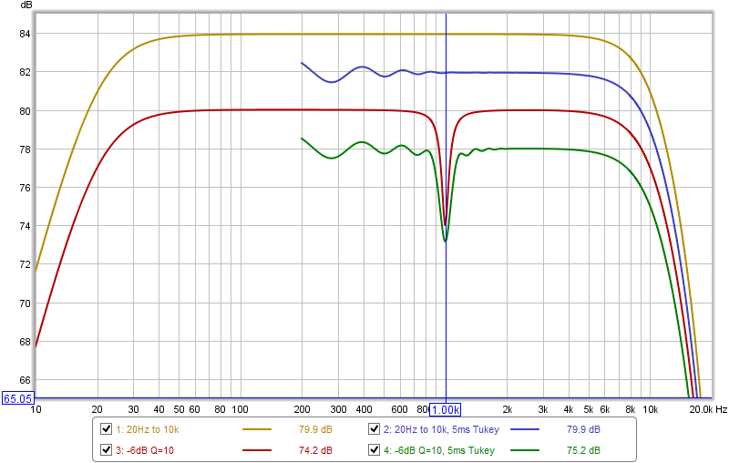

Thanks for posting what you discovered. I think that your argument would have much more weight if you also posted the impulse response for the signal with the dip. Can you post that?
The impulse duration in the time domain of a spectral feature is really what is determining how long of a window must be used. For instance in post #2 of this thread, I showed the case of a narrow Q=20, +6dB peak at 2.1kHz that could be resolved quite well with a 5ms window, even though that is only supposed to "see" things with a 200Hz resolution. But the peak's shape and center frequency (2,100 Hz or 10.5 times the resolution) are very well represented in the frequency domain resulting from the 5ms long window. This was using a 50% Hahn window, which as you say should be worse at resolving these features.
I did some more testing yesterday and today with peaky responses. If I put a peak with about a 200Hz wide bandwidth at a lower frequency (+6dB, Q=5, 300Hz), it couldn't be seen at all (more or less) with a 5ms window, while the peak at 2.1kHz that I mentioned above looks very nice, even when part of the impulse from it is truncated. All I can say is that the impulse from the 300Hz peak is ringing longer because it is at a lower frequency. If you eliminate too much of the time domain response of a particular feature, it just will not appear in the frequency response. Period. At this point I am not so sure that you can make the assumption that "a 5ms window means you can't see anything narrower than 200Hz anywhere" since this just doesn't seem to be quite true. But I think it is fair to say if your impulse has not died out then you will be eliminating something, and that could just be the low frequency part of the response or it could be a mid-frequency peak or dip, it just depends on how that feature come out in the time domain and where your window ends.
By the way on page 3 of the Sterophile article "Time Dilation" the author mentions that KEF developed a method by which they attenuated the low frequency response to "help" the impulse die down enough before the end of the window, then applied the inverse filter to the resulting frequency response. I thought that was interesting so I tried it in a few variations to get a feel for what that does. Essentially it doesn't help anything, e.g. it didn't improve the recovery of any peaks that I put in around 200-300 Hz (using the 5ms gate). After the whole process was done, there were still errors in the frequency response. These stemmed mostly from the fact that, as was mentioned earlier in one of these threads (by Earl I think) that the frequency response eventually has an "upturn" due to a DC offset in the impulse response resulting from the truncation (if I got what he was saying). This "upturn" caused the frequency response to start deviating "upwards" in SPL from what I knew was the correct FR. I could replace the upturn with a 12dB/oct tail, but at what frequency to do this seemed to be guesswork, although after doing so I could get the SPL accuracy to be within about 2-3dB down to 20Hz, like they claim. But the response was just a smooth one - you could just generate it using a box model and splice it together with the gated FR in the frequency domain and get about the same thing, so this technique doesn't seem to really offer any new potential in my eyes.
Charlie, thanks for your work so far. Can you show a peak that's 100 Hz wide and centered at 2100 Hz at different gate times?
Also, does it not matter that the full amplitude of the peak is captured and not just a smaller replica as can be seen in the 5 ms gate in your second post?

As Charlie asked does the impulse in your example decay visibly to zero? Or is the truncation obvious? We all agree that using a too short window is a problem (garbage in garbage out), what we do not agree on is if using a window can ever be done with insignificant errors and "smoothing" or not. No one is arguing that this can't be done wrong, we are arguing if it can be done right.
A 'good" speaker has an impulse response that is quite compact and insignificant errors result from using a window that is tapered only towards the end (not sure if this is what Tukey .25 meant or not - few would use a full width tapered window.)
Again Charlie you are right on the money - this is exactly correct. It is not that a window is error free, its just that it is not resolution limiting across the bandwidth and it is not a problem that a savvy experimenter cannot resolve. That's why I say that posting the un-windowed impulse response should clear up all concerns. I plan to start doing that so that people can see that I am not chopping off significant data.

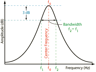

Well, actually that is what I did... I reported the bandwidth incorrectly in post #2. It should be:Charlie, thanks for your work so far. Can you show a peak that's 100 Hz wide and centered at 2100 Hz at different gate times?
BW=Q/Fo
and we have Fo=2100 and Q=20 so the bandwidth of that feature was actually 100 Hz.
It's a 100 Hz BW peak resolved (the degree to which can be debated) with a 5ms / 200 Hz window. Some posters seem to think that resolving this peak at all is impossible by virtue of a property of the FFT and the result shown in the plot below from post #2 is evidence to the contrary:Also, does it not matter that the full amplitude of the peak is captured and not just a smaller replica as can be seen in the 5 ms gate in your second post?

If the feature bandwidth is 100 Hz, the FR should be level at 2050 Hz and 2150 Hz, right? Why does the bump start below 2000 Hz?
No, definitely not!
It's a little complicated for an "EQ" peak. EQ is obtained by summing a bandpass filtered version of a signal with the original signal. For high Q peaks, the definition of "Q" for the bandpass filter is very close to what you get for the EQ peak, however, as you noted the peak has "tails" and when the Q is low the definition of bandwidth used for a bandpass filter doesn't describe the width of an EQ peak accurately. The "width" of the bandpass filter is measured at 0.707 of its maximum, e.g. only partway down, and the bandpass function keeps spreading out before it "blends into the original signal", thus at "the base of the peak" the signal+EQ is wider than the EQ bandwidth.
This figure illustrates what I said above:
