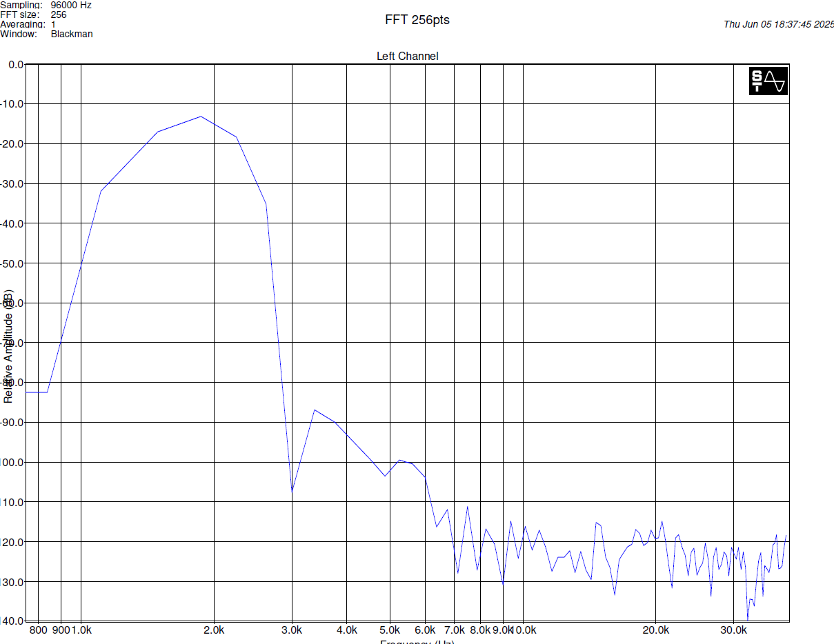

This one to be moved as well. But I can't help to show that the idea of disappearing spectral content is a nonsense, demonstrated on 256 points FFT. It is just as @JohnPM has mentioned.
