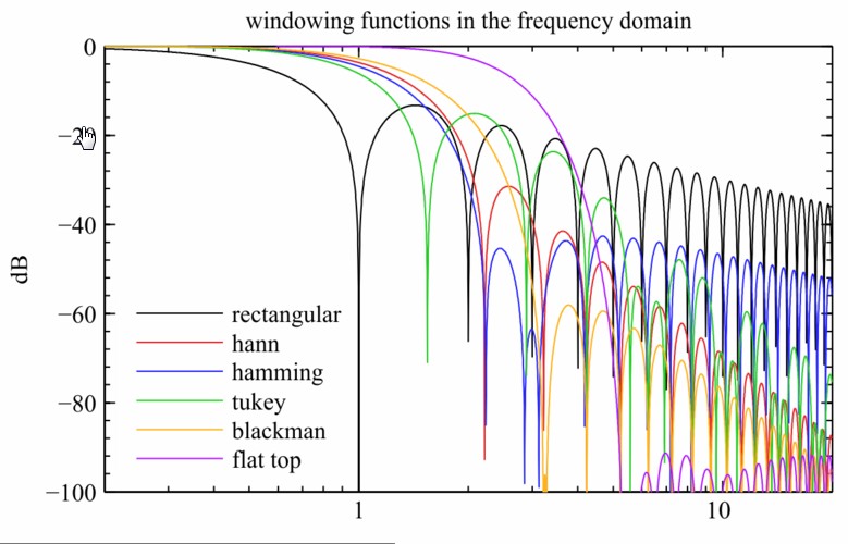

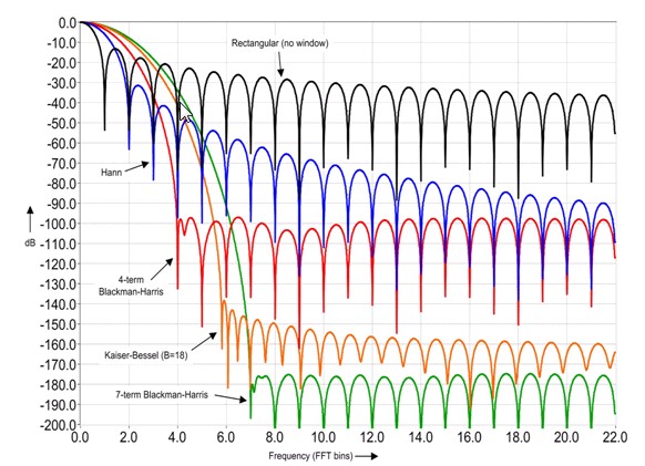

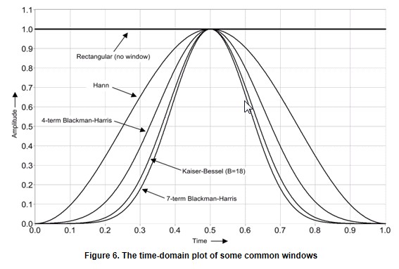

Would you be so kind as to explain the advantages of different windows from your perspective? In particular, if one time windows an impulse response to window out reflections, why then window for CSD or Tone Burst; seems to me it might be because they continue outside of the time window that was set. In addition, the tail of the Impulse response is windowed to eliminate the reflections, for FR, it seems that you would want a narrow window with low side lobes to eliminate cross contamination from neighboring frequency bins. In fact, I would appreciate your weigh in on how to weight the importance of a more narrow main lobe vs. lower side lobes in FR measurements (say, 7 term blackman harris with the extremely low side lobes vs. Hann with a more rapid decent (more narrow main lobe) but side lobes that are not as deep for FR, THD, IMD, Tone Burst Testing, etc, with loudspeaker measurements.
My take from the information that I have obtained is that for FR testing & CSD & Tone Burst, the lowest side lobes with the narrowest main lobe is beneficial and you would have to balance which is more important in comparing something like a Hann vs BH (your input here would be appreciated as to how to balance this) while for THD and IMD, since relative amplitudes are important something with a wider main lobe might be of benefit?
Just to clarify my understanding further, a flat top or Hanning seems like it would be advantageous for CSD or Tone Burst since they continue outside the window and a Hanning brings down the side lobes well while a 7 term Blackman Harris or a Kaiser Bessel might be good for FR due to a narrow main lobe?

As to the shape of the window, your plots exhibit the tradeoffs between width of the main lobe and suppression of the side lobes. I would tend to prefer the narrower main lobe to suppression of the side lobes.
