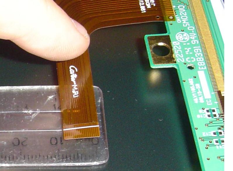

It looks like a 30 pin ffc, check out mouser.com catalogue page 1001 or there about. You can buy the connector and cable just make sure you count the number of pins.
I counted them and recounted them - 20, Right? You can get the ffc extension and connector for $11.99 at the Lumenlab store
FFC Lumenlab link
FFC Lumenlab link
or mouser.com
go to mouser.com
look at the online catalog for FFC pages
look at the Molex FFCs and connectors, 0.5 mm pitch
you need a 20 pin 0.5 mm pitch FFC jumper and a 20 pin 0.5 mm pitch vertical ZIF SMT connector.
Together, those run $5 to $6, plus shipping.
If one 6" jumper is not long enough for your design, then you can get 2 sets of jumpers and connectors and join them together.
