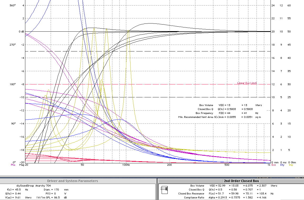

Try it again, this time with 40Hz tuning in a 14 liter box. Port is 2" dia, x 9" long. Looks decent to me.🙂
This is your tuning (see pic). It's actually more like 50Hz tuning with your port tube dims, not 37Hz.

Here is my set of sims. Looks like 13 litres is close to optimum. The higher tuned version requires a high aspect ratio slot vent to deal with the slight peaking. A regular cyrindrical vent for the other. Even does a decent job sealed if you can take advantage of room gain.
With your larger box you may want to damp the vent and push it towards aperiodic.

Jeff's image was of my tuning for the prototype box where I used the T/S for the 8ohm version on accident.
What I'm getting now looks close to what Dave just posted.
I'm going to try a 13L vented box with varying degrees of stuffing and take some measurements.
