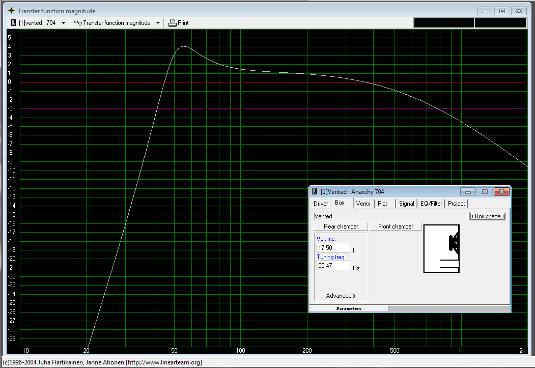

I forgot to update that I changed the internal volume for the woofer section of the cabinet to 17.5L with a tuning frequency of 37Hz using two 2"(5cm) vent tubes, each 9.25"(23.5cm) in length.

Try it again, this time with 40Hz tuning in a 14 liter box. Port is 2" dia, x 9" long. Looks decent to me.🙂
This is your tuning (see pic). It's actually more like 50Hz tuning with your port tube dims, not 37Hz.
