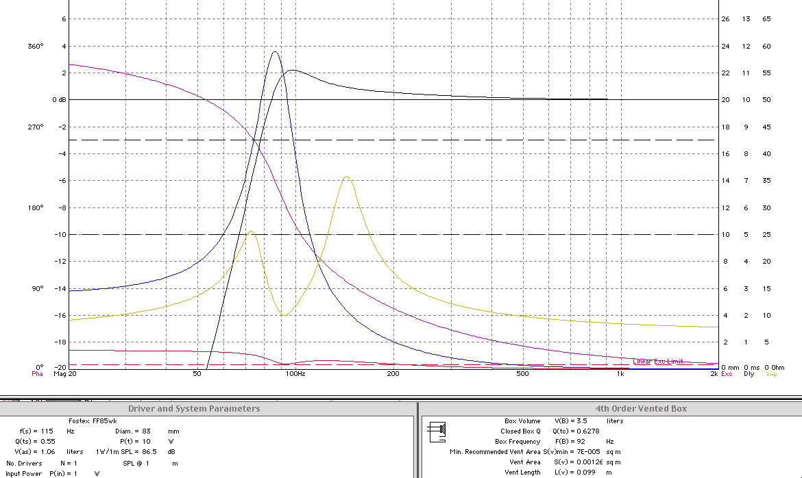

I want to add that I thought that the FF125WK sounded really pretty nice in its official factory enclosure (I listened to the whole FFxxWK series in their available-in-Japan-only ready made enclosures while in Tokyo a while ago). Indeed the curve isn't perfect but the thing is damn musical unfiltered - which surprised me.
I liked the FF125WK most, then the 105WK (quite similar but a bit less bass of course). I also liked the bigger ones, nicely musical and unfatigueing despite the curves, but they are best partnered with a tweeter. I did like the FF85WK least (sorry Dave), on its own it sounded like a computer speaker. But I can imagine that it will be good when partnered with a woofer. Hence you may want to check it out for the line array project, budget permitting.

Could have been the Fostex factory box. Even in a good box they are lacking bass, but they do everything else so well.
It is a reasonably tuned BR box, nothing magic there, it is just that they did sound a lot smaller and leaner than even the 105 variant. Yes, I also had the impression that they do a lot of things well, but I would personally never use them as a standalone fullrange driver, I want my music to have some body in the low frequencies. I am curious how they would be in a FAST configuration though, only used from say 300 hz upwards.

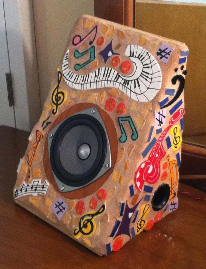

The FF125WK is very nice in the metronome, and I am very, very pleased with them.
I have another pair of those just arrived... the 1st pair got scooped up before i could audition them.
I'm hoping it is a case of the smaller the better. FF85wk is fantastic, FF125wk is good but not without some issues that need dealing with. If 105wk is more towards the FF85 i'll be happy.
