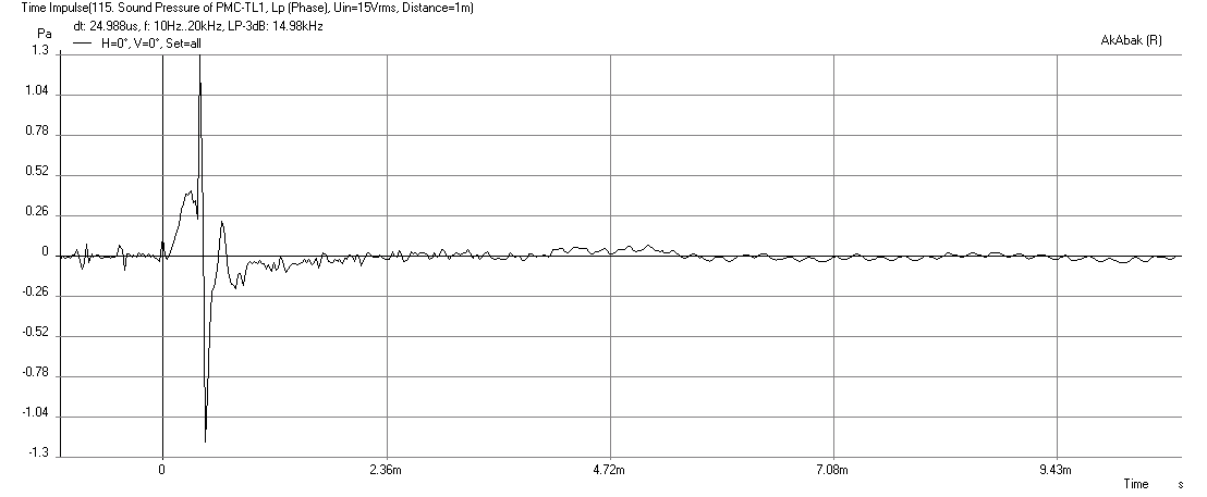

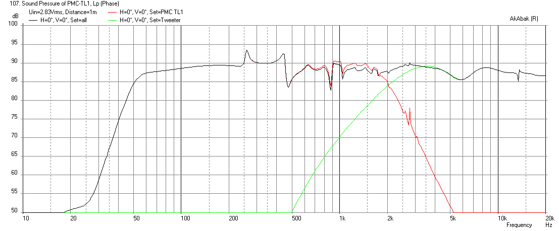

Here is my base tapered TL simulation for a 2-way using the dual 5FE120's and an RS28F with a Harsch XO at 2100Hz. I just figured out how to model the Harsch XO in Akabak. As you can see, it has the characteristic dip below the woofer-only trace. The delay seems a bit wierd as I need to use 0.40 ms to make it work when according to theory it should be 27 uSec. Max SPL is predicted to be 104dB at 15v.
Here is the corresponding impulse response:

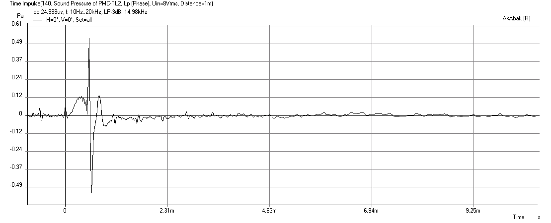

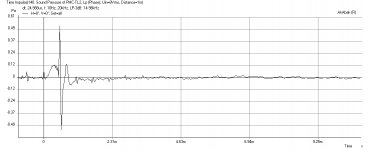

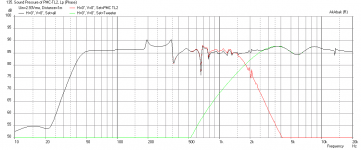

Here is a very rough cut at a sim for the Satori MW16P-4 in a TL similar in shape to what I have in post 1 but scaled up to be about 17.3in tall (internal, no thickness of wood added), 7.0in wide (internal) with the first channel 5.75in deep, the second one at 3.84in deep, and the last one at 1.92in deep. So the depth is 11.5in (internal no wood thickness yet). For 0.5in thick EVA or plywood add 2in to depth and 1in to height and 1in to width for a 18.3in tall x 13.5in deep x 8in wide speaker cabinet. The driver is 3in deep so the 5.75in deep channel works well and allows room for absorbent padding behind the driver. Based on 17.3in height, the TL length is about 1.31m. If you add another segment to have it front firing that would make it 1.6m long and that would extend bass lower but at expense of SPL. Probably down to 83-84dB or so. So I think 86dB sounds much better and is compatible with low power class D TPA3116 amps.
Here is the predicted response (the smaller peaks will probably be attenuated flat with felt lining and some stuffing which is not properly accounted for here). The sensitivity after baffle step losses is 86dB at 2.83v and the f3 is 42Hz. Here, the Harsch XO point is 1700Hz (selected based on what Parts Express recommend as XO point):
There is a problem though, this design needs to be reworked from scratch as it doesn't load the cone properly and xmax is reached at only 8v drive, thus limiting max SPL. But it gives a good starting point for tweaking.

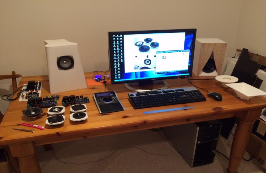

I am using the F105WK TL side by side with my PA130-8 XKi as desktop speakers to compare. They are powered with a "Lunch Money Amp" - TDA7297 and 12v wall wart and sound pretty good together. Similar sensitivities and can get louder than I need with a 12w amp. Trying to decide which way to go for the stereo pair. I might just keep running it asymmetric like this for while. The PA130-8 is the Daytonator diy coaxial that I made. Both seem to hit the highs quite well and have rich full sound down to 60Hz with circa 88dB sensitivity.
From the above photo, if you simply replace the right side speaker with the CHN-70 Karlsonator (more info here), you get this sound of classical guitar which I thought so remarkable, I had to share.
The pair is quite an odd couple but amazingly work well together. Quite the nice sounding desktop speakers. Right now powered by a TDA7297 class AB amp.
