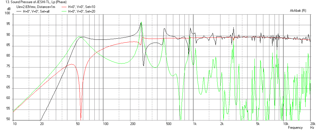

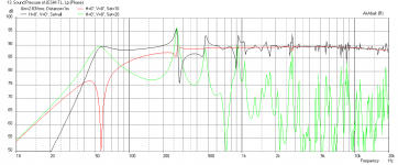

Here is the simulation of the TL response with no baffle step losses:

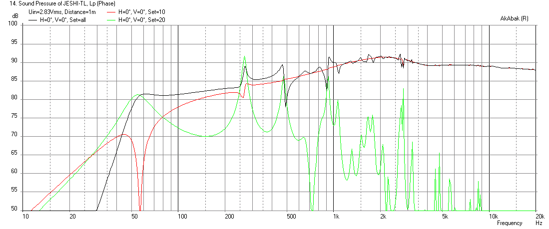

Here is the sim accounting for baffle step losses (pretty drastic isn't it?):

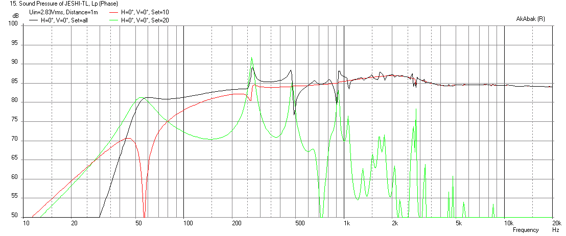

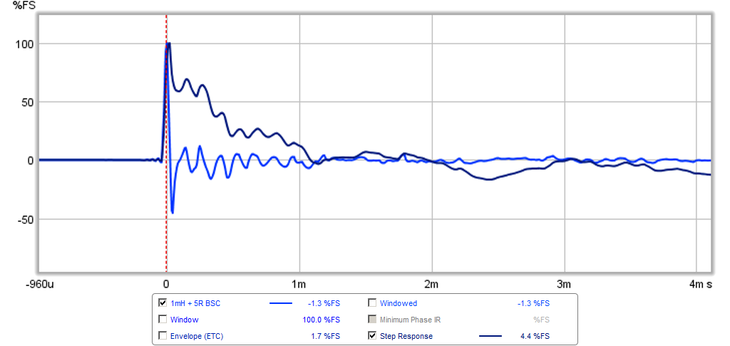

Now if we add a 1mH+5R BSC to help even the response we get this predicted response:

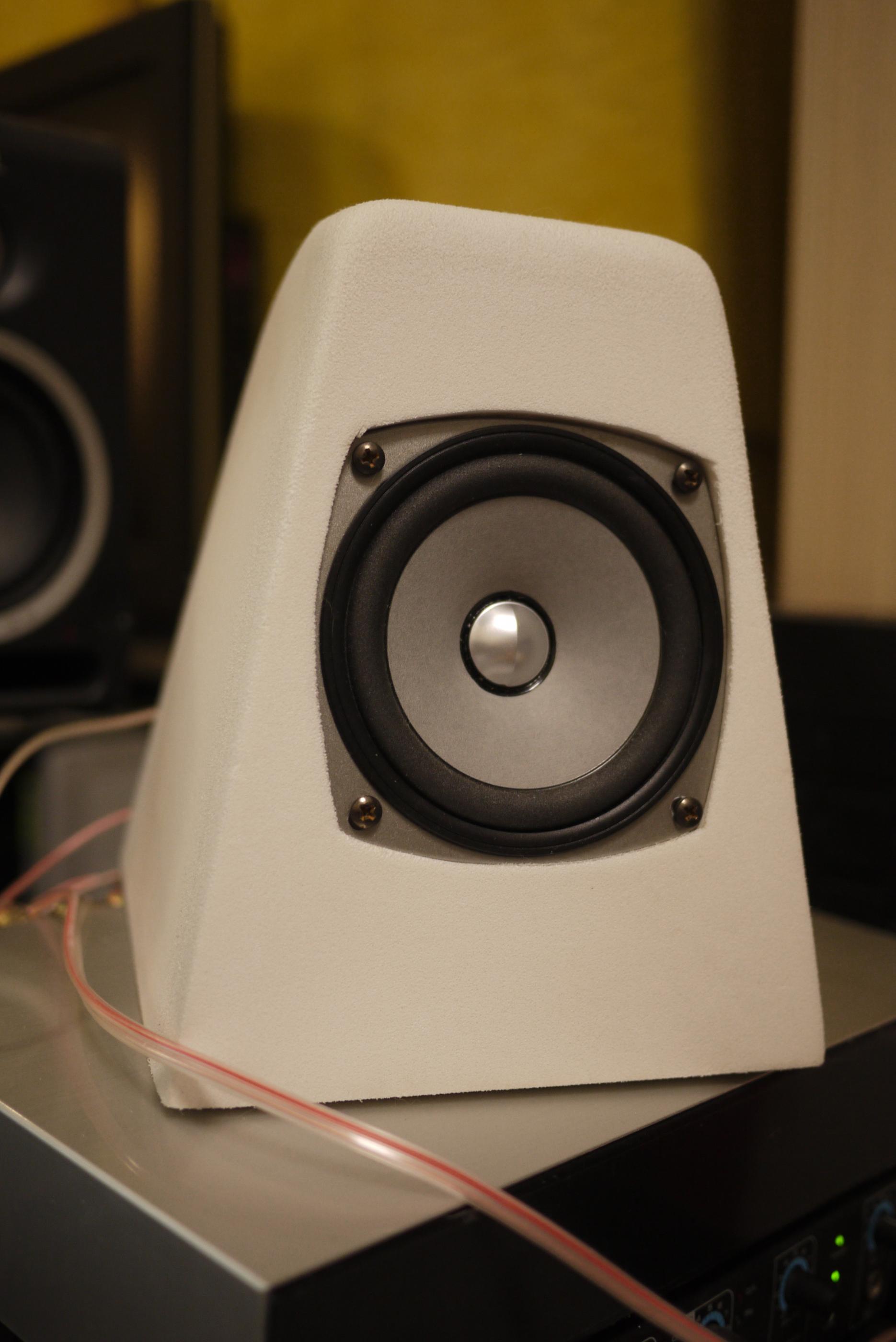

Here is the finished speaker with a compound curved baffle that has a large radius of curvature at the top and smaller at the bottom. The front baffle is comprised of 3 layers of foam core with 2 layers of Liquid Nails (low VOC) for CLD, and the top has two layers with one layer of CLD - they sound very dull under the "rap the knuckles" test:
Internally, I lined the areas directly behind the driver and adjacent with phenolic BASF sound abatement foam (available as Mr Clean magic eraser sponges), adn stuffed the closed end with fiberglass and a small wad of fiberglass at the first bend on the bottom.
Here is a nice detail showing the compound variable radius of curvature side edges (large radius at top to smaller radius at bottom). Using traditional score and bend techniques discussed in the Cornu thread.
Here is the front view (9.5in wide at base in front, 7.5in wide at top in front x 5.25in wide at back x 9.5in deep x 13.75in high):

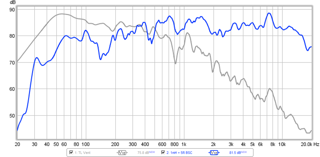

Here are the measurements before the curved baffle and with a few levels of BSC (5 ohms and 8.2ohms with a 1mH coil). I have not connected it to miniDSP yet and wanted to see how flat I could get it passively. This is with 5ms gate and mic was 0.5m away with speaker on 30in tall stand (red is before curved baffle, dark blue is with curved baffle and BSC - 1mH + 5R):
The dip at 2.1kHz and peak at 7.5kHz are inherent to the FF105WK (see manufacturer's response graph).

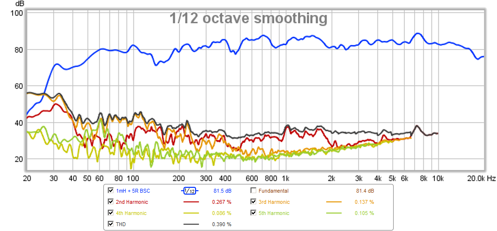

This is the measured harmonic distortion at the LP:
This is the measured Impulse and Step Response (transient perfect) at the LP:
This is all done without any EQ or DSP - just a passive BSC and plain amp driving full range. Starting here there should be minimal work to flatten it out with the DSP EQ in a program like Jriver.

Looking at phase and step response, I'm not seeing transient perfect response. Unlikely that this speaker will reproduce square wave at more than a handful of frequencies.
Quite amazing what you can do with foam, and the speed that you turn designs out.
Yeah you are right. The SR has the looks of a right triangle but not transient perfect - heading in the right direction.

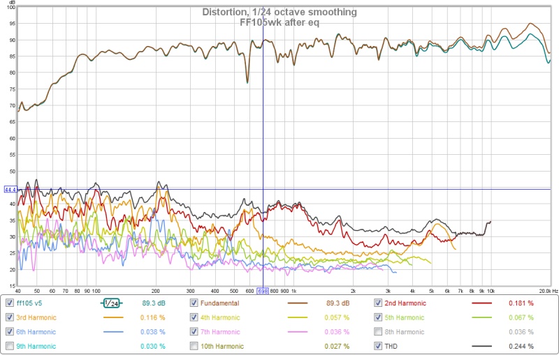

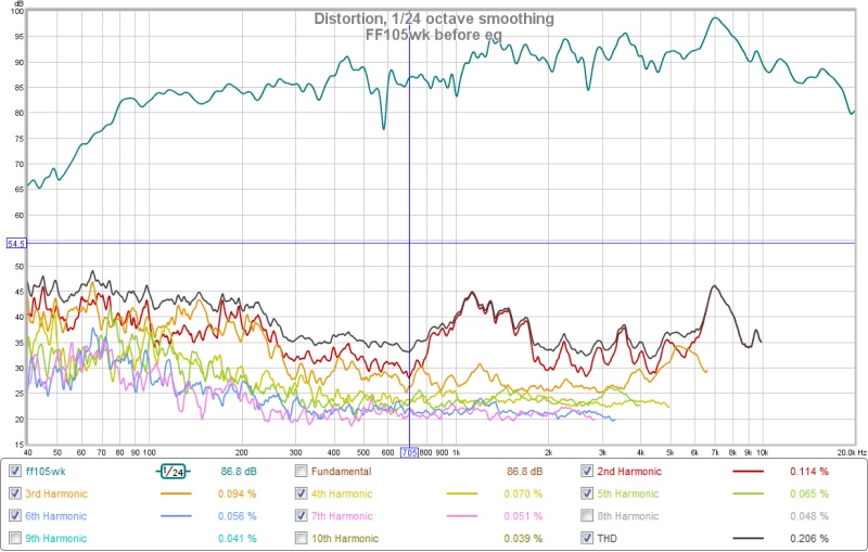

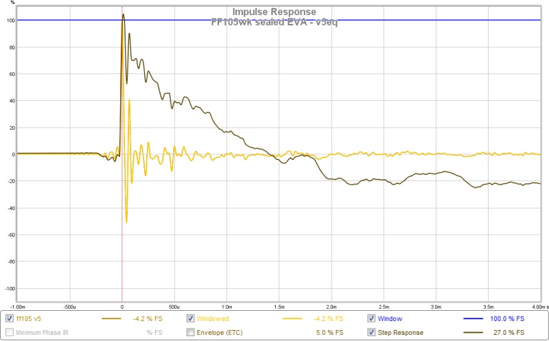

My FF105wk is in a sealed EVA truncated pyramid rhomboid box. I apply 5 notch EQ filters to smooth it out with my miniDSP.
Impulse and step response after EQ (edit: ok maybe this isn't so good)
FR and HD after EQ
and finally FR and HD before EQ
FR and HD after EQ
