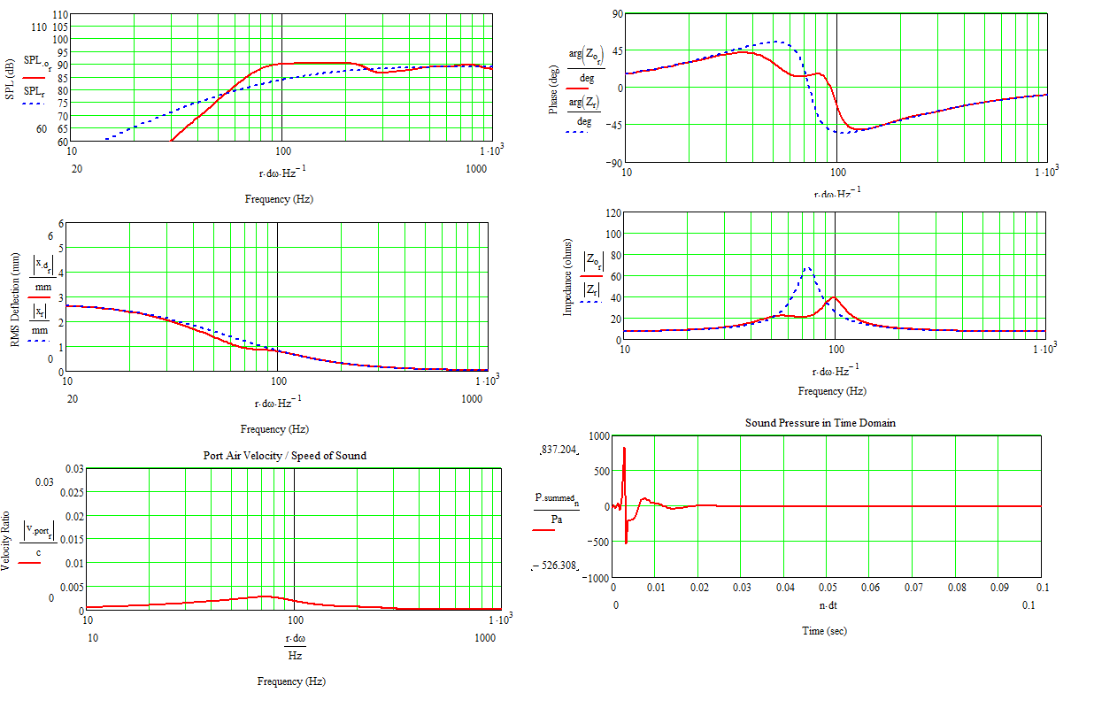

A TQWTL like a Metronome with good ear height should be no problem for this driver as it is a basic 4 inch class driver. A FH3 shoukd also work as it cants the driver up 5 deg with a height if around 30 inches.
Here's a nice small MLTL that roughly fits the height restriction.
Internal dimensions:
28.5in x 5in x 7.75in (HxWxD).
Zd = 5.625in.
Slot vent full internal width, 1.5in tall at bottom of front baffle. 0.75in long.
Stuff box with uniform density of 0.5lbs ft^3 of Dacron hollow-fibre material & adjust to suit from there. A removable back to allow easy access would be useful -just ensure it's well sealed.
One of my favourite vented alignments -quasi pro-audio style with a little extra broadband gain to help with losses & give a bit more subjective punch to the midbass. Easy impedance load & very linear driver deflection behaviour, both moving toward TL characteristics. It's not tuned for maximum extension, but should strike a useful balance.

Scotmoose's design is probably the simplest to build and should sound good IMO. BTW, I assume it's for the FF105WK?

The tap location is given above under Zd: driver centre = 5.625in from the internal top (which will be about 2in between the internal top & the frame).
