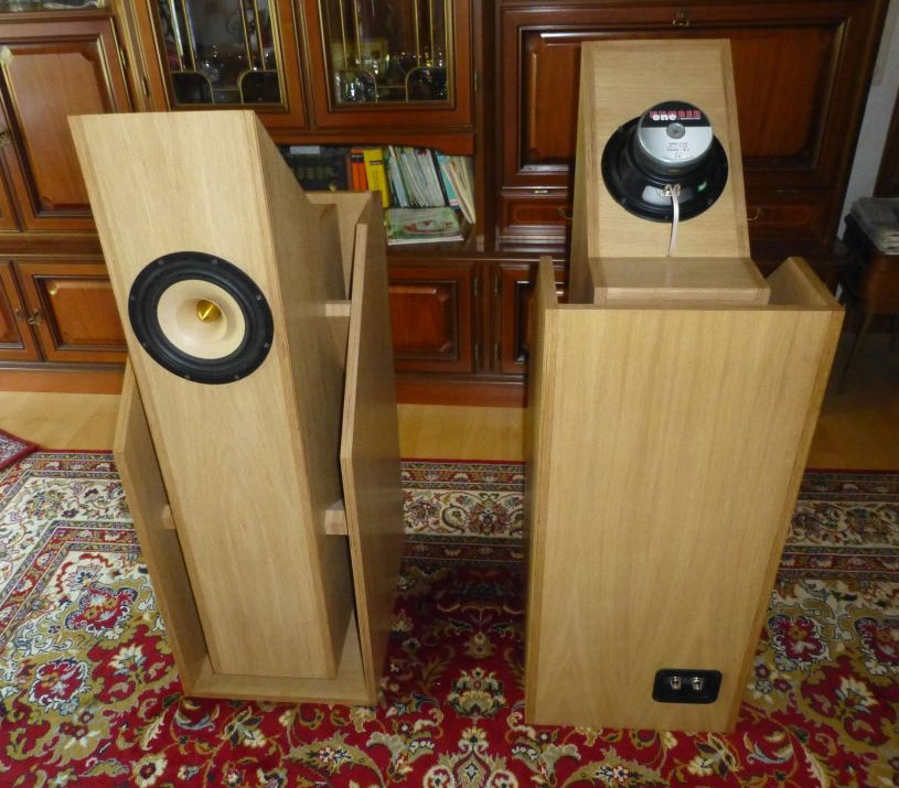

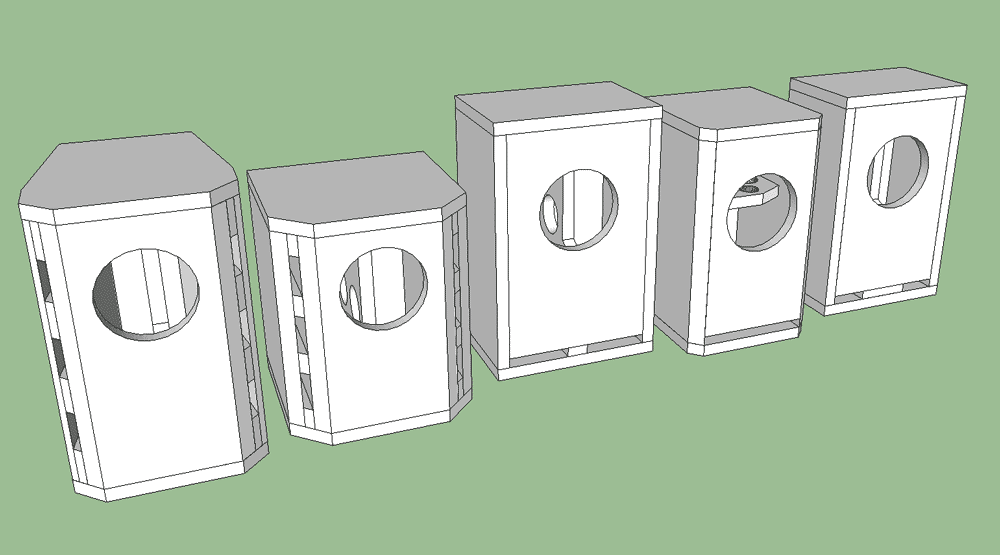

The FE103 SOL fits the same miniOnkens as the FF105wk (with adjustment of tuning). 5 litre is optimum for this kind of alignment.

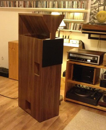

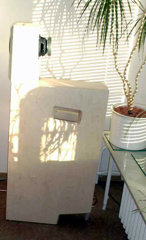

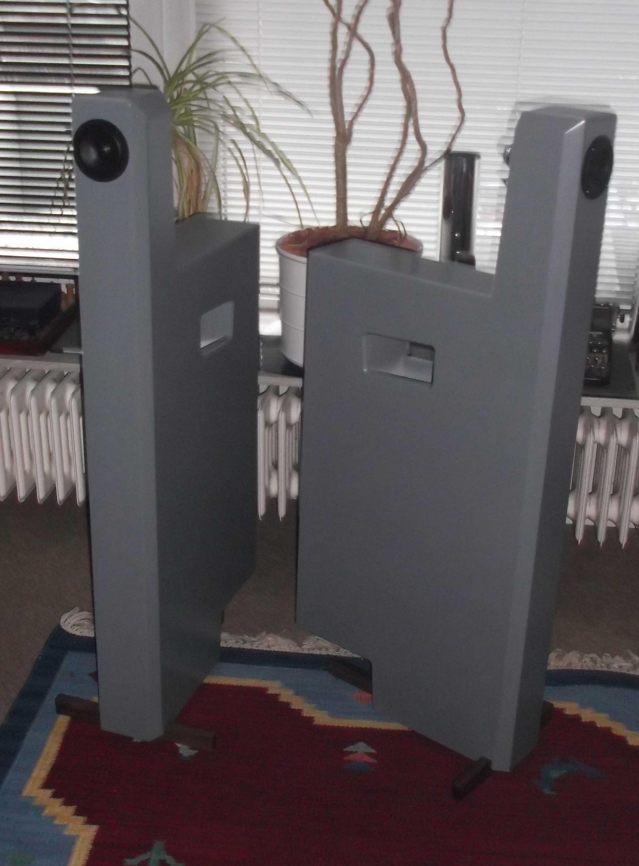

HM: What an interesting design. Thank you for bringing that to our attention. I'll be starting with simpler builds first, but I'm keeping the Kornett in mind for a little later once my woodworking skills are up to it. Would you say the Kornett is a good speaker for romantic symphony such as Beethoven?
Dave, thanks for the info the miniOnken. Would that be the trapezoidal style you're referring to?
There is a trapezoid, rectangular, & CGR versions of the 5 litre box, a smaller 3.6 L CGR and the standard 4.7 L millSize box.

if you get a good recording, classic has a super soundstage by the indirect driver,
at ~95 db 1m is the end, if you want original sinfonic SPL take a biggger one
like SAXOPHON or RDH20

Is there an actual dimension drawing of the 5 liter CGR FF105 ?
