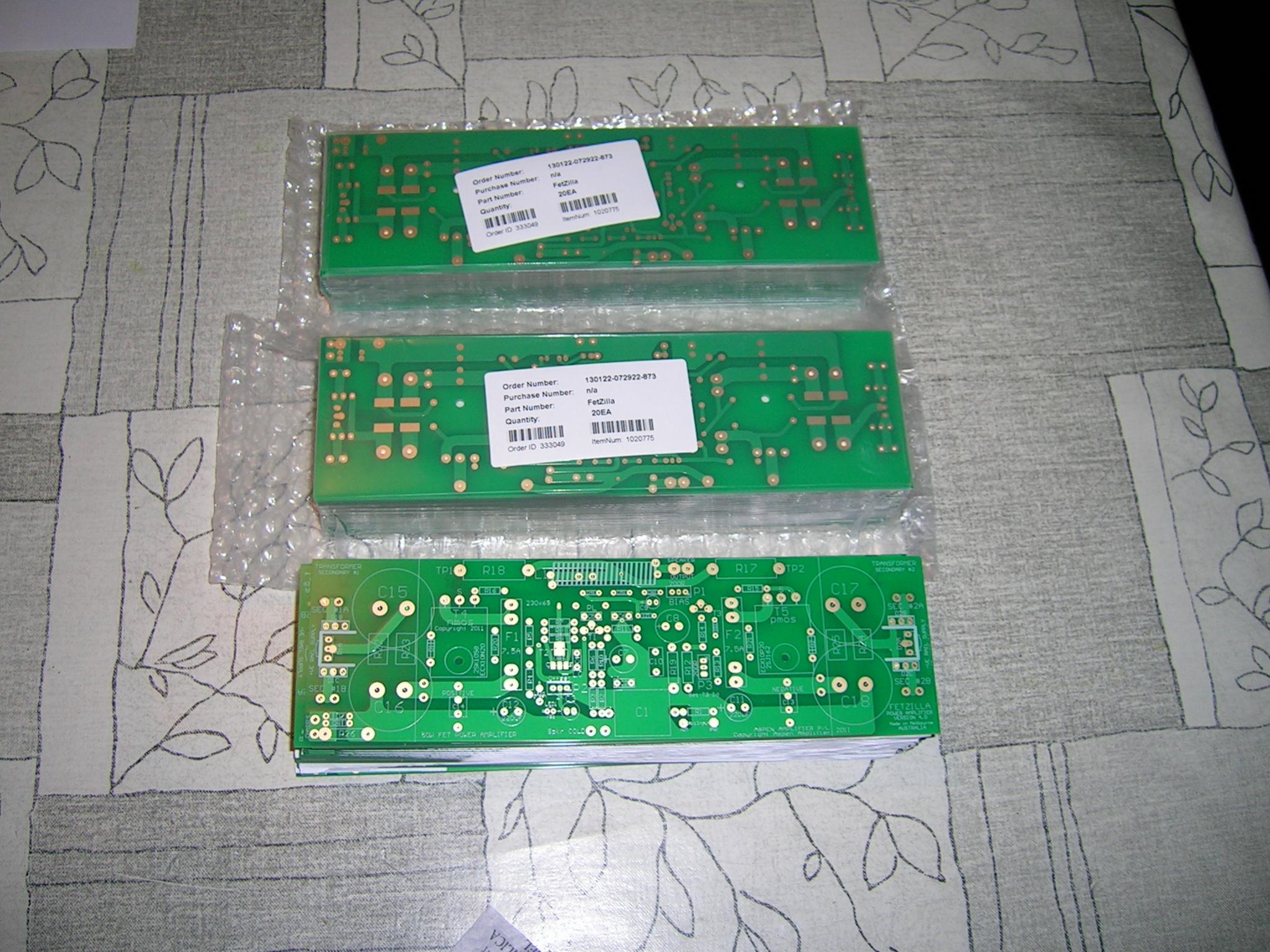

Do you mean for this groupsbuy?I'm offering a parts kit with this amp yes also the output fets.I'm using the ALF08P(N)20V fets with good result other brands I don't know.I think the Exicons are the same quality.A few guys of the groupsbuy are planning to use the 2SK1058 - 2SJ162 from Renesas those are cheaper.

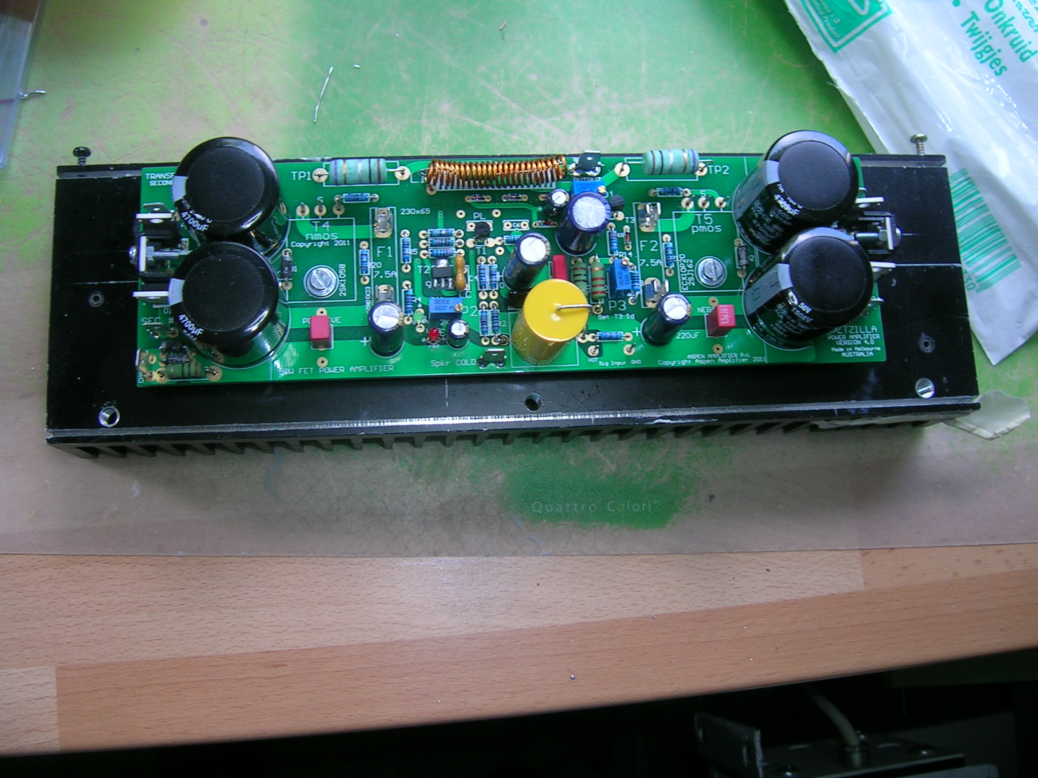

I'm using 2x24Vac myself only a minor setting will be different.The board size is 230mmx69mm.My heatsinks are 290mmx90mm and the temparture is max.38-40°
As a rule of thumb you can say: using a 1C/W heatsink means: each Watt that the amplifier comsumes will add 1C
to the existing room temperature on the heatsink.
So: if your room temperature is 20C and you play your music in a way that the amplifier consumes 40W, this will result in about 60C on the heatsink.
I always take care that a heatsink does not get hotter than 50C and therefore think that it would be better to go for a 0.5C/W heatsink.
Please find out how much wattage one channel of the FETZILLA consumes yourself.
Best regards - Rudi_Ratlos

Snap In is 10mm and 30 mm size 105° and yes they are included in the kit.4 X 4700µF is more than enough.Read Hugh Dean is comment about that he has given a reason why not use more µF.
Hugh's comments on cap supply in the psu are as follow:
http://www.diyaudio.com/forums/aksa/191053-swordfishy-aspen-fetzilla-power-amp-11.html
Post 104:
Dinesh,
I really would discourage you from building a huge power supply. It will not sound so good.
I have done extensive testing with Class AB amps on this issue and found again and again that the very high charge pulses found in high cap power supplies actually militate against good sonic performance. The problem is that these very high charge pulses interfere with the voice coil earth return through the filter caps, causing intermodulation.
I find it's never necessary to go much more than 4,700uF on a 50W amplifier.
The FETzilla uses two 3,300uF caps separated by interelectrode resistors, each of 0.15 ohms. This quarantines the charge pulses principally to the first cap after the rectifier, with the second cap handling much reduced charge pulse and all of the speaker return current. This arrangement gives palpably better sound.
Hugh
