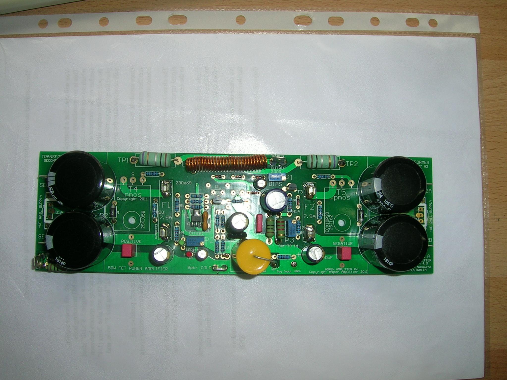

Second channel almost ready

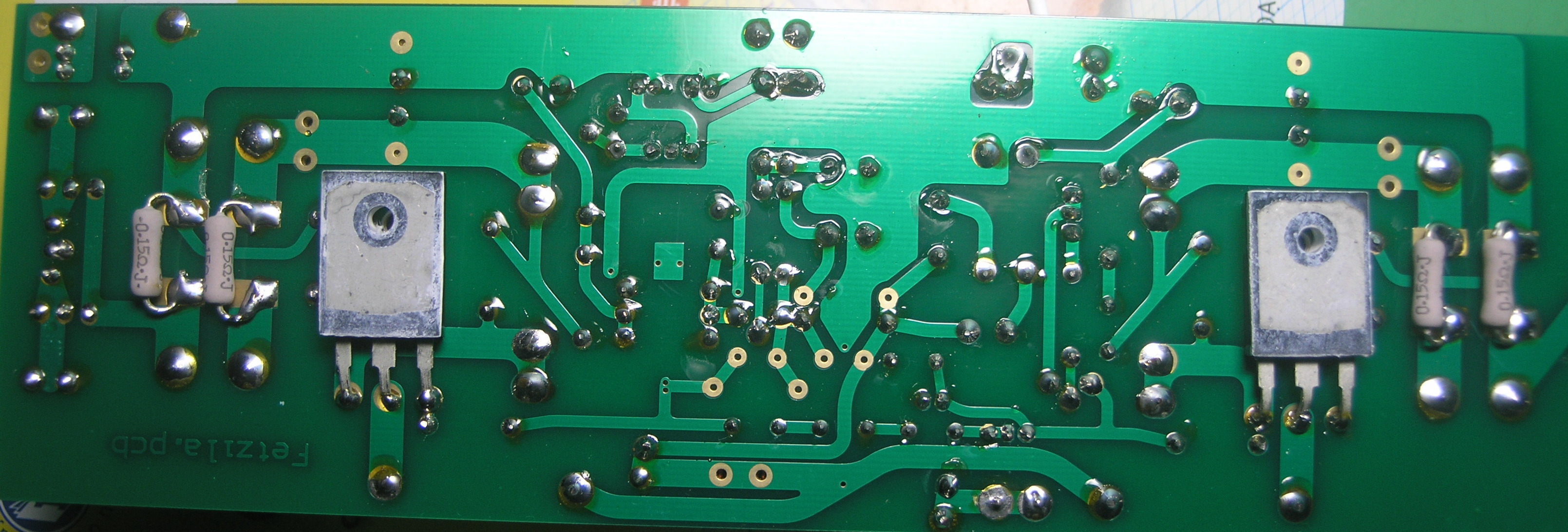

Update :
Had to dril the holes of the middle rectifier diodes on both sides cause they were to small and the middle leg of D1A didn't make connection with the upper layer so a bit solder on the top side problem solved.Me Happy again
MM,
I've just checked the clearance of the rectifier leads in a stock, unstuffed FetZilla pcb.
They are tight (0.9mm) but fit just fine. The fitting is deceptive however, because the holes are slightly splayed wrt the component - you have to spread the leads before insertion.
If you ever drill double sided boards in future, always take care to check you really need to, as they are through plated, and if you do, always solder the component BOTH sides.
This is a trap for newbies.... I've been there too!
Congratulations on a good build. Now to fire it up and start the listening tests!
Hugh
The holes of the middle diodes on both side were realy too small the others were tight but OK.Not a big deal just dril them larger but I didn't think about the upper layer.Just did a check up and the most value thing,I've learned something that's the good part.The casing is almost ready too will post some pics later.

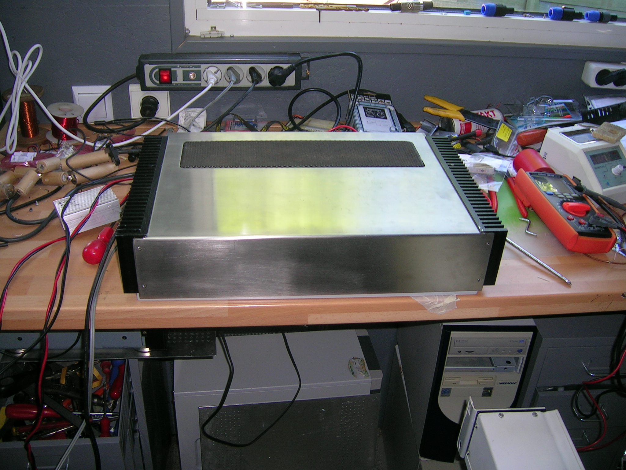

The amp is ready for use and I'm happy with the sound.I'll try to explane how it sounds not easy cause english isn't my native lanquage.First you need to know,for me everthing must be in balance.I don't like the hights are too present but when I disconnect the tweeter I need to say Hé the hights are gone.That's why I love my Blame ST from Carlos so much good bass and for me nice hights and relaxed sound.The test is done with vintage speakers the DM14 of B&W a closed cabinet with two 6,5 inch woofers and a 28mm dome tweeter.And now my Fetzilla compaired with the Blame ST even stronger dry bass regarding to that my opinion is the Fetzilla wants bigger speakers.It produces realy puchy bass.The hights are more present but very clear and crispy but cause the puchy and strong deep bass all in balance.The Fetzilla deserves good flourstanding speakers which can cope the bass of the Fetzilla.Now it's time for a high power Fetzilla,I realy like this amp too and I'm happy building it.
Hope this explaines a bit what I think about this amp.
For someone says he's not comfortable with English you have done bloody well......
Thanks man!!
If the bass is a bit dry and punchy, try this.
Put a 0.22R resistor between the crossover and the BASS driver on both your speakers.
This will loosen up the bass, make it sound huge, but take away some of the dryness.
Then you should have the perfect amplifier with matching speakers!!
Hugh
Hugh,I like the bass the way it is.You just can't believe the bass these DM14 produce with the Fetzilla amp.Maybe I don't use the right words but the bass is realy tight also some of the advantage of a closed speaker.Also planning to build a large speaker system,wondering how the Fetzilla behaves then.The Fetzilla is here to stay.Hugh,thanks for this amp!!

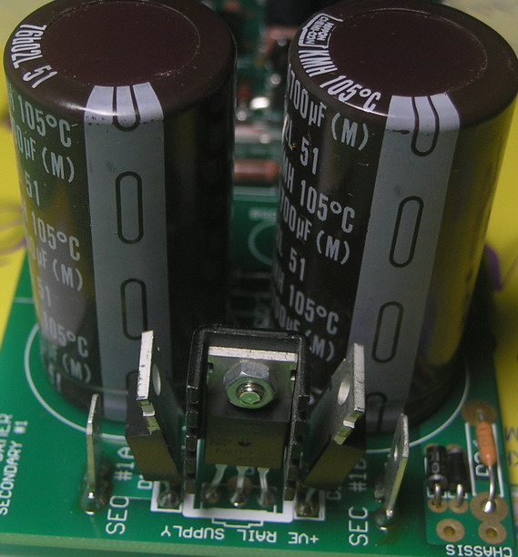

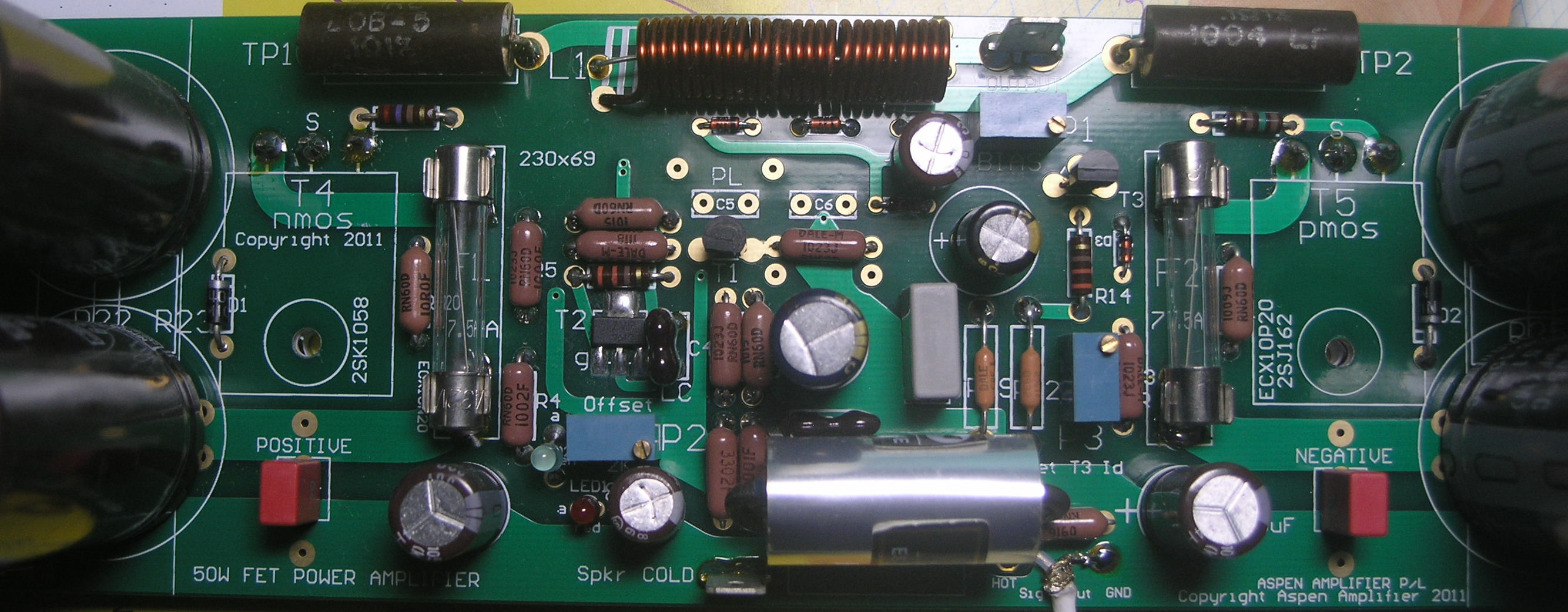

A few day ago, I started building the amp. Yesterday, after I finished soldering everything on the PCBs. I switched on the power, I use a variac and set the (main) input voltage at half (110V)(the transformer secondary voltage is only 12V AC) to see if something go wrong and actualy something did go wrong (I shoud have used a bulb in serie with the amp as someone advised on this topic). After I turned the power on, the toroid hummed loudly and it seemed that I got a short somewhere since I saw smoke come out below the PCB, from the position I came out, It seemed to come from the metal oxide resistors which are mounted underboard, it happended to both channels.
I turned off the power immediately to prevent further damage. I guess that I did something wrong. After that I tested the fuses on PCB and they all intact.
Attached here are the pics of my PCB. Coud you please take a look at them to see if I put everything in correct order.
As you could see, in the power supply section picture. I did not mount the diodes optimally as I soldered them with the metal tab facing in instead of facing out but I only realised it after soldering them in positions. Actually, I tried to separate them and not to let their metal tab to touch each other.
Thank you in advance.
