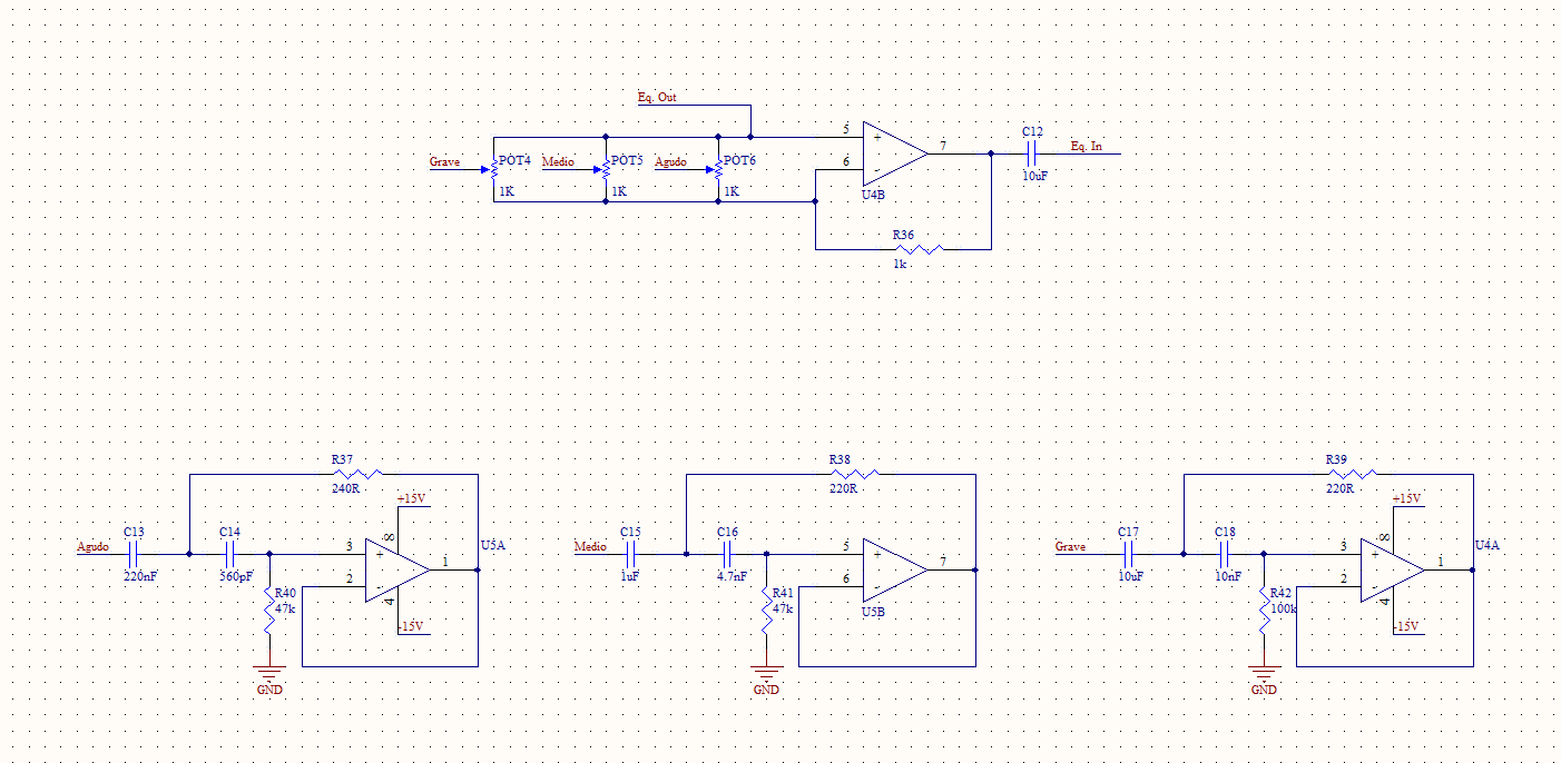

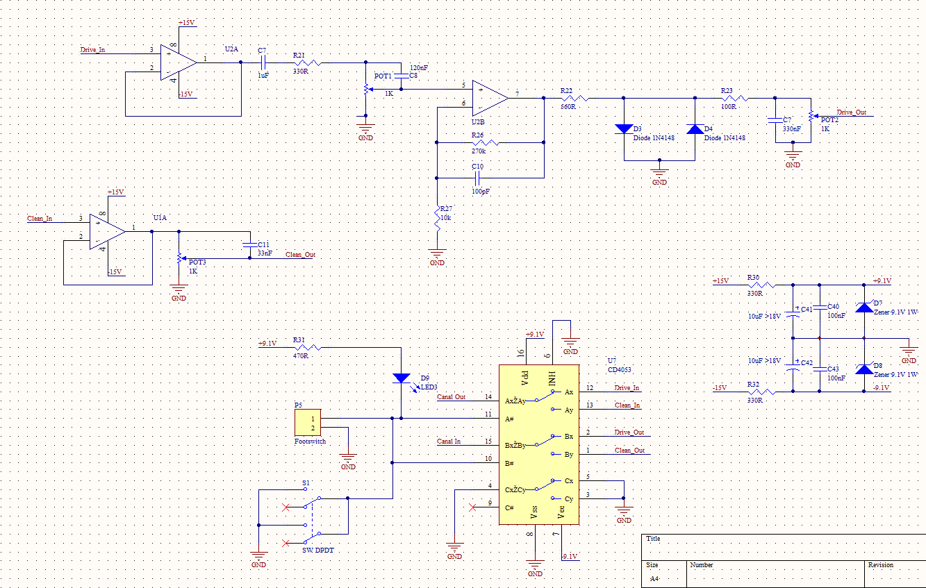

Are the CD4053 control pins 9,10 & 11 really floating?
Actually not. I just simplified the schematic I posted
You should never do that. If we cannot trust you that the schematic you post is actually what you built, all bets are off. It's often these 'that doesn't matter' things that are the culprit.

I wanted to make it cleaner for the JFET part

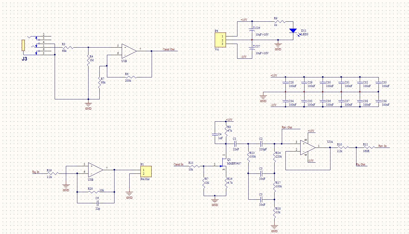

It does seem kind of unlikely that FET would oscillate like that, its transconductance isn't all that high and that much C should take out its steam. I assumed you probed around while it was making ugly waveforms, to see whether the pulses show up on the power supplies? (And are you by any chance using low-dropuout voltage regulators?).
Also look for places that cause output changes when you probe them.

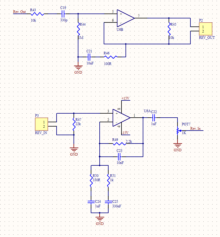

Problem solved guys!
Wel... it wasn´t the fet...
And by simplifing the schem as I did you could never find out the problem.
Just after the fixed equalizer I have an output for the spring reverb circuit. As the reverb tank wasnt attached, for some reason this circuit was oscilating in a high frequency. I would never guess that was coming from there... So I keept the hipotesis of the fet...

here is the final full schematics of this guitar pre-amp.
And its official, surprisingly this amp sounded better with a class D power amp than with tubes!
Cheers guys!
Cheers guys!
Very cool, glad you are happy with it! BTW you are thinking of cascading fets for drive, I would suggest simply substitute 2 fet stages where the diodes stage is. Your drive pot would need increase to maybe 100K, or 500 K, and you have a buffer op amp after that for drive. U2b would have no problem pushing fets to saturation, cutoff or wherever you set them. I have to resist the habit of biasing fets the ''right way'' as for audio, for guitar I find that biasing them ''badly'' usually sounds better! ;-)
That is what bugs me about ROG putting them at 1/2Vdd all the time.
