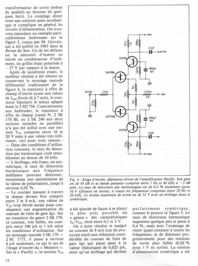

This is from a French design, the "Pacific" (magazine Maison de l'Audiophile).
The input stage was meant to drive a PP EL84 output stage.
It runs on some +/- 80 volt.
Very good design; will make a fine sounding amplifier.
When reading French is no problem I can post a link to the complete article.
