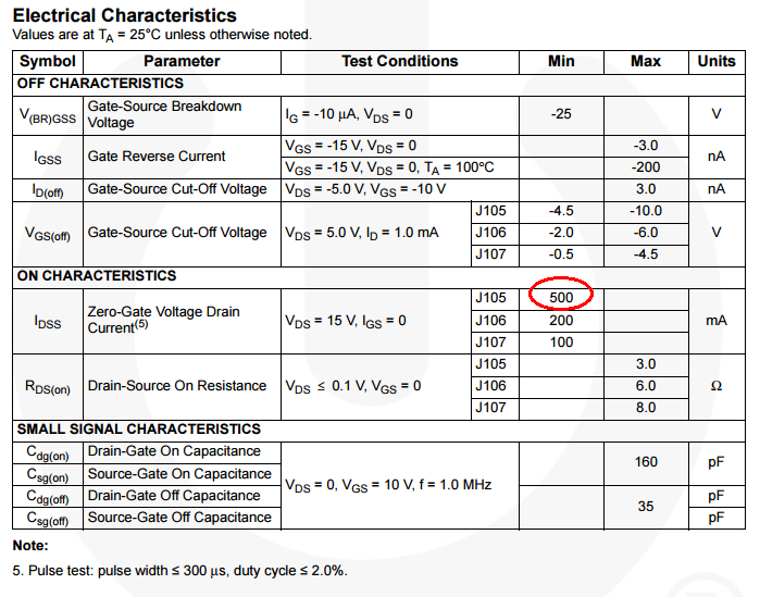

I measured a Fairchild J105 JFET (link to thread) using an oscilloscope and two $0.25 ICs on a solderless breadboard. Measured Idss was 1.10 amperes on this particular J105. I decided to use pulsed measurement techniques with low duty cycle (68 usec on, 330 msec off, 0.02% duty cycle) to avoid overheating.

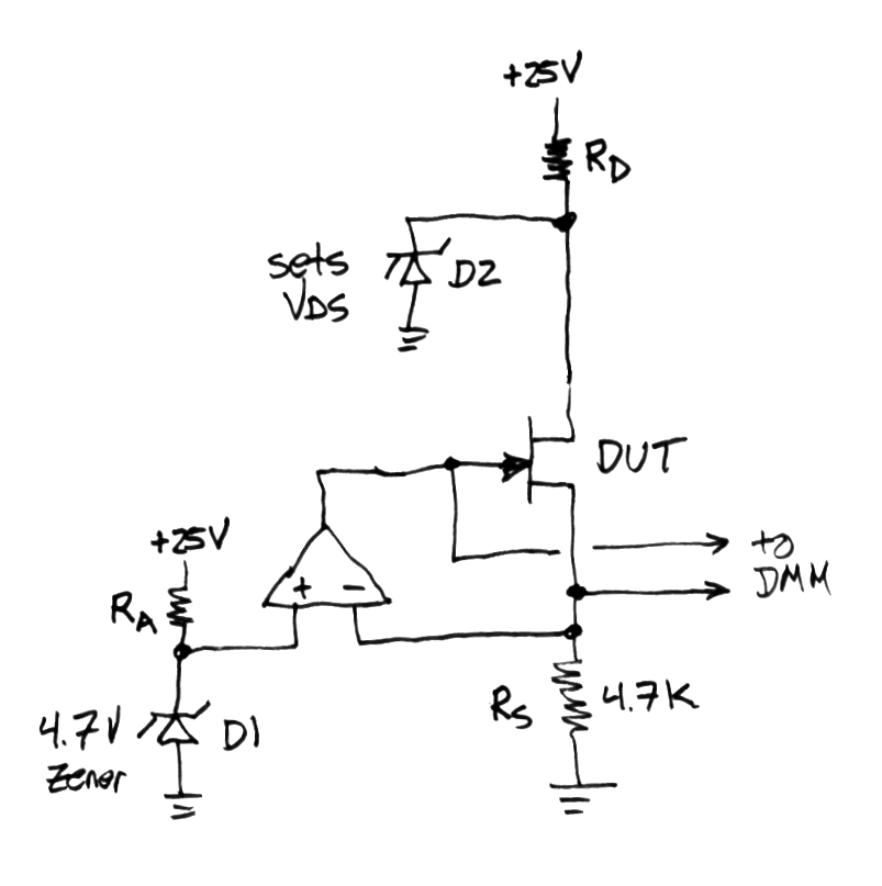

Joined 2011
Opamp + NFB ensure that the source voltage equals the zener voltage of diode D1. Then the current IDS equals Vzener/Rs. I've set that to 1 mA but of course a TL431+trimpot instead of D1 would permit adjustment. A rotary switch to swap in different values of Rs would be nice too.
The source voltage is VzenerD1 and the drain voltage is VzenerD2 so VDS is just the difference between the two; choose D2 to get the VDS you want. Or make D2 a TL431+trimpot and now you can adjust VDS smoothly and continuously.
One power supply, a single opamp (RRIO not required), and two zener diodes. Small and simple. I'd recommend choosing the OP-07 due to its extremely low cost and good input offset voltage specs.
I'm not too fond of current regulating diodes, they seem too scarce, too costly, and their tolerances are looser than I prefer.

Opamp controlled current source. Good solution. :)
May I suggest a protection diode from opamp out to DUT S, just in case D is not properly connected during DUT swap?
And maybe a 1k gate stopper after the anode.
CRDs are not expensive in Asia.
Of course you can always make one from a 2SK209 with a source resistor to trim current.
Would not take 100V though, as a E102 would.
