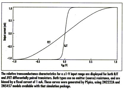

I don't understand. This S curve...what are its axes?FM distortion is generated by the non-linear S curve that exists WHEN you want BOTH low noise and a bipolar transistor input.
Could you be more specific? Are you talking about phase modulation due to the non-linear transfer characteristic of the bipolar transistors in conjunction with their junction capacitances, or something else? Why is this different for FETs which also have non-linear gm, albeit a lower order distortion, and junction capacitance?Degeneration resistor free bipolar input stages have a significant amount of FM distortion, unless the open loop bandwidth is very, very high, or the gain bandwidth is very, very high.
Please contact the Walt Jung website for further information. Specifically, the link to Barrie Gilbert's articles on op amp design.
If an individual does not understand that the distortion characteristics of a differential bipolar transistor pair maps like an S curve, then I recommend some beginner courses on transistor theory, perhaps from an internet course before going any further on this topic.

please point to the spectral components that support the claim that degenerated bjt has higher order distortion than the fet diff input
also note that the the loop gain is integrating for both examples so we expect that (and can see by) the spray of multiple sidebands evidence that the primary distortion is in fact "FM distortion" and is present with both fet and bjt inputs
it sure looks to me that degeneration has reduced "FM distortion" very effectively in the bjt example
jcx, you make a good point. I cannot say that a jfet input is really lower distortion than a degenerated bipolar input with the same effective Gm for the diff pair. I haven't added the weighting factor of N(squared)/2 or (N-1)!/4 which are common weighting factors for higher harmonic distortion.

John, by "S" you mean tanh function of transconductance of long tail bipolar pair?

Thanks for answering my question, PMA. These particular 'S' curves are more formally known as the tranconductance curves for the two input types. Nothing new here. But how about this claim of FM? What's the rationale behind this? Assuming this acronym was intended to stand for frequency modulation.
http://web.archive.org/web/20010821120135/http://www.edtn.com/analog/barrie4.htm
