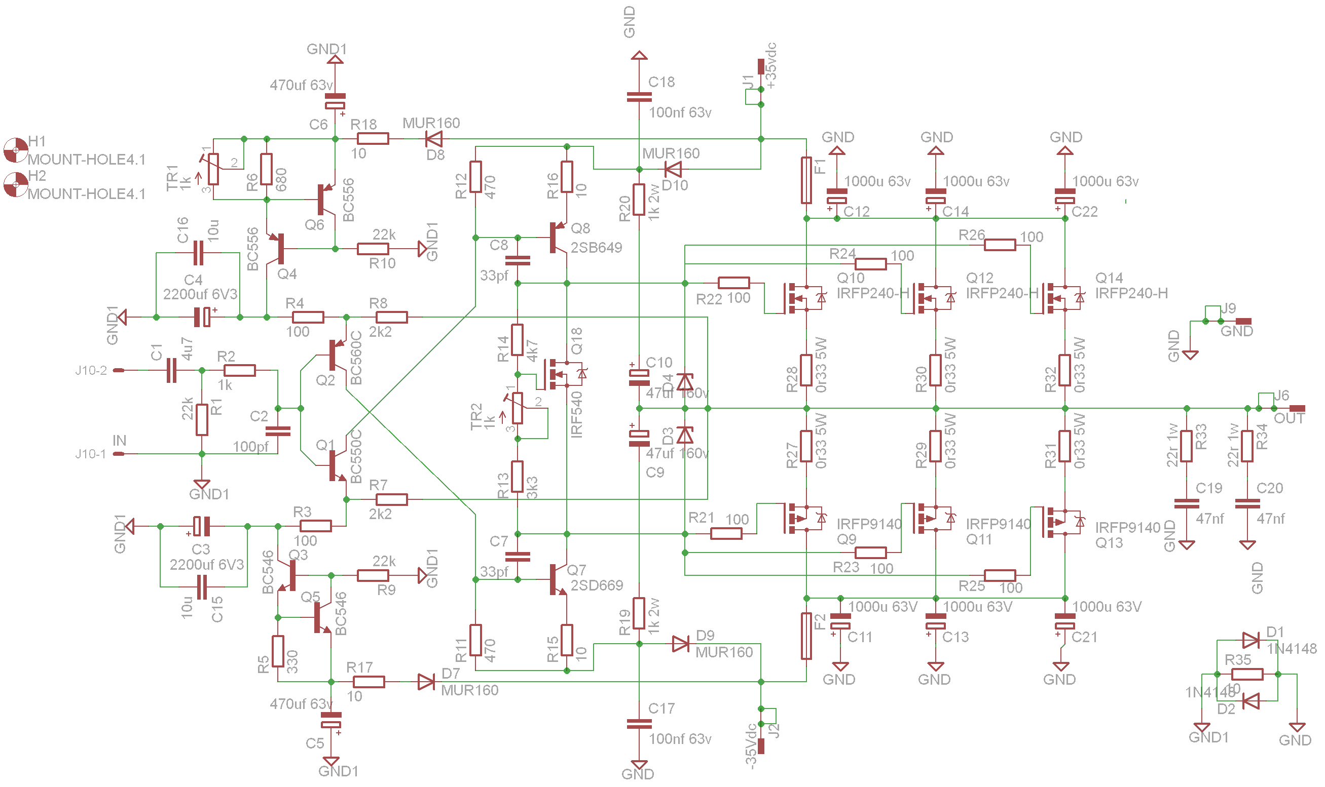

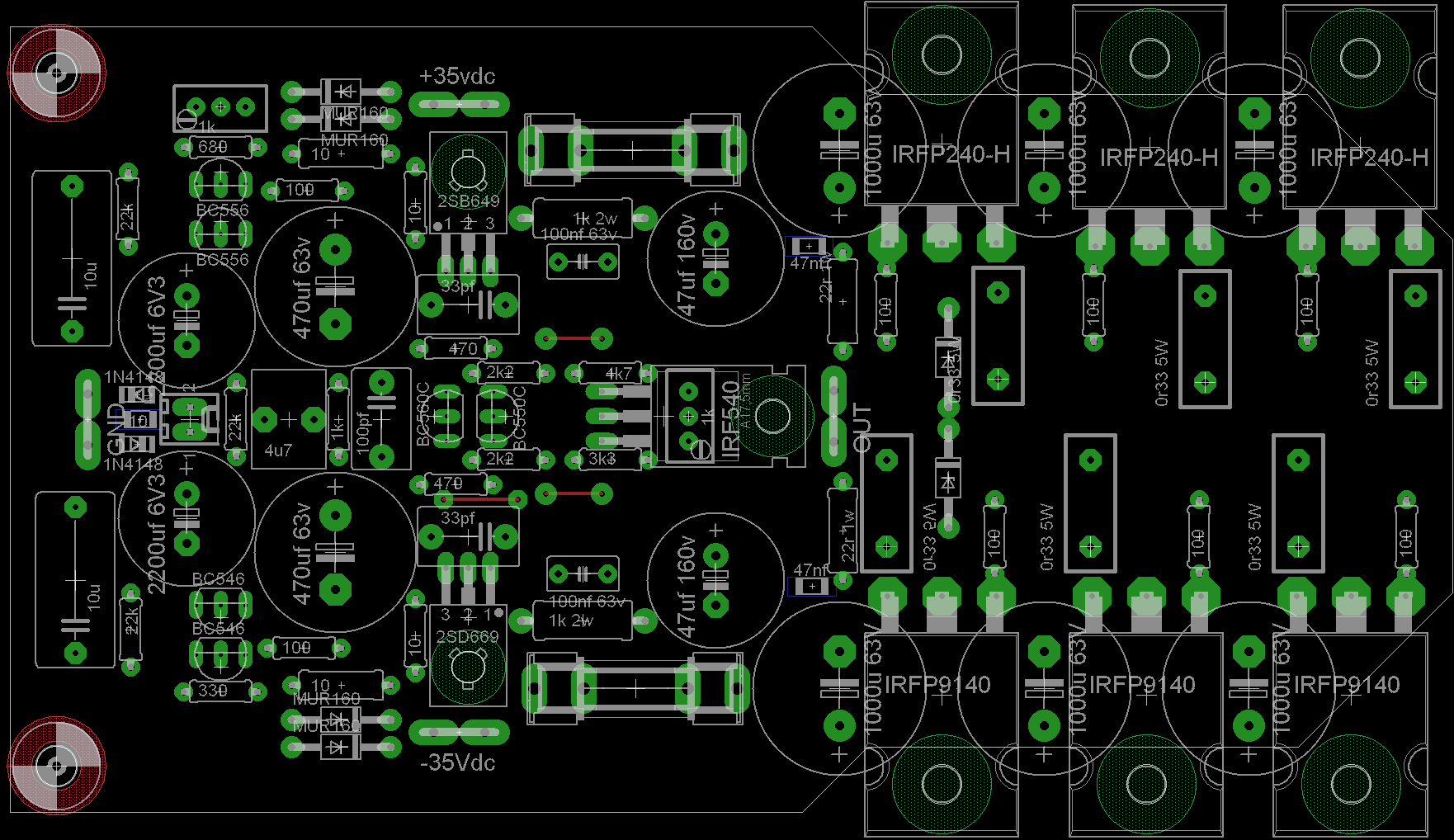

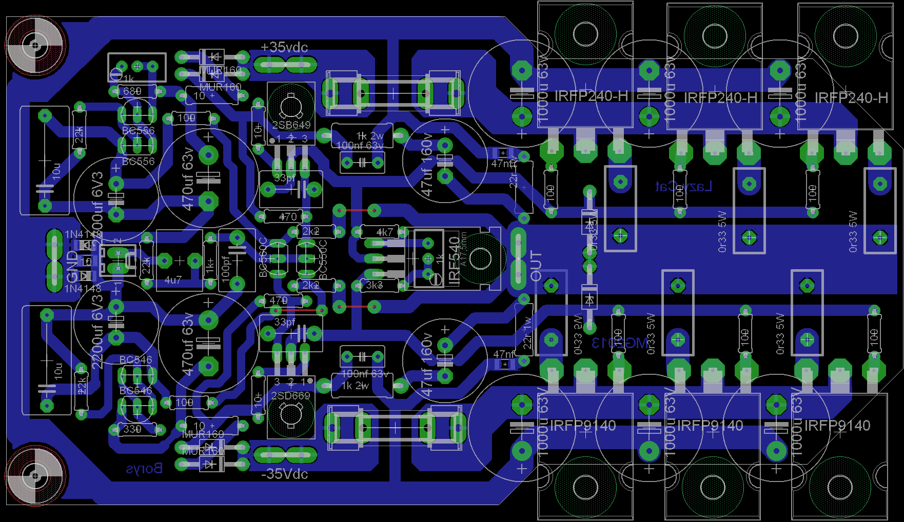

Under BG2-3Hexfet layout with arragement...probably near to final layout...
Marc

Thanks for the tick BYRTT, i just try by falling down the bias from 100mA to 50mA and that's it. The sound change as a veil has been taken of...surprinsing thinks is that affect in good way the bottom end to by clearer drum...really fantastic yet.

Hence, 50mA would represent a more optimal bias current for this Class A/B amp; 100mA might be over-biased Class A/B.
I am saying this so that the notion of lowering bias leading to better sound, does not become a generalization. In fact, in most cases, the converse is true.
It seems to me that Borys tried to emulate VSSA Lateral Mosfet circuit so he first tried similar bias as used in original circuit. For the BJT circuit a much lower bias will give excellent results. Let me remind you all that in Cyrus iii circuit, which is blueprint for SSA circuit and it's derivatives, bias is:
Output transistors: 10mA!
Driver: 5,5mA
Pre-driver: 4,3mA
Since triplets are used in outputs and high current was not demanded from VAS transistors, VAS transistors used are small signal SMD packages!
