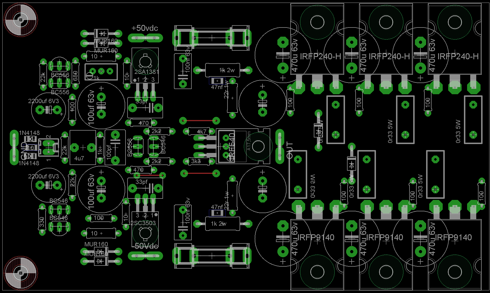

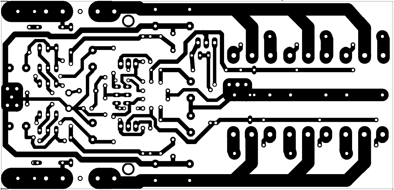

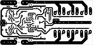

When I use Iron transfer that is not so precise than photo resist method.
For that between some traces, transistor leads need a bit more room.
Otherwise does not come out well or nice.
Nothing wrong with your layout, actually very good if you use photo transfer or other better solution.
For iron transfer need some minimal adjustment, I know (out of experience) I made over 100PC boards in that way.😉
I need to take your layout into the paint program and do those adjustment necessary for Iron transfer.
From PDF I can't take it to pair program to do the mode I need, Otherwise I have to redraw all the layout by hand how I used to make my PC boards layout.😱
That is way too big job, takes several days to draw by hand in the paint program.
I didn't tested the darlington yet, I have to purchase that darlington and some other parts for my test board..
I want to test several semiconductors (power darlingtons and drivers to).
Greetings Gabor

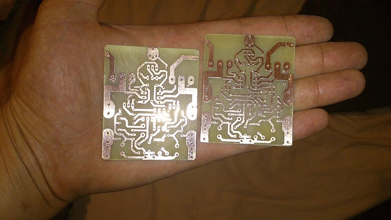

I am doing exacly the same - thermo transfer with hot iron. Even small thinks are going ok.

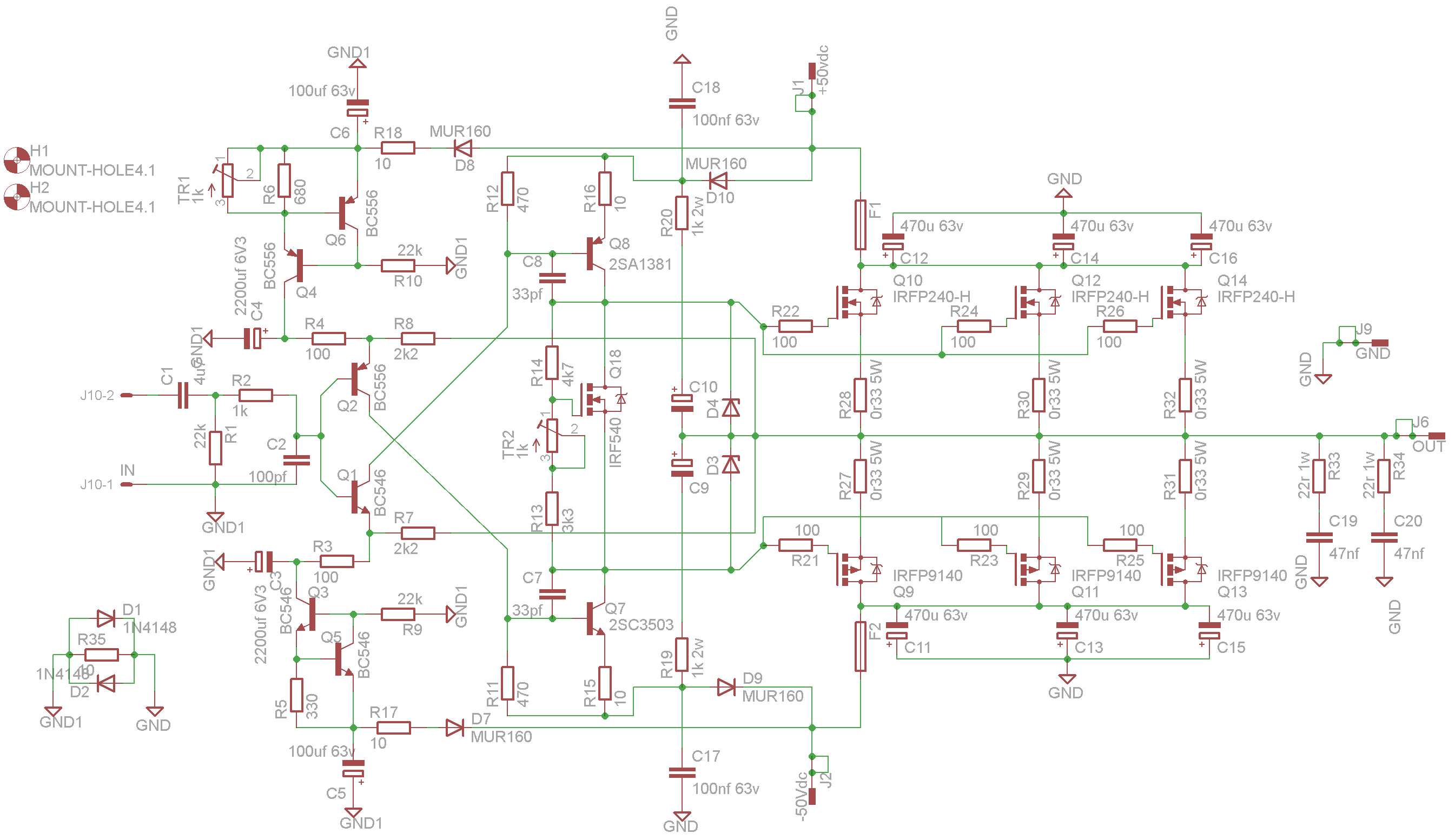

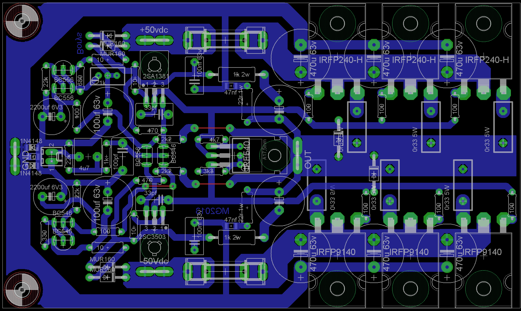

I gabor i have the same goal but +/-50vdc with 3 pair 240/9240 as i have good matched spare. I am on Eagle session for layout.
Marc
Marc
Marc
First try out....Board size is 144x85mm
Marc
Edit : KSC3503/KSA1381 must be swap to 2SD669/2SB649
