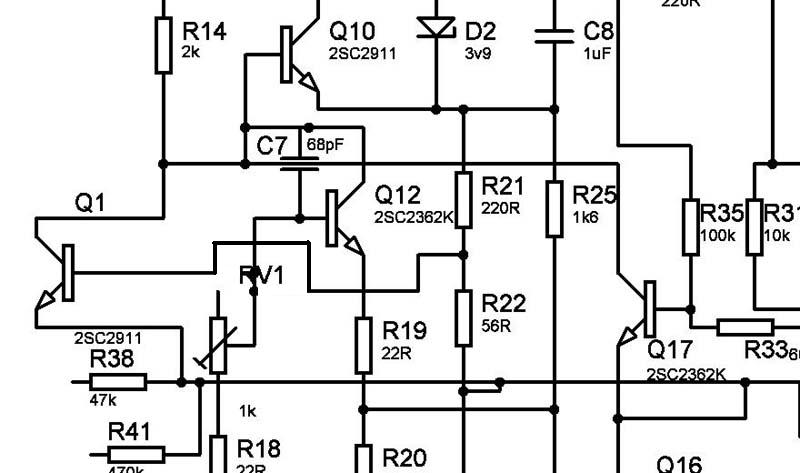

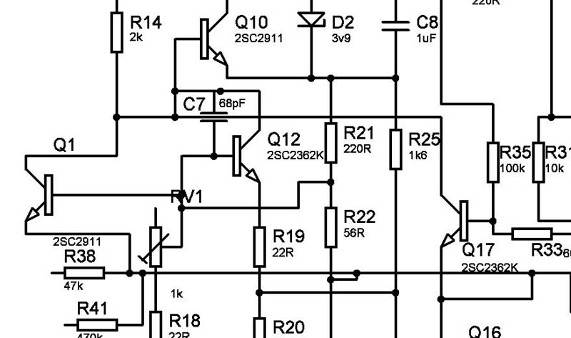

Hi, Russel,
For ordinary power amp, we can easily arrange 2PS to overcome drops like Upupa Epops said. But there is a serious problem if we try to use 2 PS for error correction type amp. Assume we use +/-70V for front side while the output stages are +/-50V. Both PS have to turn on and off at exactly the same time. If not, while the output is tied to speaker, the drivers around the VBE multiplier/VAS will be burned, because the final stage acting as Diode connected to the speaker.
Since EC have better efficiency with 2 PS, I still dont know how to arrange these 2 PS safely. Do you have an idea how to use EC with 2 PS?
Try using an arrangement as in the diagram, if you add T1 as shown both FET and driver aill have there own current limits. Obviously the lower half needs a PNP transistor in its appropriate postion. If you need more current make up the 56 ohms with two resistors, the bottom one setting the current limit.
