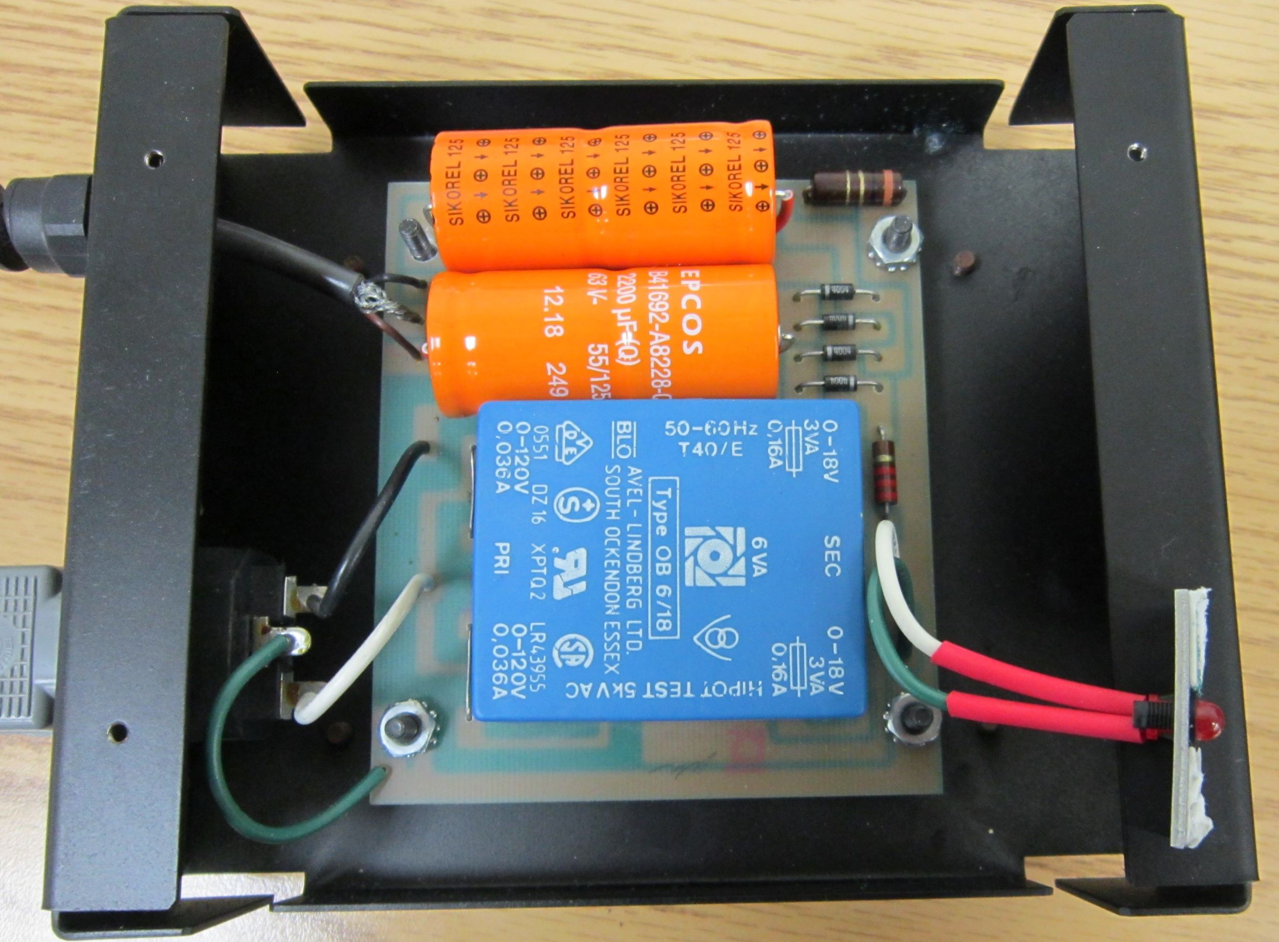

Put Power Supply on Voltmeter and Oscilloscope, to attempt to get a fairly accurate evaluation of the condition of this "oldie but goodie":
V+ = seems OK, nearly flat output at about 29.8 VDC
V- = seems OK-ish, about 31.8 VDC with around 40 mV of ripple on it (iffy cap?)
I assume that the secondary regulation should handle any difference, but before attempting that, I'm going to replace the Power Supply Caps (they're arriving 2-day!)

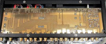

Does anybody have pics / layout drawings of the FET-9 "Plain Jane" version that show component names/numbers and what Voltages / Signals the various standoffs carry?
(MY version does not have the 20-pin connectors between the Mobo and the Phono / Line-Stage Board. Gold-Plated stand-offs, washers, and Allen-Key screws are used to carry Voltage and Signal between the boards.)

Replaced caps in separate Power Supply and Output Voltages remained about the same.

I KNOW that there are Trimpots for fine-tuning the Regulated V+ & V-. The Service Manual specs what to set these at, but my copy does not show WHERE the Test Points are for this measurement. A semi-educated guess would dictate seeking and checking 3 of the Gold-Plated screws / stand-offs that are used to carry Power & Signal between the Phono/Line-Stage Board and the Motherboard, (logically, 3 of them on the end nearest to the Power Regulation Section) but it would be nice to know for certain which are which.
(There are about 16 such cross-connects and I can make some logical assumptions about what such connections SHOULD be “present”). I believe that I have schematics for the FET-9e, which uses about 6 separate modules for Regulated Power, Line, & Phono in L & R pairs for each, and uses 20-Pin connectors in place of the plated standoffs & screws that are used on mine, but I am certain that the circuits are still VERY similar and I CAN draw some logical parallels between that one and mine. (Mine pre-dates the Op-Amp-Based Servo Control biasing circuitry shown on the more modern “e” model.)

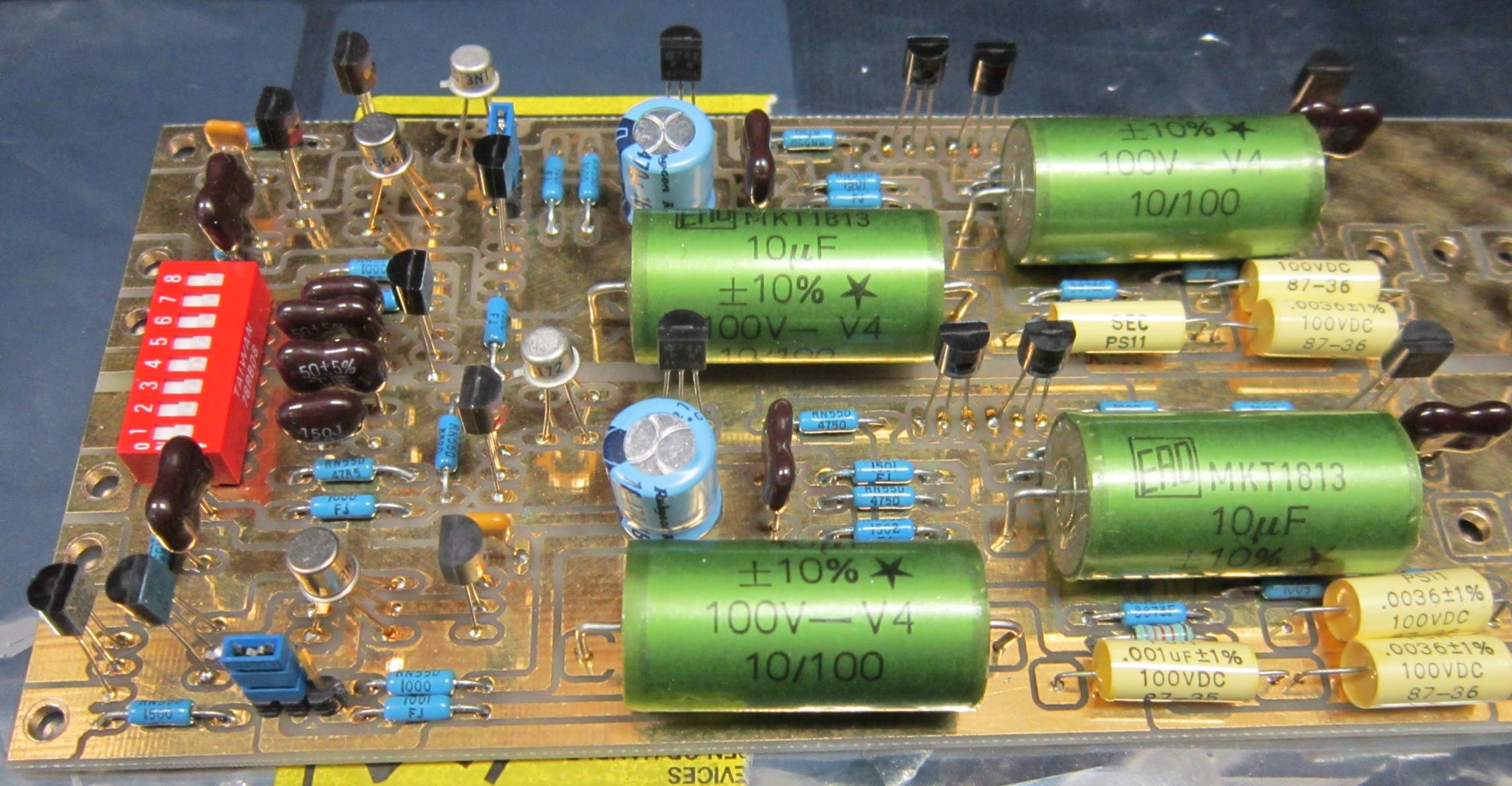

One last item about the Electrolytic Caps for this unit:
-I know that Nelson Pass has recommended ELNA Silmics (Silmic II)
-However, it seems to be difficult to find these in the proper PHYSICAL size and Voltage for my unit
(Checked both Mouser & Digi-Key, and Newark)

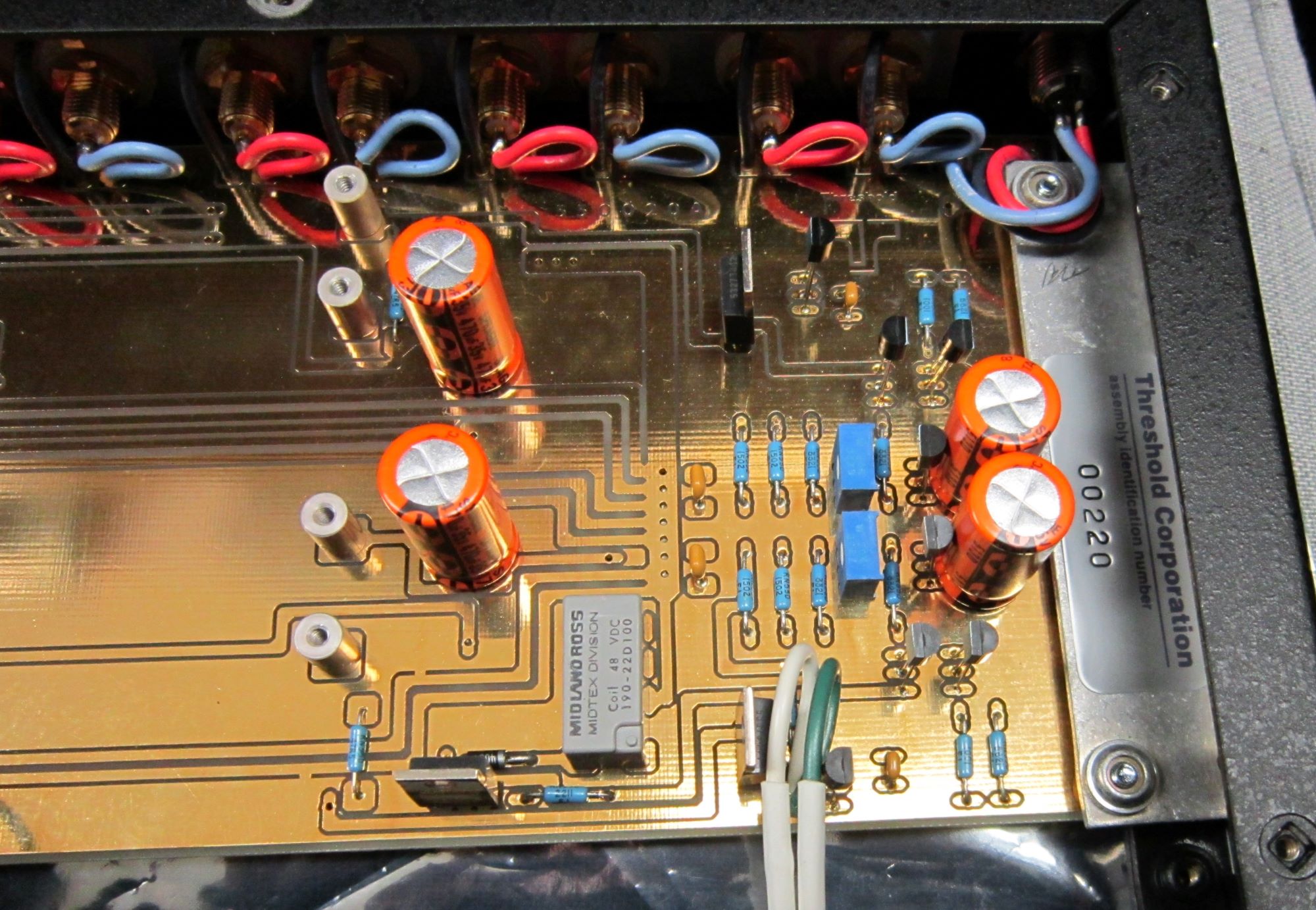

-The 4 470uf Caps on the Mobo are hard to find in the shorter 35V version
(There may be room to “lay-over” some slightly larger 50V ones on their side that I got before realizing that they are too tall by about 7mm)
-The 2 “shorties” 470 if in shorter still 25V version
I want the replacements to be DURABLE, so I want sufficient Voltage Margin (rating vs applied) plus best Service Life available. What are thoughts on Nichicon KA series, which appear to be relatively new, and have higher temperature and service life ratings, while also being intended for Audio applications? I know that Nichicon has a good reputation for quality and this series seems to be more readily available in the sizes that I need.
Mine appears to be essentially the same as the one that renehc posted
See previous thread “Threshold FET Repair Story”
(Same orange Mallory caps in Power Section and blue shorties at Phono end of upper PCBA = the end with the DIP switches for Cartridge Loading...)
Mine has S/N 220, so I would guess pretty early production

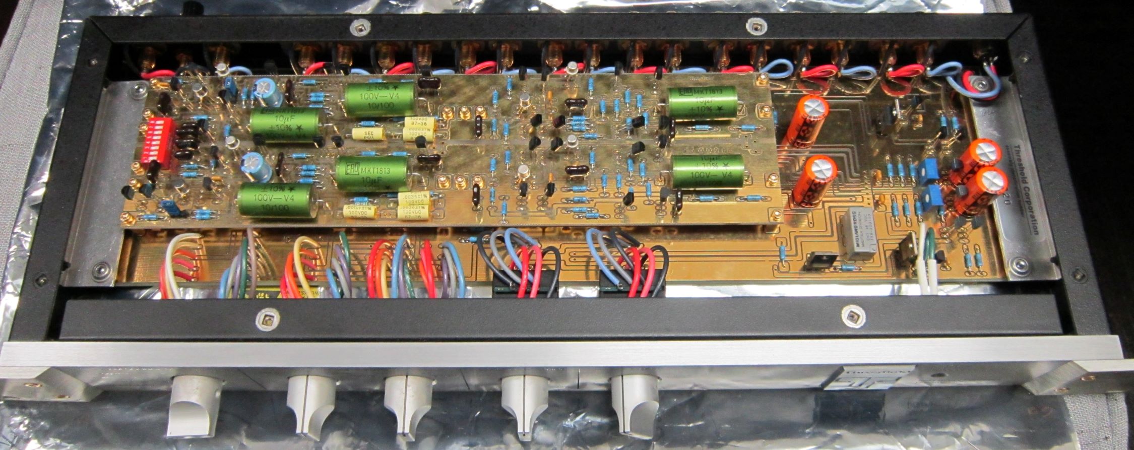

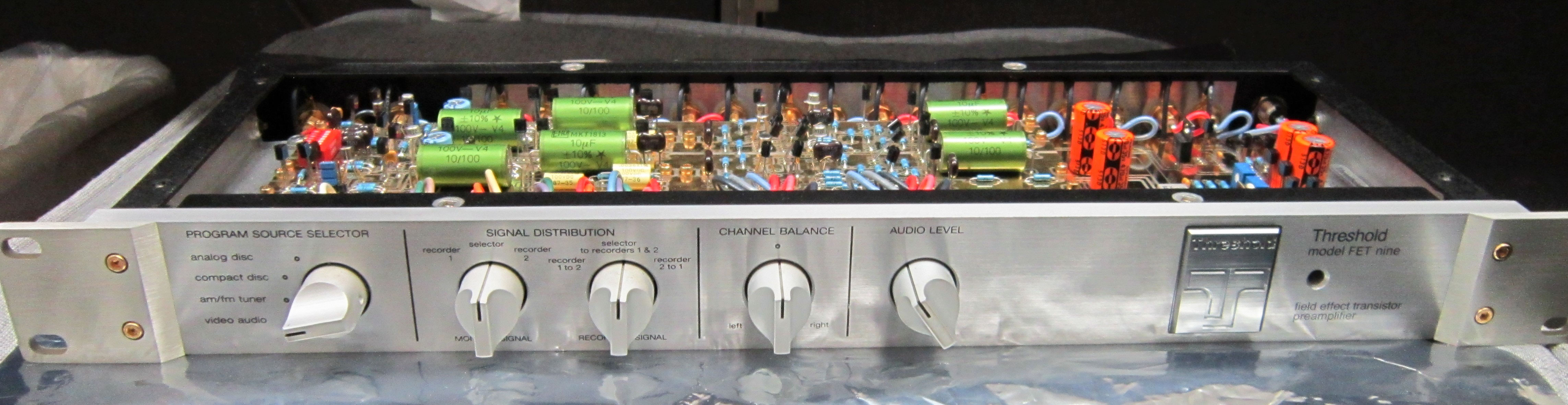

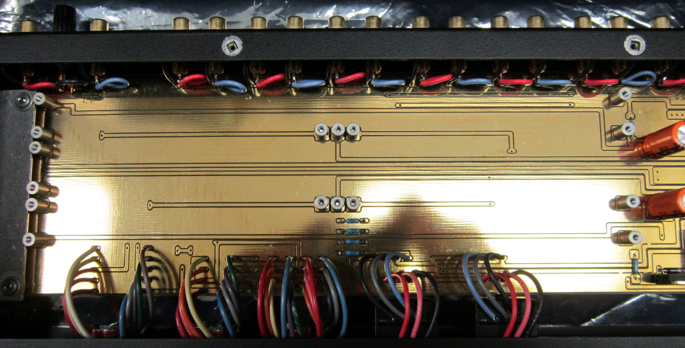

PICS FET-9 1st-Gen (Non-"/e")
OK - I shot a bunch of pics in an attempt to capture both the whole thing and the major parts.

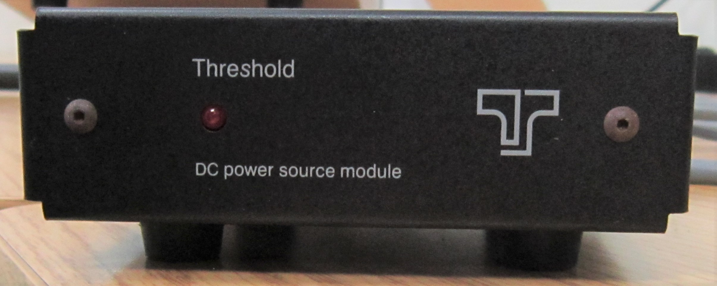

This one has the original "extra-wimpy" Power Supply (Already re-capped)

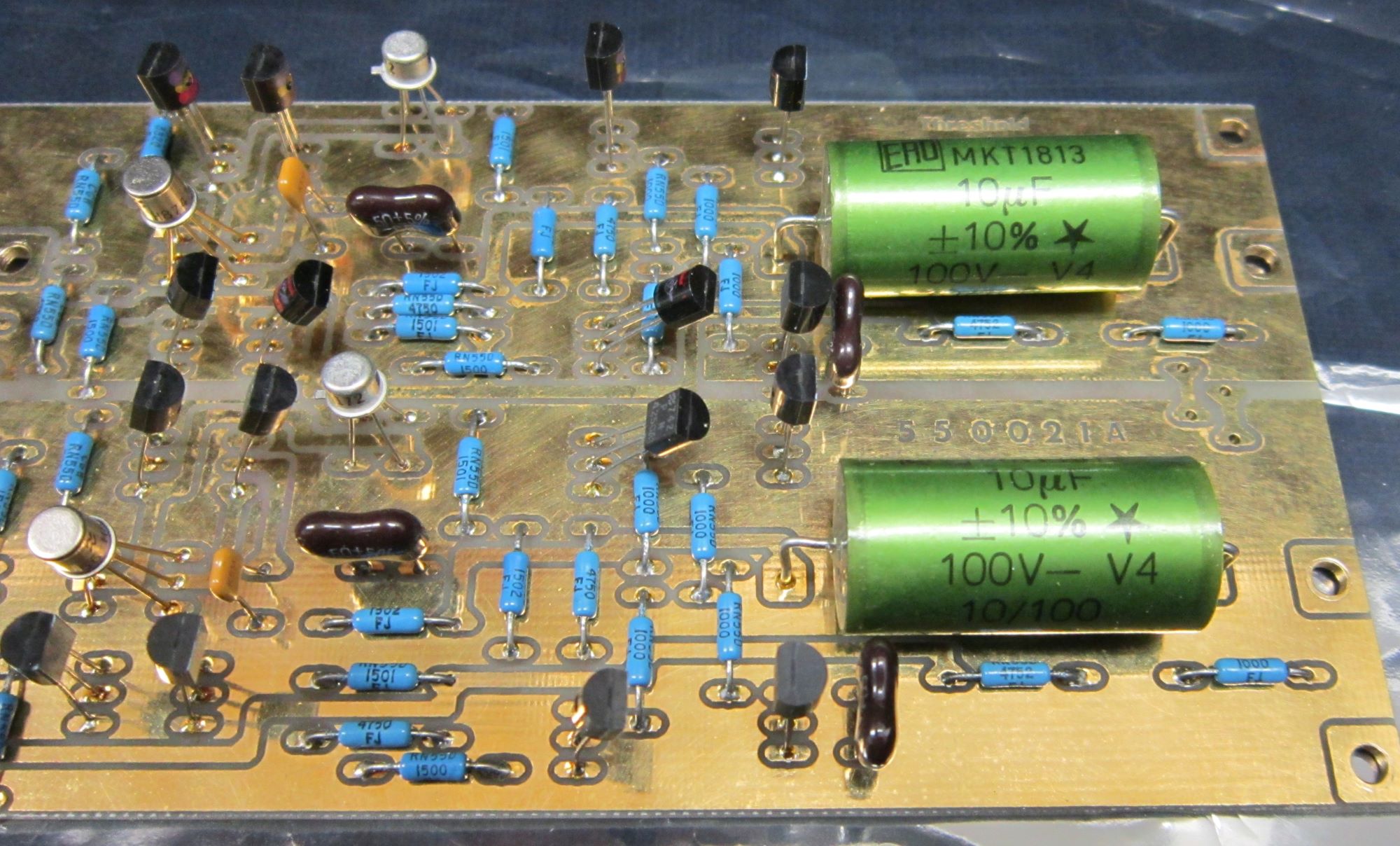

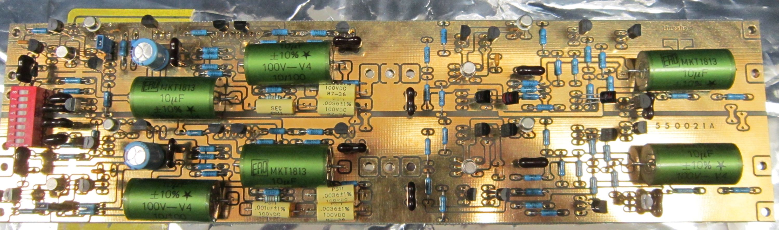

As you'll see in the pics - this version does not have separate daughter cards for power, line stage, and phono.
-Secondary Power Regulation is on the end of the Mobo opposite from Phono
-Phono and Line-Stage are combined into a SINGLE Circuit Board Assembly
-Connections between the two Circuit Boards are via (16) gold-plated stand-offs
I Have not replaced the Electrolytics on either of the main unit boards yet.
How concerned should I be about attempting to "Match" Capacitors in equivalent positions for L&R and +V&-V? (I figure that in the least, it cannot hurt to try - but all that I have for measuring the caps is a Fluke 115)

Here are the pics:
It’s ALIVE!
Fired her up for the first time yesterday.
(Have not tried the Phono circuits yet - maybe tomorrow.)
