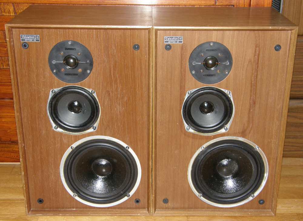

Another valid solution is the Classic 3 way. A good friend of mine likes the Celestion 22:
