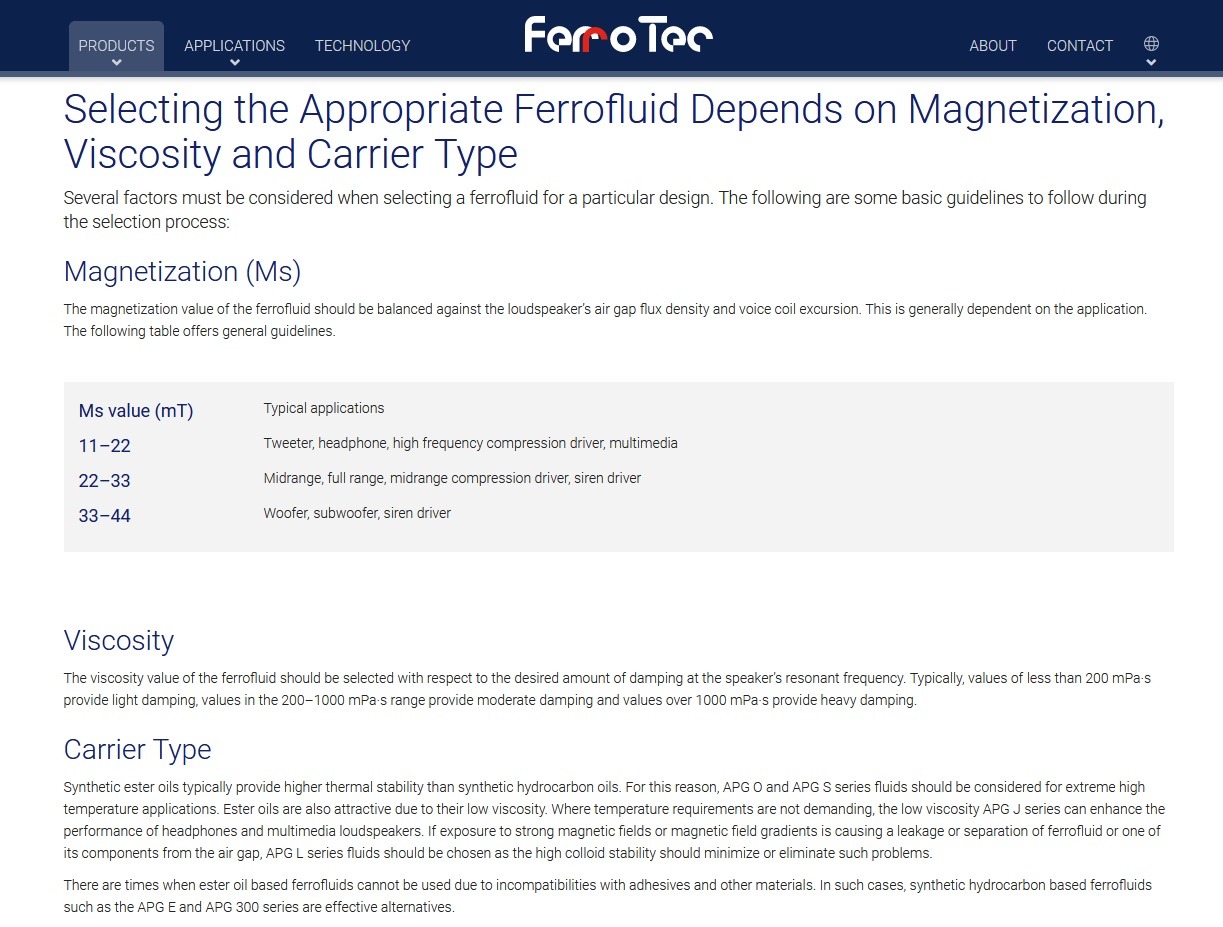

Thanks to you both for the help and encouragement.
Just glancing at Ferrotec's web page shows that there are so many variables, it mightn't be wise to buy some off-the-shelf generic vial from one of the non-specialists in the retail market, without knowing what's in the bottle.
Once I gather more knowledge on this subject I might reach out to Ferrotec if I do indeed need an "oil change".
Thanks again.

Also hoping to know if age or frequent useage(or both) either degrade or destroy the ferrofluid
& what's needed to restore original tweeter spec's, vs replacement.
...Any help or guidance is appreciated.
I bought my D28/2 19 years ago 2nd hand and their condition is unchanged. There is no signs of any abnormal performance.
You will learn what a factory condition of this unit should be like if you check datasheet, FR and Impedance especially.
Ferrofluid increases power handling by taking the heat away from voice coil to the surrounding structures, damping
the resonance peak (cca.900Hz) at the same time. Impedance of such unit is about 10 ohms at Fs. FR at defined drive voltage
should also tell you if it works alright. Do these 2 tests, and you will know for certain.
