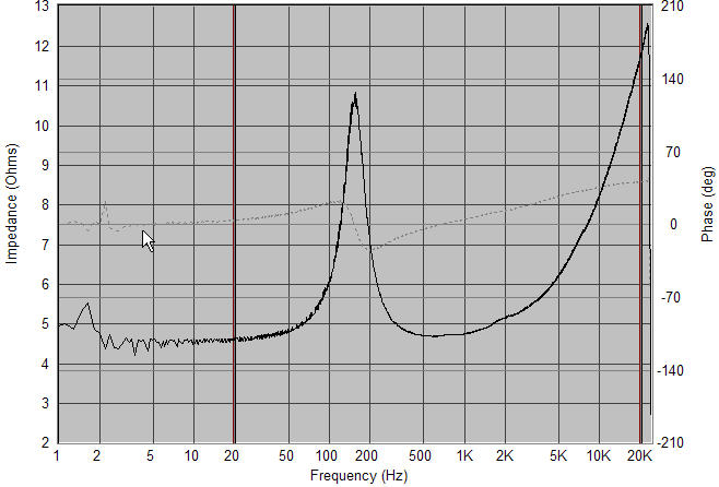

I normally test many times to mak sure I get consistent results, eachg test runs about 5 seconds, but do not intentinally warm them up. The ferro ones normally come up with impedance curves that look like they were created using a zig-zag stich.
I suppose there is some fluid dynamics taking place in the gap that may cause that. At certain frequincies It may be more difficult for the ferrofluid to get out of the the way of the former as it moves up and down. Is there any way you could post a curve? I think I know what you mean by the curves looking zig-zag but I want to see if I am thinking of the same thing that you are describing. I am going to look into some of the drivers at my work and see if ther is a correlation between ferrofluid and the jaggedness of curves.

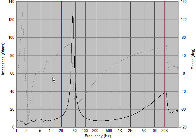

This is a non ferro.
