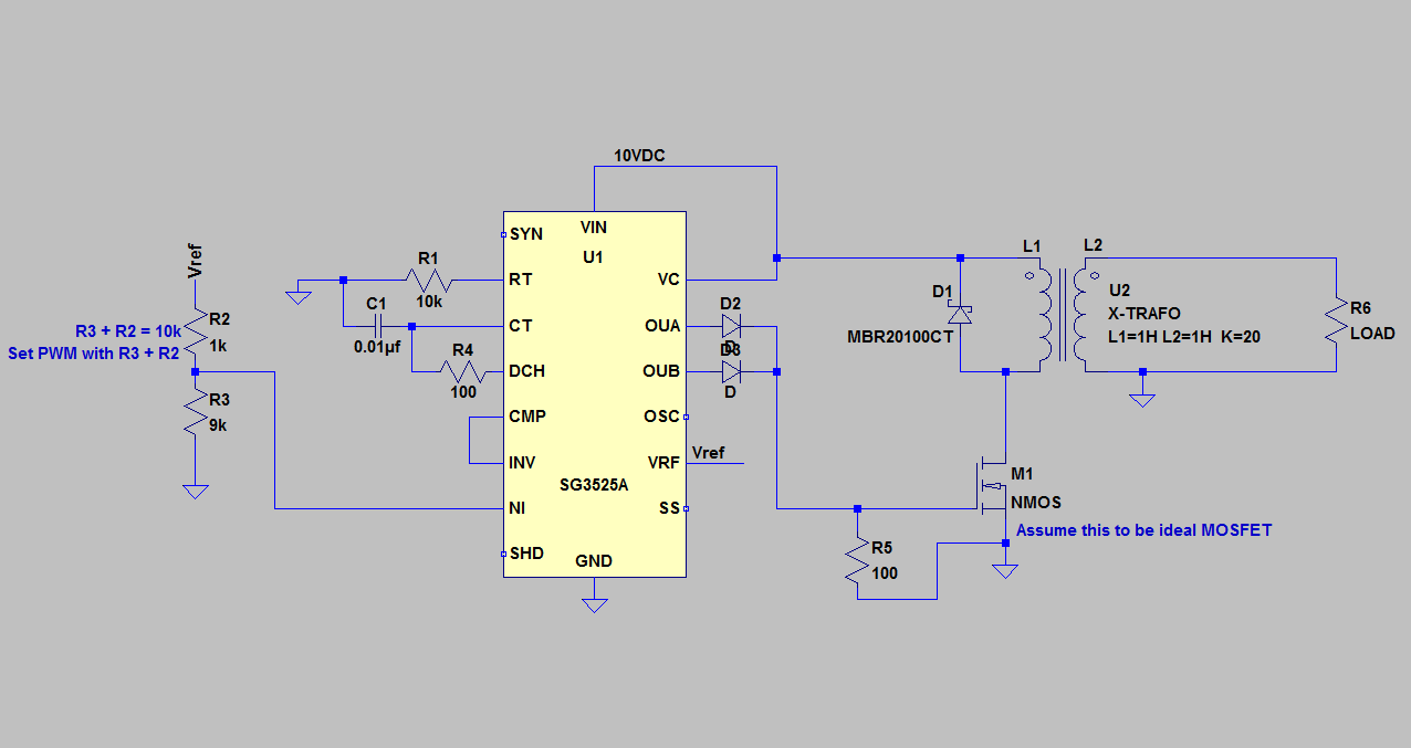

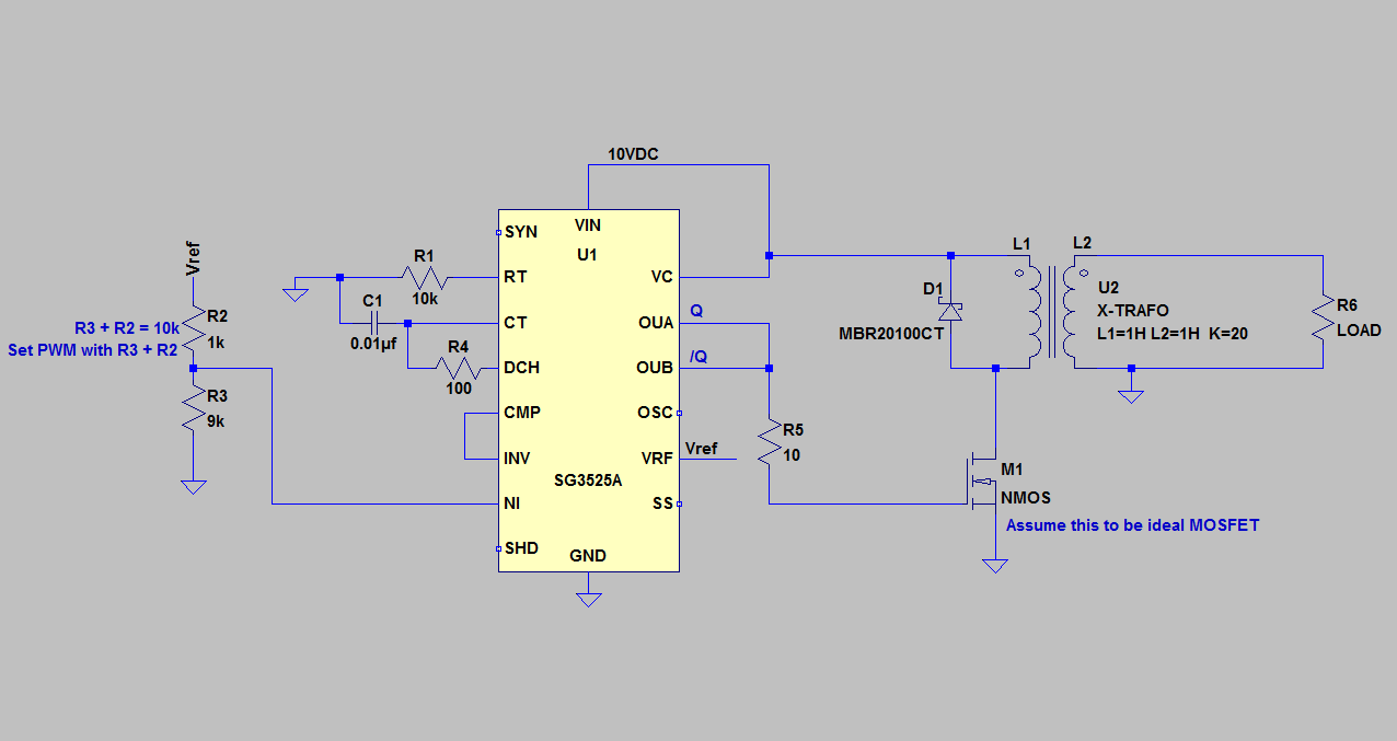

ok lets hold this for a moment. lets not consider this whole microcontroller based design. I will put a simple schematic based on sg3525. this will have a pot to vary its duty cycle. give me an hour.
Here is a diagram.
so to simplify lets just follow this diagram. ( even keeping bridge conf aside).
please guide me how do I go with this.
Vin = 10V.
Vout = 100V ( peak)
VA = 100VA.
as you said before considering losses to be 20% lets say VA = 120
so current is 12Amp.
Sir, guide me for next.

OK.. so what you have drawn won't work for a full bridge. You have more of a forward configuration (though that would need a demagnetization winding).
Take a look around and look for a full bridge schematic and then at a forward. We'll then discuss what might be the better approach and the pro's and cons of each.

Yes Tony I agree, What I have drawn wont work in full bridge. yes its more of forward configuration. for fullbridge the reverse supply works to give demagnetization. right ?
also tell me is the 55% OFF in dutycycle used to self demagnetization ? did I understand it right ?
