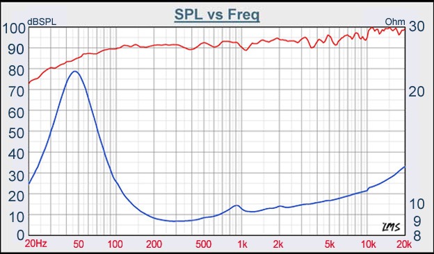

Even phase plugged 8" full rangers peak or lift in that region usually, standing waves of frequency versus diameter stuff maybe also.
check out the w8 1808.

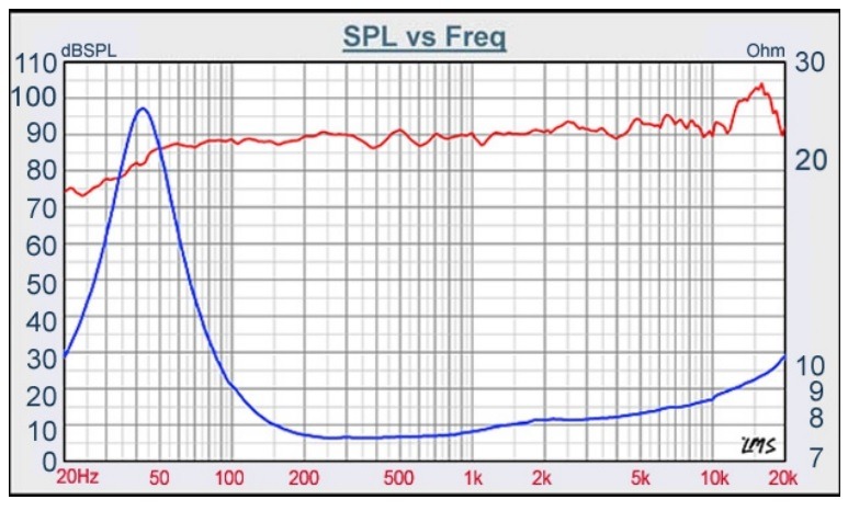

And the 2145 (below)............
notch helped on the 2145.........
Without it, Adele is too nasaly..............

They should make scale zero to 1000dB and both responses would be perfectly flat.
Reactions: 2 users
Don't ya' just love how the FR community easily sidesteps those god-awful SPL graphs? The noted Seas FA22RCZ driver in those graphed examples...running at 45 decibels at 8600 hertz, then climbing to sixty decibels by appx. 14K hertz...a "hissing tweeter" with that...a sawblade toothed response, it's just all bad.

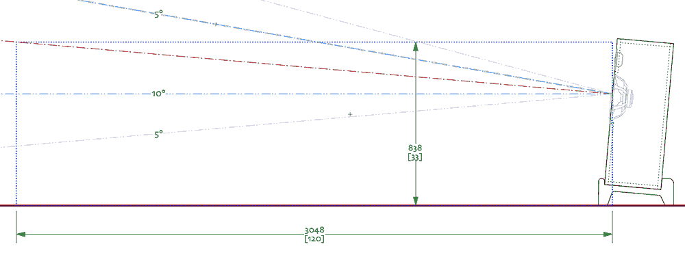

It seems strange that he would even consider compromising optimal driver height and cabinet dimensions for elusive hand wavy wiffle-waffle about WAF.
People who are ready to drop 85k for a pair of speakers are we beyond superficial and misunderstood considerations like that.
If you drop the height down to the floor, without the stands, add a slight block under the front for focus perhaps 36" @ 7', you could have 1 to 1.618 ratios on the original Raven.
but people like narrower speakers.
And maybe it is more of a mltl being so pipe like, picking up a bit of resonance to fill in baffle step.............
