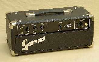

How do effects such as the Garnet Herzog get away with this - single ended output transformer with a loaded secondary which feeds the input stage of another guitar amp.
You generalize and speak inplural as if they were the norm or at least there were many in constant use.
Thuth is that it's only one, which was used in just one famous song .... many years ago (American Woman) .
And what you are talking about is not "a pedal" , even less "a preamp" , but a small head, a Champ style amplifier to be more precise,
with the speaker replaced by a resistor and some of that output used to overdrive another tube amplifier.
Fine, may work well, but can't be considered "the norm" , even less worry that all other preamps and tube pedals are not built like it.
