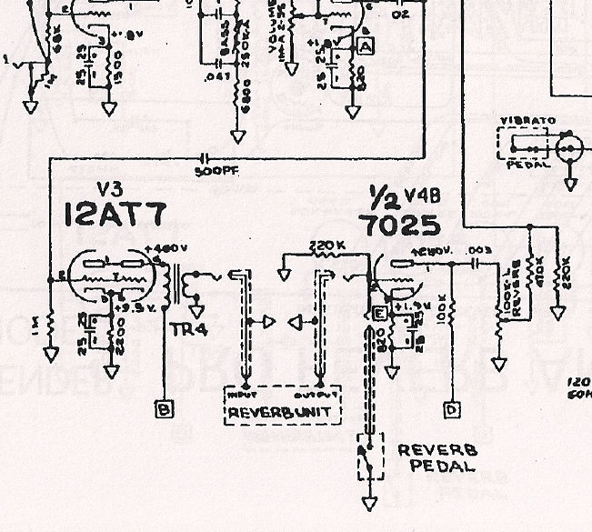

I'm trying to sort out why I'm not getting any reverb with a Fender Pro Reverb, circa 1971. The unit has been recapped (not by me), and the workmanship, component values, etc. look ok. Apparently, there was no reverb before the recap too. All of the tubes test ok, and the reverb transformer measures ok in terms of DC resistance: 800 ohms across the primaries, about 1 ohm across the secondaries. One thing that I'm suspicious of is the amplitude of a 1kHz signal before after the 500pF capacitor on the way to the reverb driver tube grid. My understanding was that combination of this cap and the 1 meg resistor will cut everything below 318Hz, and yet I'm seeing significant attenuation of a 1kHz as well as 2kHz signal. The resistor measures within 5 percent of spec, and I replaced the cap with no change.
The plate voltage of the 12AT7 driver is 434V, and cathode is 8.77V.
