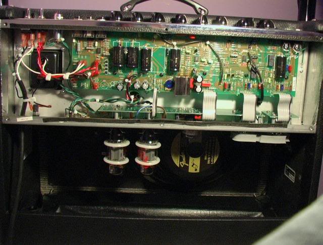

The back panel is off noise still present. To my ear it sounds like the baffle. I never thought of a void but the owner said it has never done it until recently.

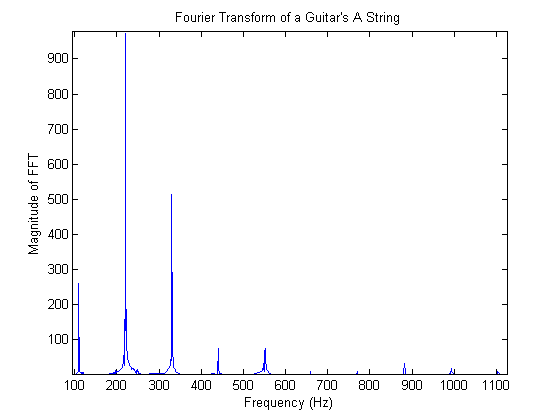

Since eyeballs are useless for this task, let's take a look at an actual measurement or two. Firstly, recall that a guitar in standard tuning has its open low "A" (5th string) tuned to 110 Hz.
Now take a look at the first attached image, which shows the Fourier transform of a guitar's picked open "A" string.
Where is the tallest peak on the attached spectrum image? Not at 110 Hz. Instead, it's at 220 Hz!That's the 2nd harmonic, and not the fundamental.
And where is the second-tallest peak of the spectrum? At 330 Hz, i.e., the 3rd harmonic. Even the 3rd harmonic is often stronger than the fundamental frequency when it comes to guitars!

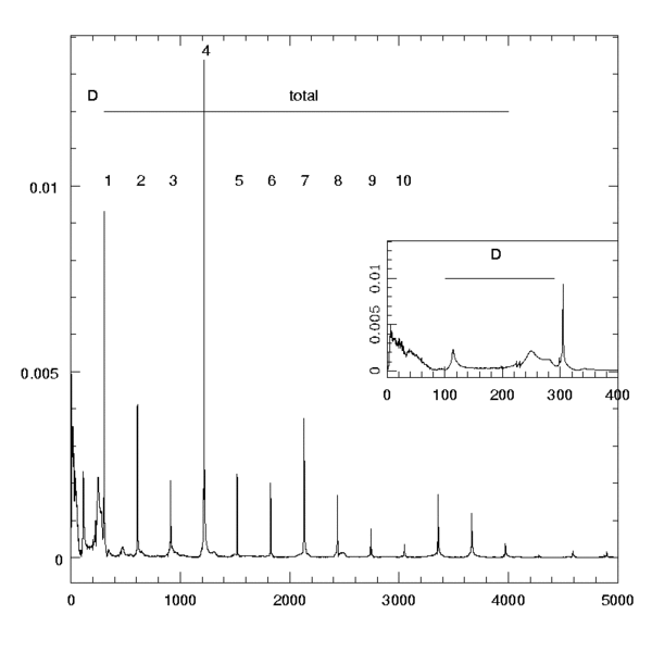

To demonstrate this point once again, take a look at the second image. This is a high "E" string, tuned to 329.63 Hz in standard tuning. Yet the tallest peak in the spectrum is a little higher than 1200 Hz - that's the fourth harmonic!
(String stiffness, air resistance, pickup magnet pull, all detune the high harmonics of guitar strings a little, which may be why this peak isn't exactly at the expected 1318.5 Hz.)

It is without a question the speaker making terrible noises. I got around to playing the amp through a Jensen Speaker it sounded good. I played one of my home brew amps through the HRD stock Eminence speaker and the speaker makes the noise. It sounds like it's coming from the voice coil, it's not the basket or the wire leads coming from the coil.
