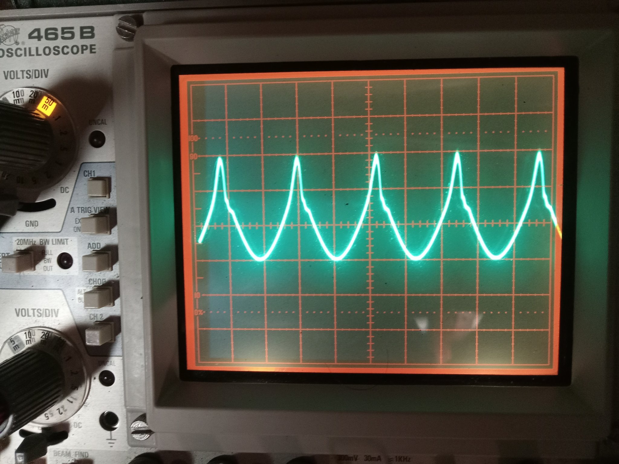

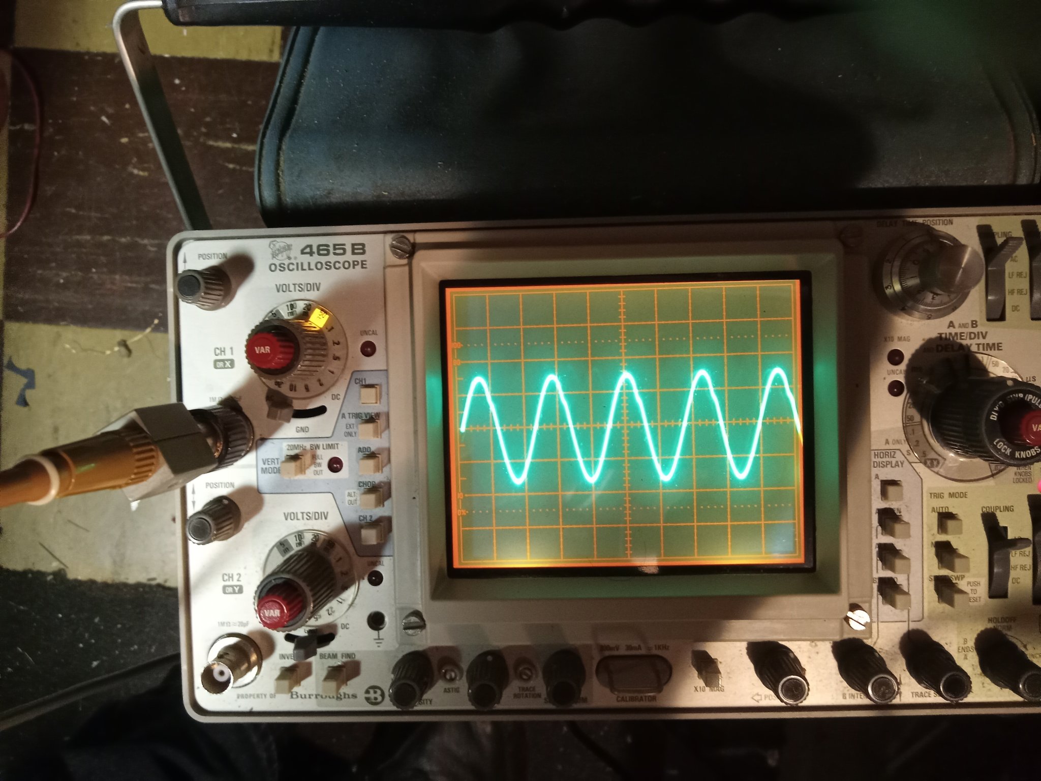

The amp I am working on now is distorted on the clean channel. I have a clean sine wave on the input to U6-B pin 5. The output on pin 7, has this ratty looking spike coming out of the sine wave. I have replaced U6 - same problem.
First picture is pin 5 input Second picture is pin 7 output.
The spike will enlarge as I turn up the volume.
So I know the problem is in the amplifier circuits, because the preamp is putting out a clean signal. I believe this has something to do with the negative feedback coming off the output of the amp, but I can't figure it out.

Hi Bob, I just fixed this exact problem. As the problem is with the positive half of the wave I suspected Q12 as "spunko" suggested above. I had TIP34C on hand which although rated for much more current than will ever pass there, are compatible in terms of voltage, gain and polarity. Replacing the 2SA1013 with TIP34C solved the problem completely, the wave is clean and symmetrical now. Before this, I tried using MPSA92 which also worked, but they are only rated for 500mA and would get rather too hot in this circuit. The original transistor passed every test on my meter, figure it out! Hope this helps 😉
