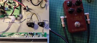

OK here is what I got
I added two switching quarter inch sockets. The right one can be used to get the signal from the DSP, and the left one to feed the signal to the power stage. Of course you can use them separately as you want. And with nothing connected, the thing defaults to feeding the DSP to the amp.
So this works like an unbuffered simple FX loop. Keep in mind that both the DSP and the power amp are connected to the ground, so you might have to fix ground loops. I only tried this with a battery powered pedal.
The main culprit for the hiss unfortunately is the DSP pcb. I do not know if it comes from the PSU or from the design itself, or from the buffer stages (yet). There is still some noise on the power stage, but it's significantly lower, and for me it was lower than the noise from my guitars.
Testing the power amp with my mojomojo in the middle like a buffered volume, I was surprised how much better the speaker was behaving. It was now ringing loudly and with much authority. Which further points that the output stages of the DSP are also probably weak.
And of course, the volume is now much more manageable for home-use.
I do not know how I will proceed. I will play a bit more with it using my preamp pedals and see how it goes. It was already working nicely as a plain cab (for example with my VOX pathfinder 10). But it's power amp is powerful and behaves nicely even at low volumes. At this point I think that its best bet is to work like a powered cab for pedals.

This looks really interesting. If I understand these Neutrik connector functions... the one on the LEFT can now serve as "AMP-IN", so you could use any LINE-OUT from third sources to just amplify the signal, like a PA system. (I will not bother you with ideas and suggestions, while your are studying this.)
What has to be done is pretty straight-forward - thanx for this lesson! I still have to study the "ground loop problem", and then get more Neutrik switchable connectors. I will then experiment with a BOSS GE-7 equalizer to eliminate some of that hiss (this EQ has a buffer). The Fender Champion40 has a great sound for the Tweed Deluxe and the '65 Deluxe voicing settings.
In the meantime, the picture below is of a double 1/4 socket speaker mod, with switchable Neutriks. This enables the combo to be used as a HEAD, with an AMP-OUT to an external speaker, and also to be used as a speaker CABINET. (Since I do not yet have the proper 1mm wire to connect both Neutriks, I use the short audio cable, to connect the speaker with the amp temporarily).
And when I finalize your amp mod, there will be 4 Neutriks, which means huge versatility for this amp. Education & fun for the whole family. 😀
